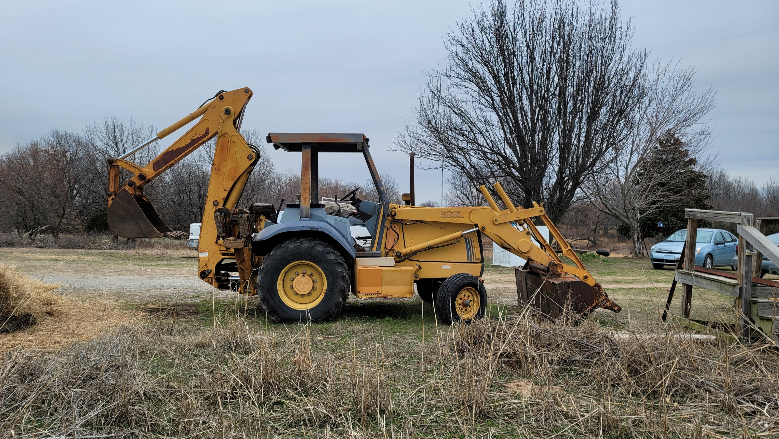

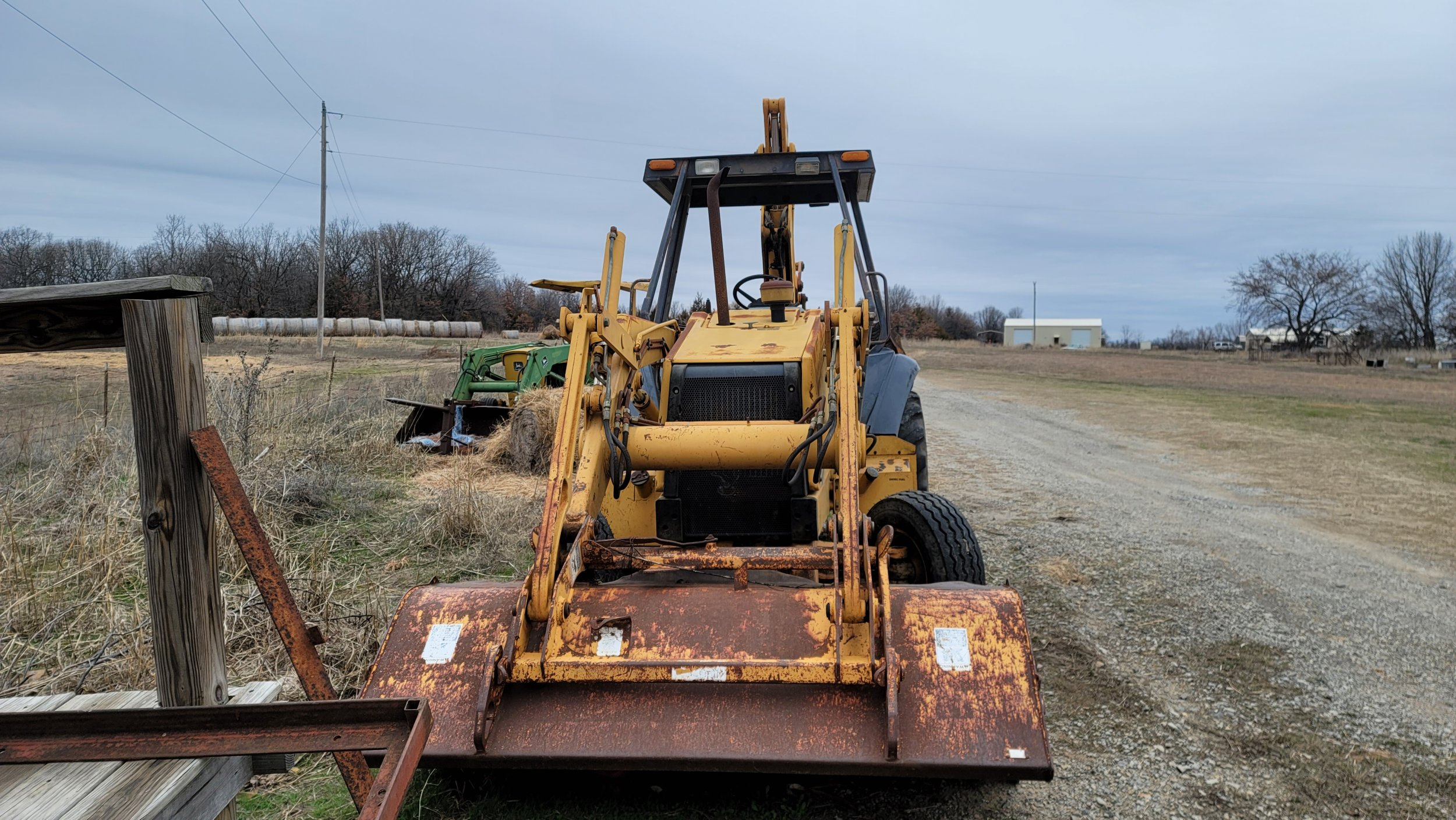

WxMan 85 sounds like you've made great progress with older iron so far - nice work!
How about some pictures of your new to you 580L?
   / Deciding what to buy for my 1ST tractor.
#39
Luckily I have, and here you go! These are pics from the day I went over to pay for her. Sorry for the delayed response, we were pretty sick, and just getting around to feeling human.

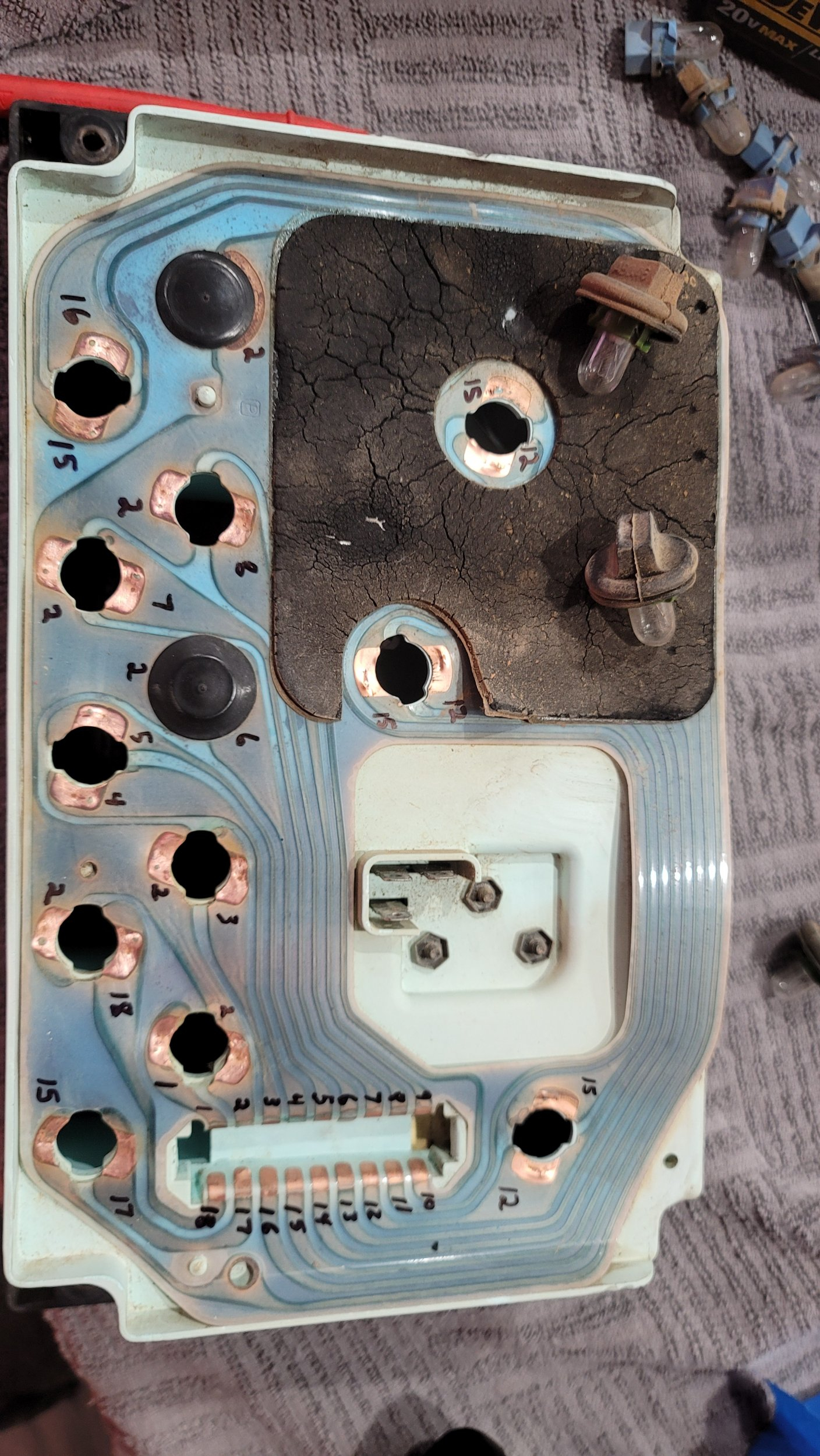

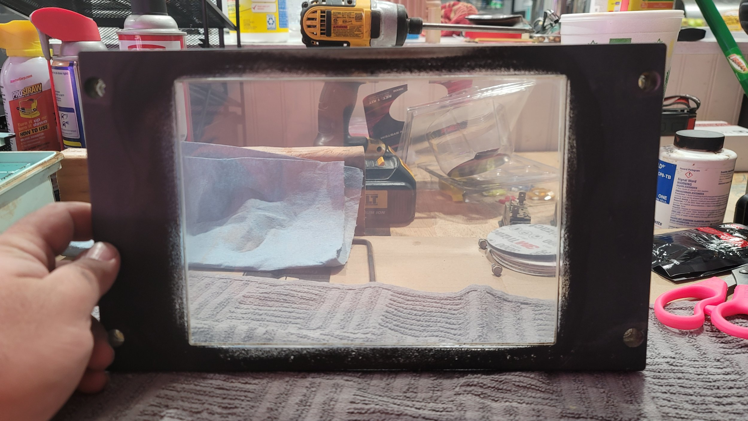

I have done almost a total wire connection assessment and clean up adding dielectric grease to almost every connection. (Atleast the ones I've touched or removed) I'm still trouble shooting the brake engaged light, but feel I have narrowed that gremlin down to the switch at the rear end..... time will tell. Here is some pics during my clean up / troubleshooting days in the beginning. Sanded and clean every connection on the instrument panel and in the fuse/relay boxes. You could not read the guages at all before I buffed it with headlight repair buffing kit. Yesterday I received my original factory service manual and searchable usb device in the mail! So I have that on my side now for any issues on the 580L!!
