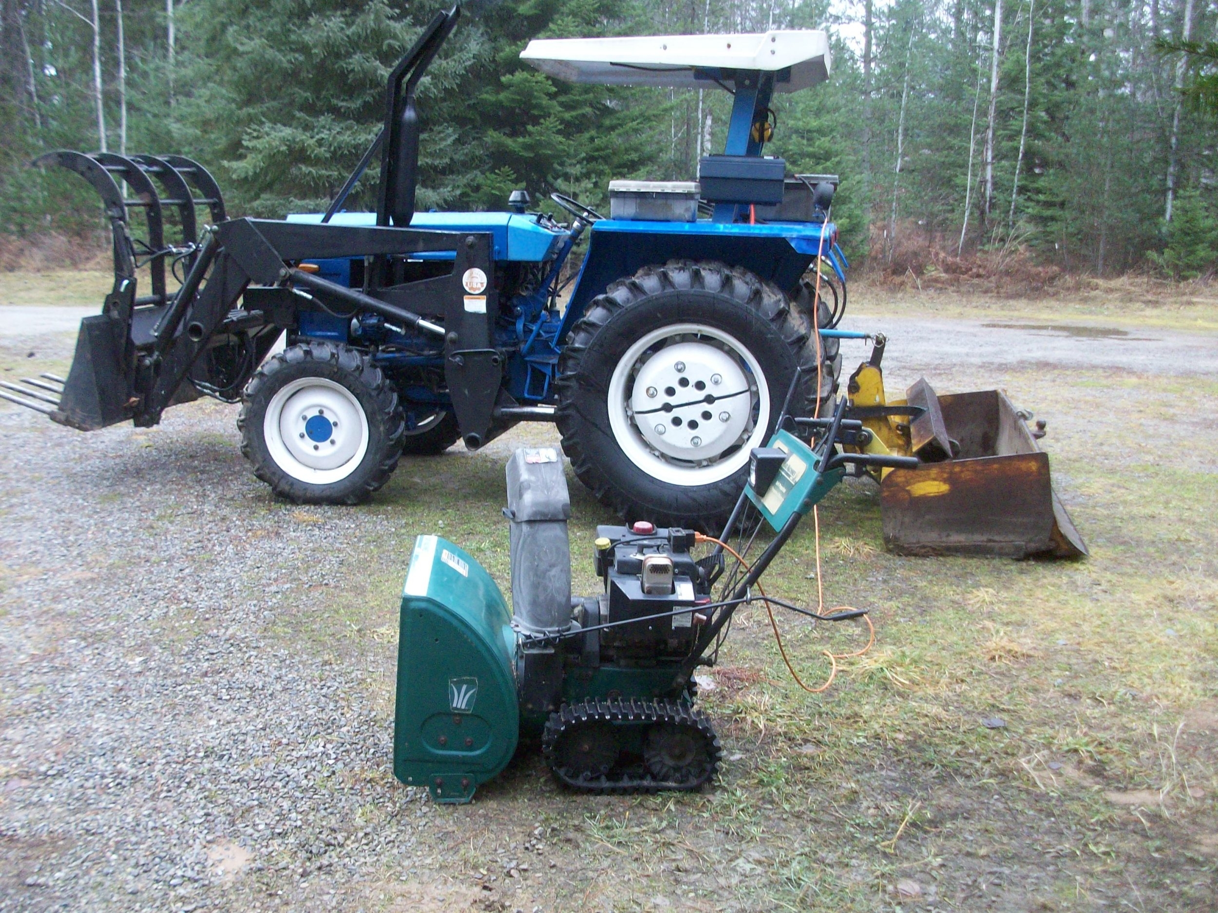

I did exactly that a 2000 watt HF years ago. tractor has 2 850 CCA 12 volts in parallel.
Runs a Pole saw fine and here is a pic of it starting the 10 HP track drive snowblower with no problem.
I did put a power shut off switch in line with the low volt high current B+ supply line.

I respectfully disagree the one shone in my post has run skil saws pole saws.
a coffee maker while keeping the satellite dish and big screen TV on with some lights while the house power was out , and as posted it easily started a 10 hp snow king Techumseh snow blower engine in the picture

Geeze! It did a great job! I can't see a snowflake anywhere!
