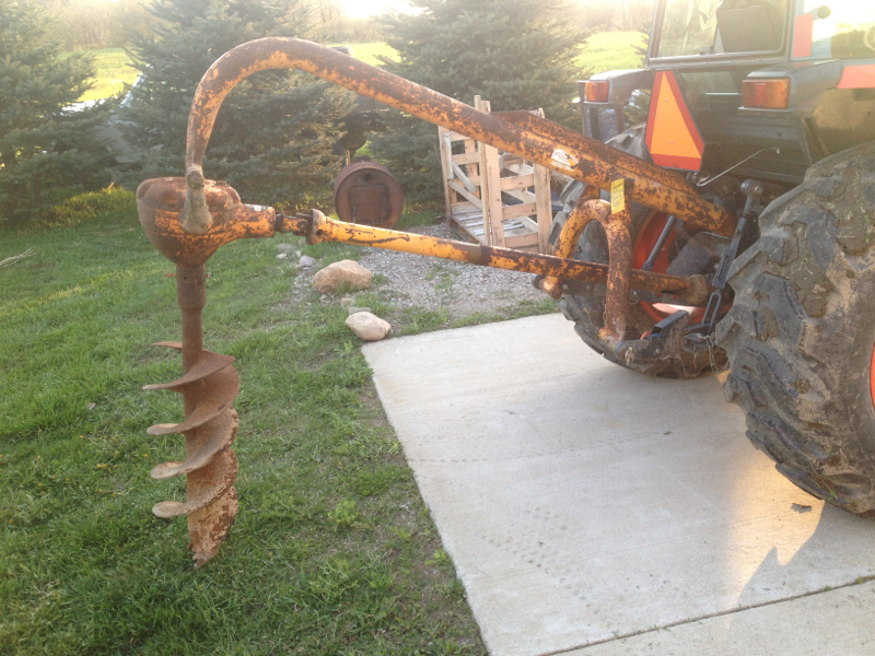

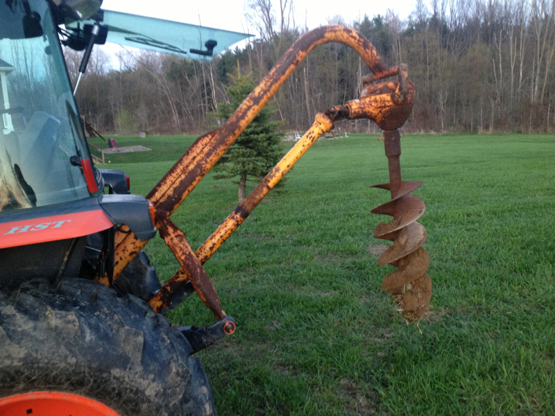

Well, it was just a trial run, but it works well.
It needs a slip pin for the PTO shaft.
It's hard to tell
but it has plenty of room. No dragging of the tip
Sanded her down and gave a quick touch of orange paint. After her second coat I'll post a photo.

It'll drag when you go thru a depression...but no worries...just don't back up without thinking about it.
Without thinking? You know as well as I do. I will get side tracked and forget.
My two concerns are loading / unloading from the trailer, and dragging it across someone's concrete.
I wonder if the auger can be folded / pivoted up toward the boom and strapped?
   / Danuser F8 Post hole Digger on L3540 #38
of course...carry short chain to chain it up. I've done it.
