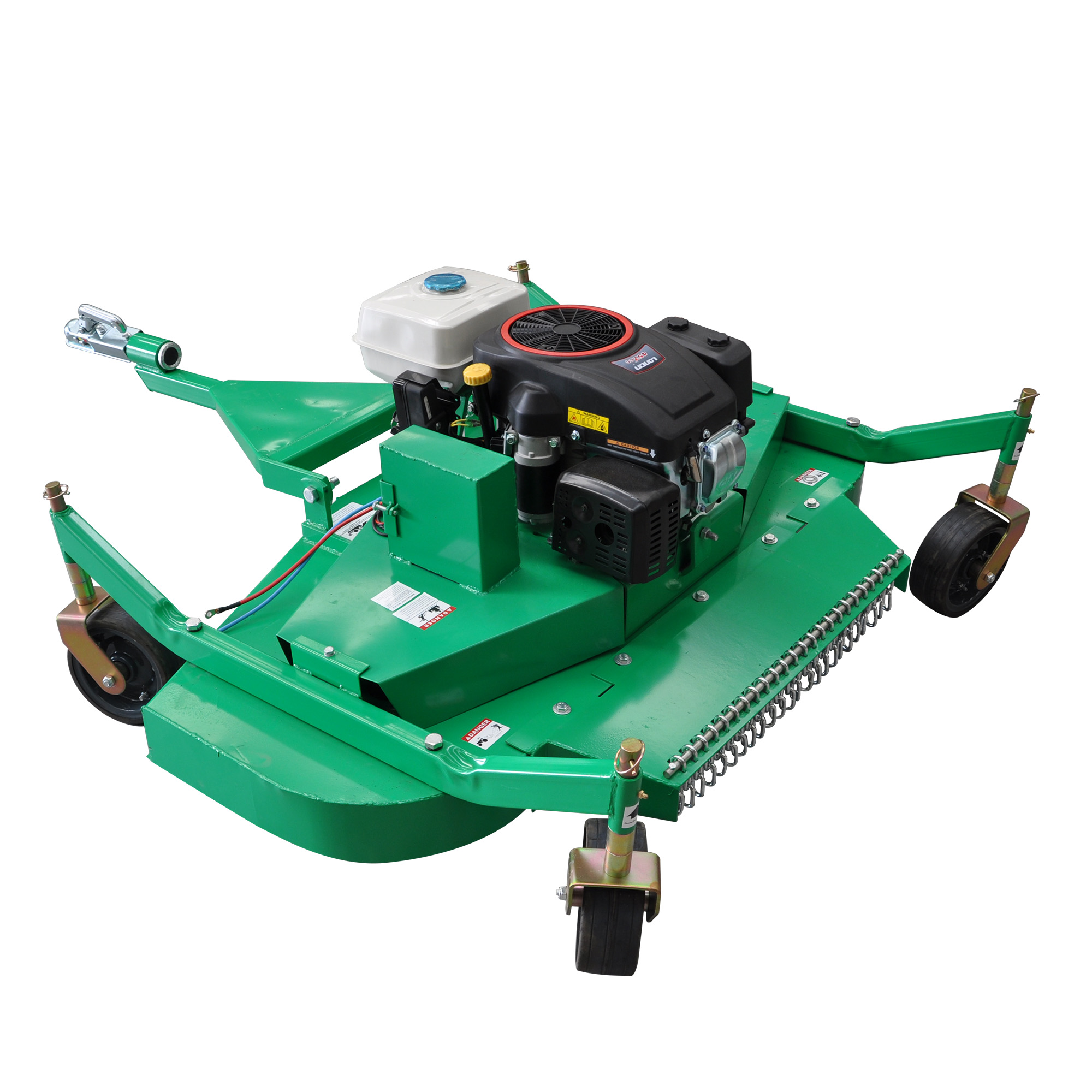

I bought a tow behind ATV mower to pull behind my Honda TRX300 quad.
The mower sits on 4 caster wheels with a draw bar to the quad and a 15HP engine sitting on top of the mower driving three blades through a belt.
The problem is that on flat ground when going around corners the mower will swing outwards rather than follow my quad.
It get's worse on uneven ground. Even riding down the road, if the road has a crown and is not perfectly flat the mower will head toward the side of the road (downhill from the crown in the middle of the road).
When taken off road onto sloping ground it get's positively dangerous.
While testing it today riding slowly down a slope the mower tried to overtake me going down the hill. It only stopped when it jack knifed against the quad tyre.
Surely these mowers can be used on sloping ground.
Has anyone encountered this problem and solved it ?

I am assuming it is brand new(photo), so take it back as this design failure make the machine unfit for purpose. This is an accident waiting to happen. The atv mowers I have seen all had fixed rear wheels and castor on the front and corned like a standard car trailer.
If you want to keep the mower then set the rear wheels straight and drill a hole through the shaft and bolt it up.

Wrong hitch. Should be receiver type with 4 casters. Or, the 2 check chains are missing. My Woods came with check chains. The weight of this unit behind an ATV with a fixed hitch will be just as exciting.

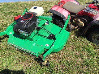

I can't easily return it because I've already started welding extra steel onto it (in order to try to stop the wheels turning), so I'd be in for a fight with the retailer. I've also swapped over the tyres to pneumatic from the solid tyres it came with. I will ask them if they'll take it back, but the next best option is $1000 more expensive, so I'm probably better off just making it work.
I like the idea of check chains. I'll try that today.

I would weld a piece of angle iron to the top of the rear caster "arch" and bolt that to the side of the frame that the wheel rides on. That way the rear wheels cannot pivot and stay "facing forward"
Failing that, I would unbolt the front hitch and make a new hitch that uses the same tabs and connects to the quad in two places.

I suspect what has happened in China is they have taken a mower intended to hang off a three point linkage and simply put a drawbar on front. The rigidity of 3PL has gone and so has any semblance of control.
For what it's worth, here's a couple of video. The first shows how it behaves as standard and part way through I insert some pins to limit the rear wheel steering.
In the second video I've welded up the rear wheels so they're solid.
ATV mower - YouTube
Testing ATV mower with non-steering rear wheels - YouTube
As you can see, my mod to stop the rear wheels pivoting has made it perform ok on level ground.
Tomorrow I'm going to try it on the sloping property that I bought it for.

Mower was $NZ2500.
I've welded up the mower's rear caster wheels so they don't pivot.
Works better now.
