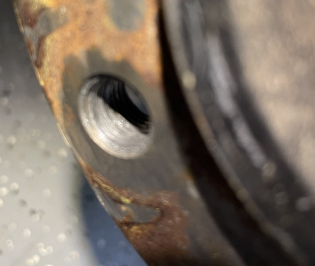

From what I see in this picture you don't have any material left to do anything with that size tap.
Due to the angle of the photo one cannot see the thickness remaining. Second is a heli-coil doesn’t remove much more than the thread depth when drilling. Third heli-coils are stronger than original because it is slightly larger and the coil is applying side pressure due to the angle. It is also smoother and usually better material than the original. Volkswagen had stainless thread inserts in their cylinder heads same as a heli-coil from the factory back in the 50s or maybe even further. Threads that are frequently disassembled especially in soft metal are better to have inserts. Some vehicles like Mercedes supply a guide stud in the tool kit, I have a couple in my toolbox. Might not be a bad Idea to make one. I have made several for installing transmissions and differentials.

Yea, there is no damage to your tap, I guess you didn't look closely at it before you started. I have included a link, to show other brand new ones, that look the same. They are to help start
the reason it stopped, is your drill is simply not geared low enough to do the cutting, it started easy till it started to cut the threads again, then it bound up.
as a new person to taps, you should do it by hand, drilling is a tricky way to go, and if you mess up your done.
to the contradictory I think the angle is perfect to see there is no thread left. i agree with everything else you said … as long as one lock tight the heli-coil properly.

Yes to see the threads but not the remaining thickness of the part. Had the picture been taken from the opposite angle it would show both or two different photos, the description told us about the threads.

Just curious.....as it wasnt said or shown in the pics....but what size is the tap?
And that tap is indeed fine BTW. And as long as its the correct size will work fine for the repair. But I would never trust someone else sizing a tap for me, especially a discount auto-parts store employee. I'll take my own measurements.
