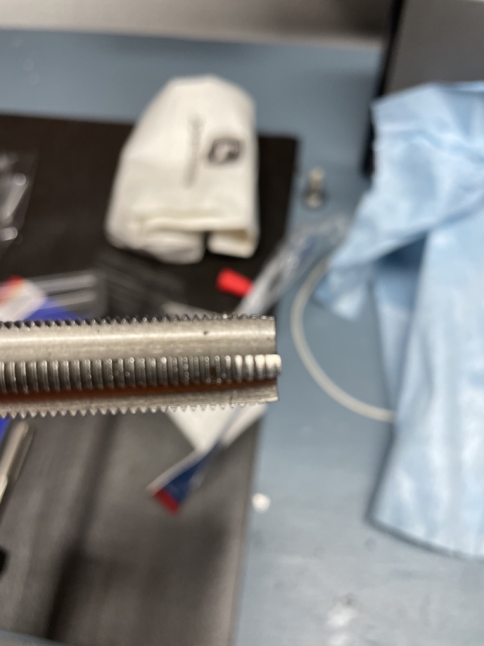

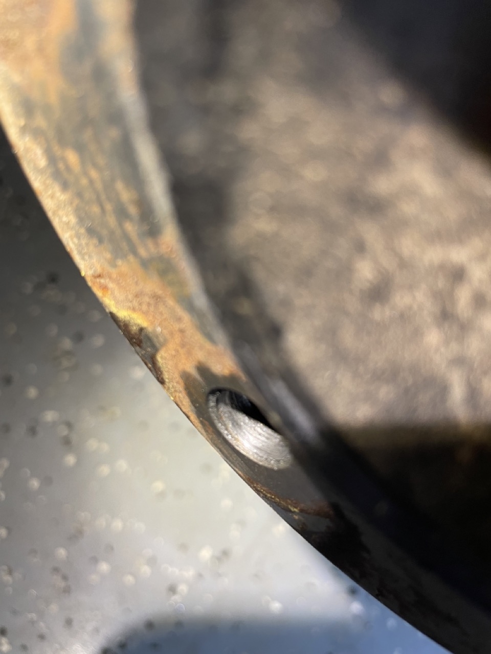

After a mishap I have several sets of damaged threads to contend with. Talked with the folks at NAPA and purchased a rethread/thread chaser tool. I added some cutting oil, made sure I went in straights and set my drill to a slow speed. It seemed to initially work ok for a few turns but quickly stopped turning and when I removed it the tool was worn beyond use.
I think the threads are just gone/damaged - meaning I will have to cut new ones. Before I head of in another direction, thought I'd ask for advice here; I've never performed this type of repair before. I did procur some longer bolts w/nuts to get the wheel back on, but I'd prefer to use threaded bolts.
I have attached a few pictures of the threads and one of the tool I bought...

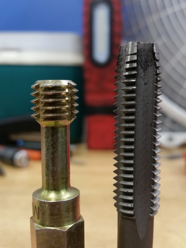

Water over the dam at this point, and it could just be the picture, but it looks like auto parts store might have sold you a tap, not a thread chaser. Chasers have very limited taper lead. Concept with a chaser is to pick up the existing thread vs cutting new one. Chaser on left, tap on right.
There are different styles of thread insert repairs. In addition to Heli-coils there are Timeserts and others. Might want to check them out. I’ve buggered up a few Heli -coil inserts during installation.

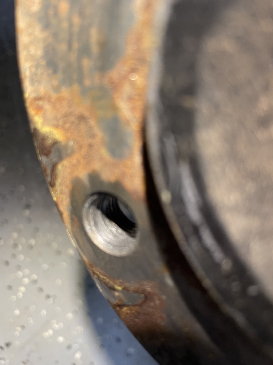

Possibly silly question but is the tap or thread chaser the correct size? Reason for asking is there appears to be some threads left in the hub so correct tap should want to follow and clean thise threads. Any room to try starting tap from back side?

What is pictured as your "thread chasing tool" is indeed a tap. It's okay to use for this, if you are very careful. As said. by hand only! Two thirds a turn in, one third a turn out (so it cuts back the building chips of the four flute tap), all the way in until it spins in freely. Lots of lubrication. The tap must be square to the hole. If not, it'll try to cut a new thread off axis.

From what I see in this picture you don't have any material left to do anything with that size tap.
/ Damaged Threads - 1025R Rear Axle
#20
So I have sucessfully repaired two of the three sets of damaged threads. On the one, I installed a slightly smaller diameter bolt and secured with a lock washer and nut. Everything to torqued to spec. Thank you to everyone for your help and insights. This forum is invaluable.
