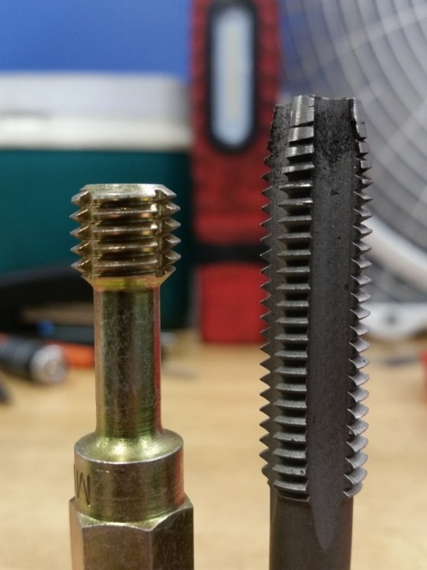

Water over the dam at this point, and it could just be the picture, but it looks like auto parts store might have sold you a tap, not a thread chaser. Chasers have very limited taper lead. Concept with a chaser is to pick up the existing thread vs cutting new one. Chaser on left, tap on right.
There are different styles of thread insert repairs. In addition to Heli-coils there are Timeserts and others. Might want to check them out. I’ve buggered up a few Heli -coil inserts during installation. View attachment 808928
Good luck.
I specifically asked... twice. And explained that I did not want to cut new threads. Sigh...

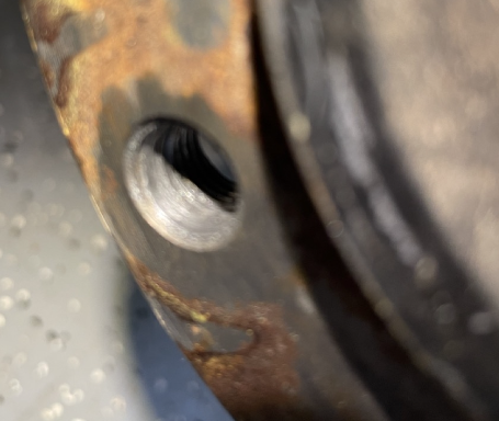

Possibly silly question but is the tap or thread chaser the correct size? Reason for asking is there appears to be some threads left in the hub so correct tap should want to follow and clean thise threads. Any room to try starting tap from back side?
I should be able to start from the back... with a chaser or the tap?

If you lay the bolt on the chaser do the threads match up? 99% certain the threads are metric.

What is pictured as your "thread chasing tool" is indeed a tap. It's okay to use for this, if you are very careful. As said. by hand only! Two thirds a turn in, one third a turn out (so it cuts back the building chips of the four flute tap), all the way in until it spins in freely. Lots of lubrication. The tap must be square to the hole. If not, it'll try to cut a new thread off axis.
If you're now past that repair, installing a helicoil is your next best option. You'll have to buy a heilcoil kit for that thread size, which will include a drill, a special tap, and some helicoils. In my opinion, for this application, installing a helicoil is machining work requiring precision and care. You will be cutting a new threaded hole, which must be on axis and square to the surface. I'm not saying that it can't be done on the tractor, but you get one chance to get it right. figure out a means to very precisely square the hole to the surface of the flange. The hole can be drilled by power (at a very slow speed), but still, the tapping must be at hand speed, in and out as described. Review helicoil installation instructions and videos. A very common process.

From what I see in this picture you don't have any material left to do anything with that size tap.

So I have sucessfully repaired two of the three sets of damaged threads. On the one, I installed a slightly smaller diameter bolt and secured with a lock washer and nut. Everything to torqued to spec. Thank you to everyone for your help and insights. This forum is invaluable.
