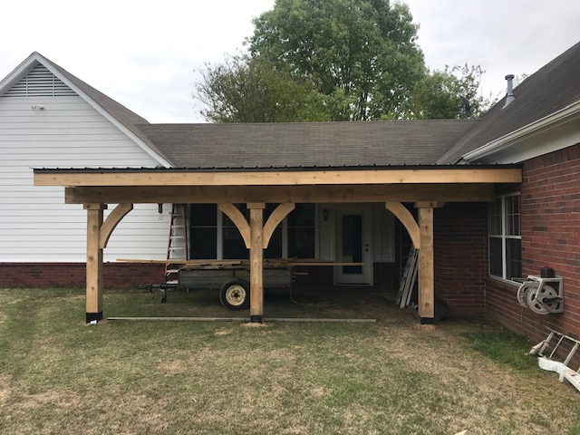

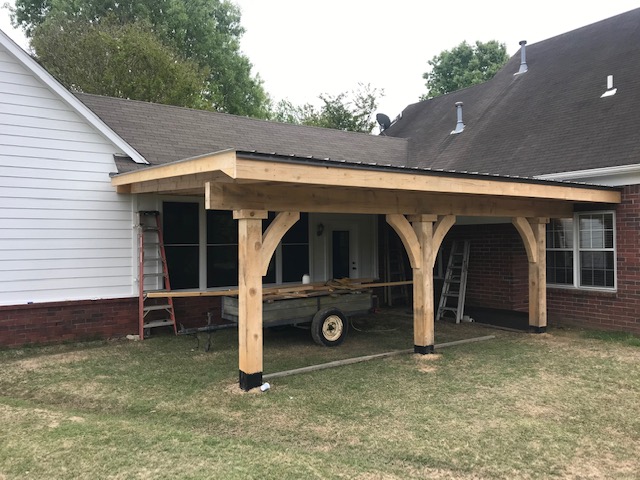

Looking for recommendations on staining a cypress patio cover I built.

Before the Covid hit, I would have recomended Sherwin Williams. I've been buying from them for 20 years and I've always considered them to be the best source of paint and stain. I'm not sure why they came up with this policy, but they are not allowing anybody in their store and they are not color matching, or making paint from their previous color matched cans. Kelly Moore is open and operating with limited people in the store and doing everything that you need a paint store to do. I sprayed a kitchen island with their paint and I'm amazed at how nice it is to work with. I have not bought their stain, and my only experience with their paint is their oil based paint, but that paint is so much nicer the Sherwin Williams, that I am going to buy a lot more paint from them, and if I need stain, that's where I'm going to go to see what they have. I might be splitting hairs here, and I've never had any issues with Sherwin Williams stain, so if they are close to you, and if they will sell it to you, then Sherwin Williams is still a good choice.
/ Cypress patio stain
Thanks Eddie I’ll check with Shermin William, I’ve got a good friend that has an account with them.
/ Cypress patio stain #4
will you be going w/solid or semi transparent stain? cypress has an attractive natural hue about it, but like any new wood, can be difficult to retain the original natural look.
most of my experience is with solid type by choice since it offers max uv protection, etc, but there are probably members here who have worked w/semi to retain grain, etc. Yes, there's always clear but don't have much experience with that. Personally, Thompson's water seal or related products are a joke & waste of time/money
agree with Eddie Walker, SW is the best around. enjoy the final stage of your good work
I would like to stay with semi transparent sense it shows the wood grain but I haven’t made up my mind yet.

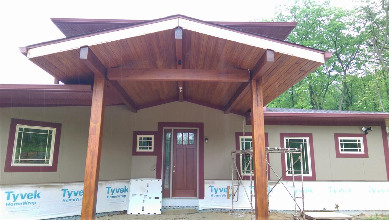

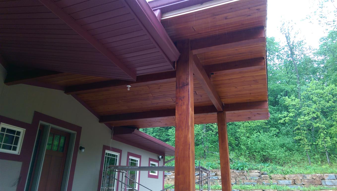

Sikkens Cetol Log stain is what i used on these. This is the Butternut color, which is a lot darker than the color swatch would lead you to believe...
