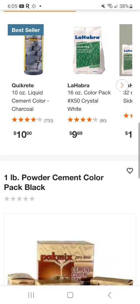

Is this existing concrete or a planned pour? If not poured, there is any one of dozens of powder products that can either be added to the mix or broadcast on the surface after bull floating, but before toweling or brooming. It's not terribly expensive.
