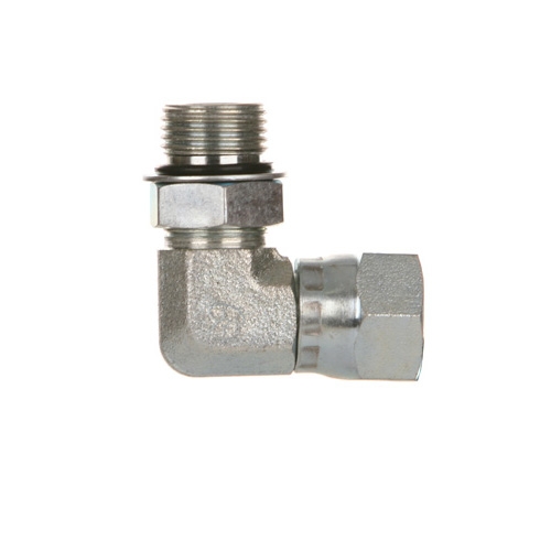

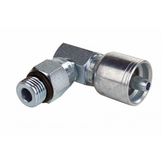

Does anyone know if they make a 90* orb to Jic fitting that swivels? The orb side has to swivel. I need a small pile of them. Parker makes the crimp on @ $20-$25 each. I'd REALLY like to avoid having special hoses made. The last time it cost me $75/hose. I need 8 for the loader.

Do you mean LIVE swivel (as in, swivels under pressure) or just "point it where you want it and lock it down?

Ahh swivel under pressure. What's the application?
The pic you showed does NOT swivel under pressure

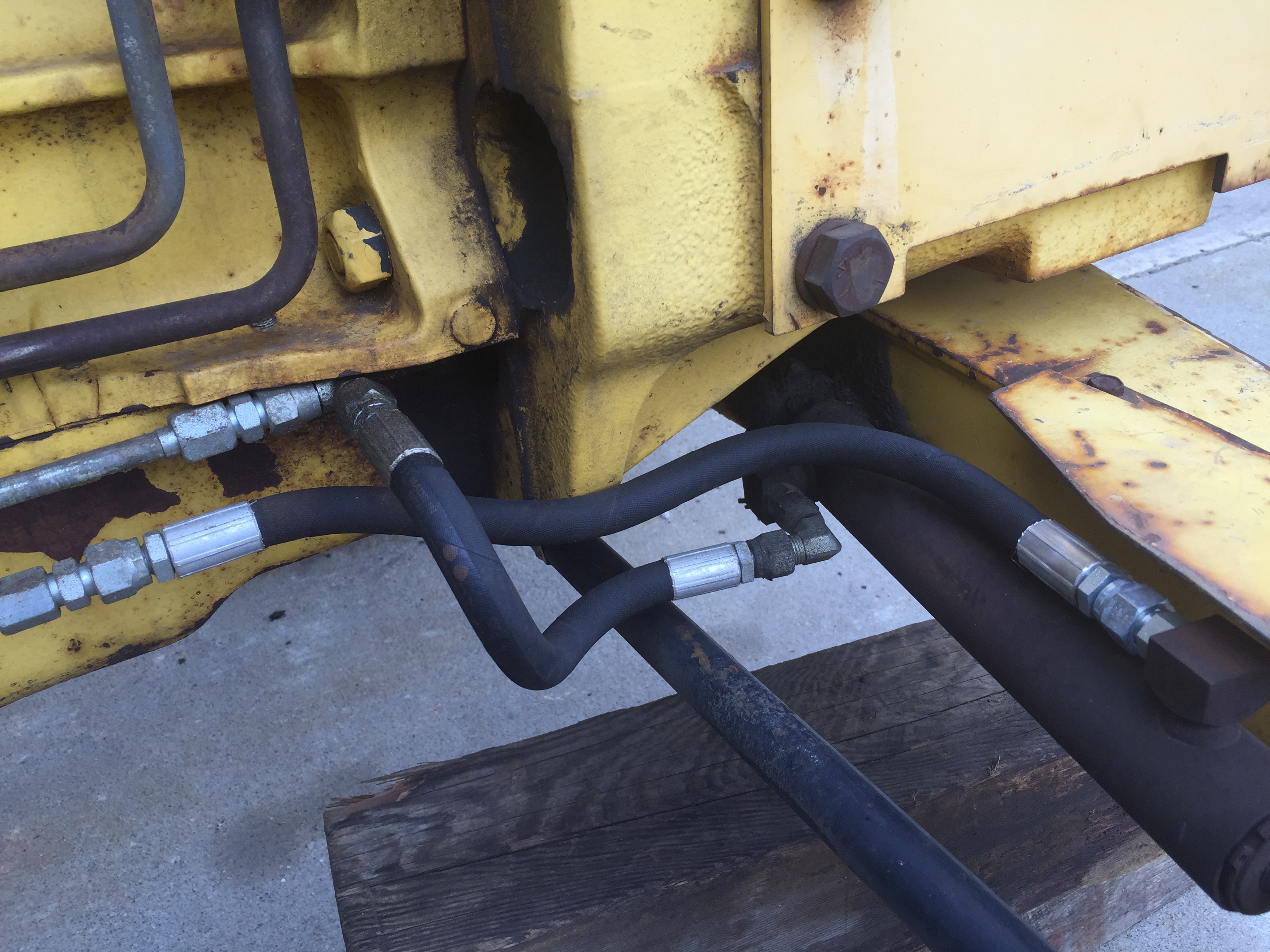

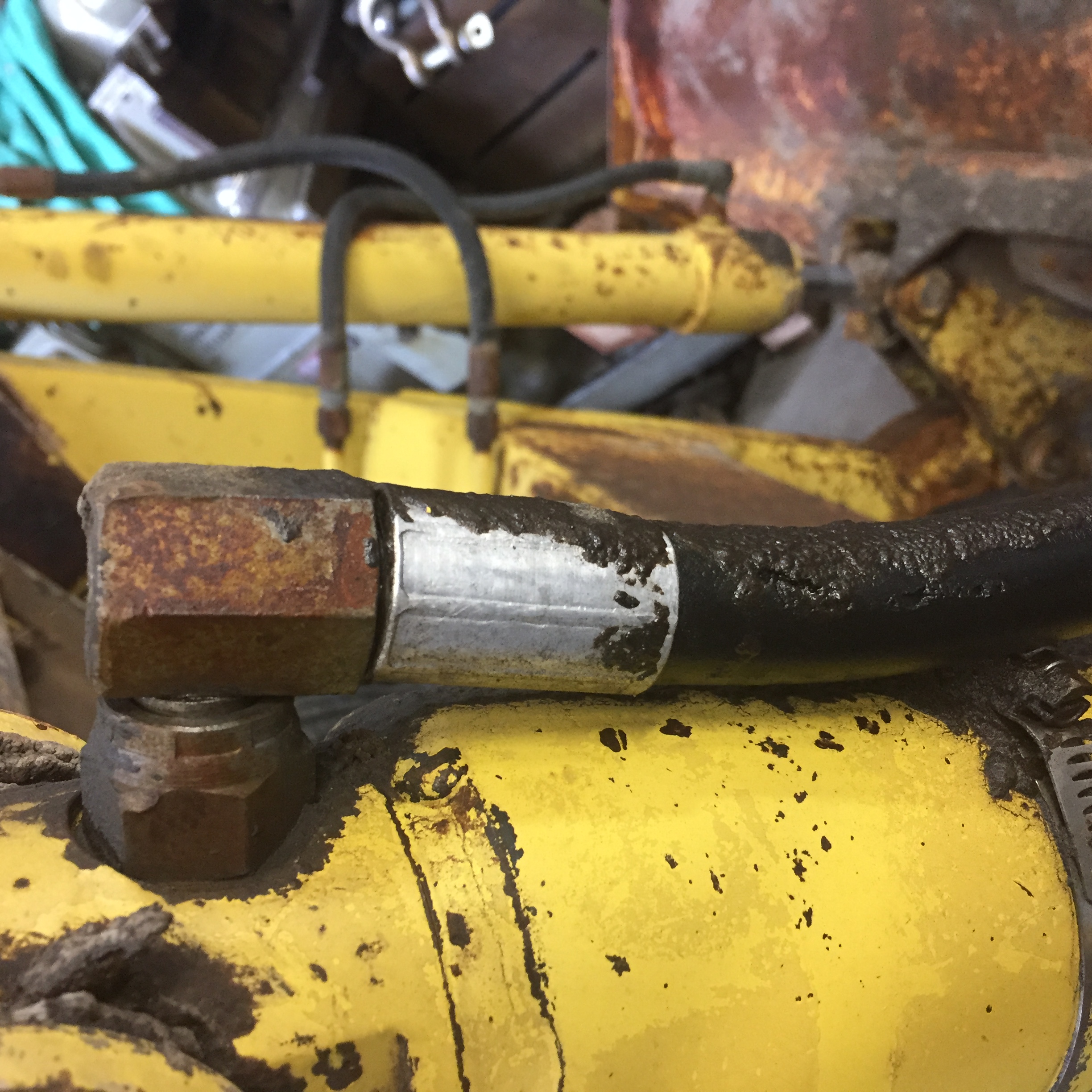

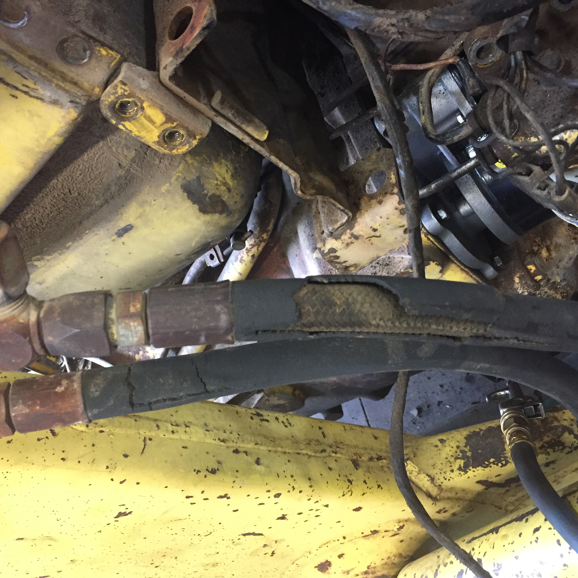

These are for a Ford 4500 tractor with the 740 loader. All the hoses have a 90* orb swivel under pressure fitting on the cyl. end and a jic male on the other. I need 8 hoses for the loader and 4 for the steering hoses on my New Holland 545D. I'm sick with the idea of spending $600+ on just the loader 8 hoses. They're in bad shape, the rubber is wore through and the steel wires are rusted.

Just did all the loader hoses on dad's 4500 last year.
No need for a live swivel. Just the 90 degree adapters like I linked first, then hoses with female JIC on each end
