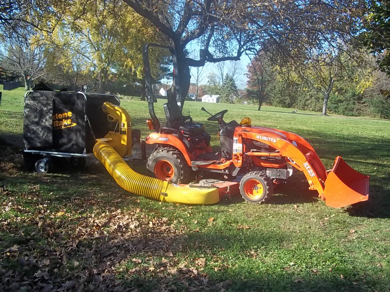

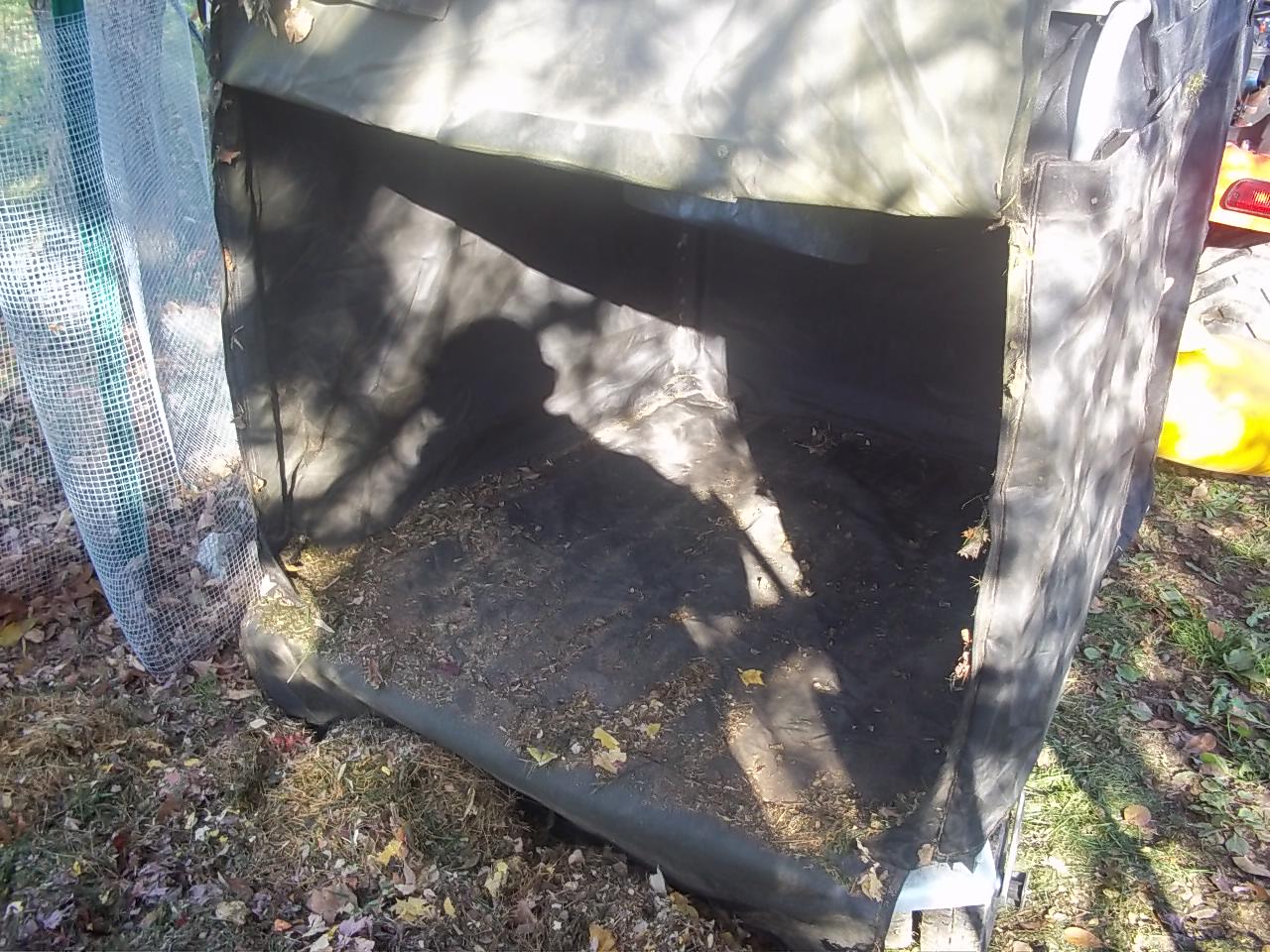

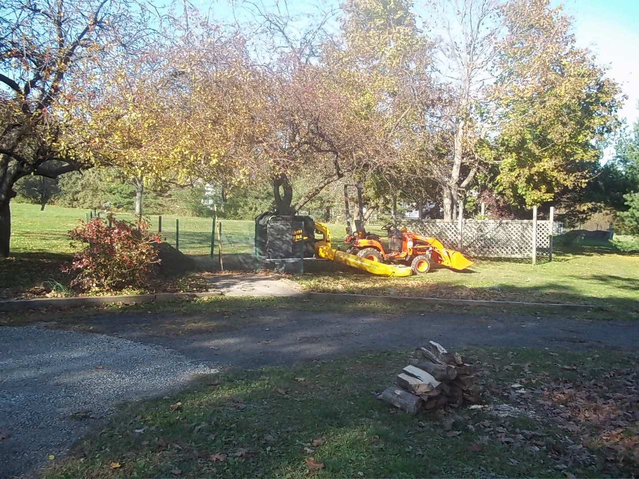

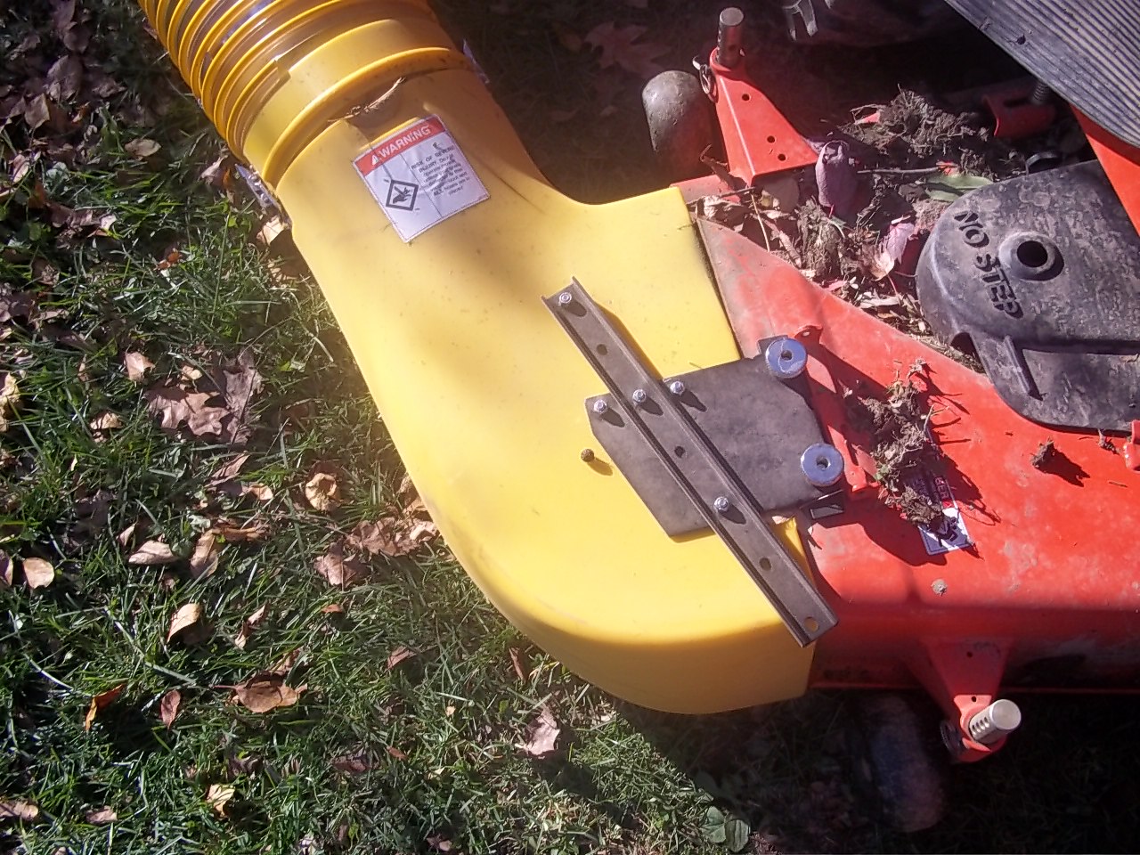

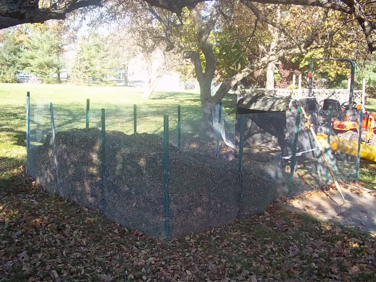

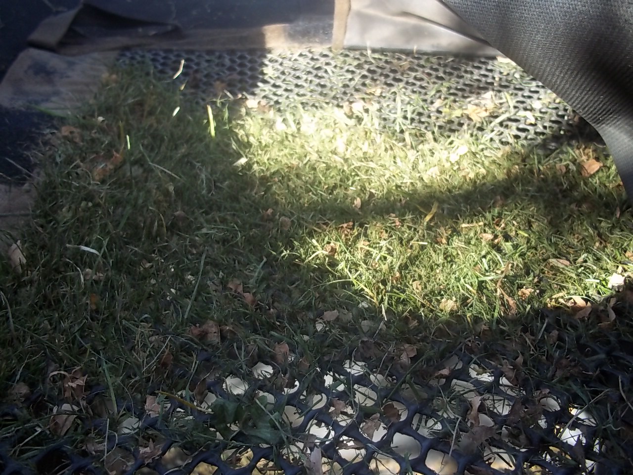

Well, have some pics of the Cyclone Rake:
The biggest problem I'm having now is the top screen keeps getting clogged with grass (I have the "grass screen" installed). It clogs after a few minutes of use. The bag them balloons and after a while the whole screen assembly will just blow off. Anybody have any advice?
On a side note, that thing sure kicks up a lot of dust.
We are getting all the kinks worked out, but I think this will be a worthwhile investment. We mowed today, and it did a great job of picking up all the leaves and clippings. We have plenty of compost material now! :D
All that said, so far I would give it 4 stars.

^^^The 6th pic shows the clogged screen^^^

Thanks for posting the pics and summary of your first major leaf pickup with the Z-10.
Q: Is the grass screen an accessory or a normal part of the collection bag?
From the looks of your pictures, the 3 pt. attachment also seems to put the Z-10 about a foot further back from the BX, with a longer collection hose from the boot. Did you look at the "regular" (non-3 pt attachment) or perhaps Cyclone Rake could send you one to try?
Good luck with your new unit. It's been a record year for leaf-dropping in the midwest.

Can't really help on that since mine only came with one screen and it never clogs very badly. It did, however, come with a stiff bristle brush to clean the screen and other parts. Did you get that with yours?

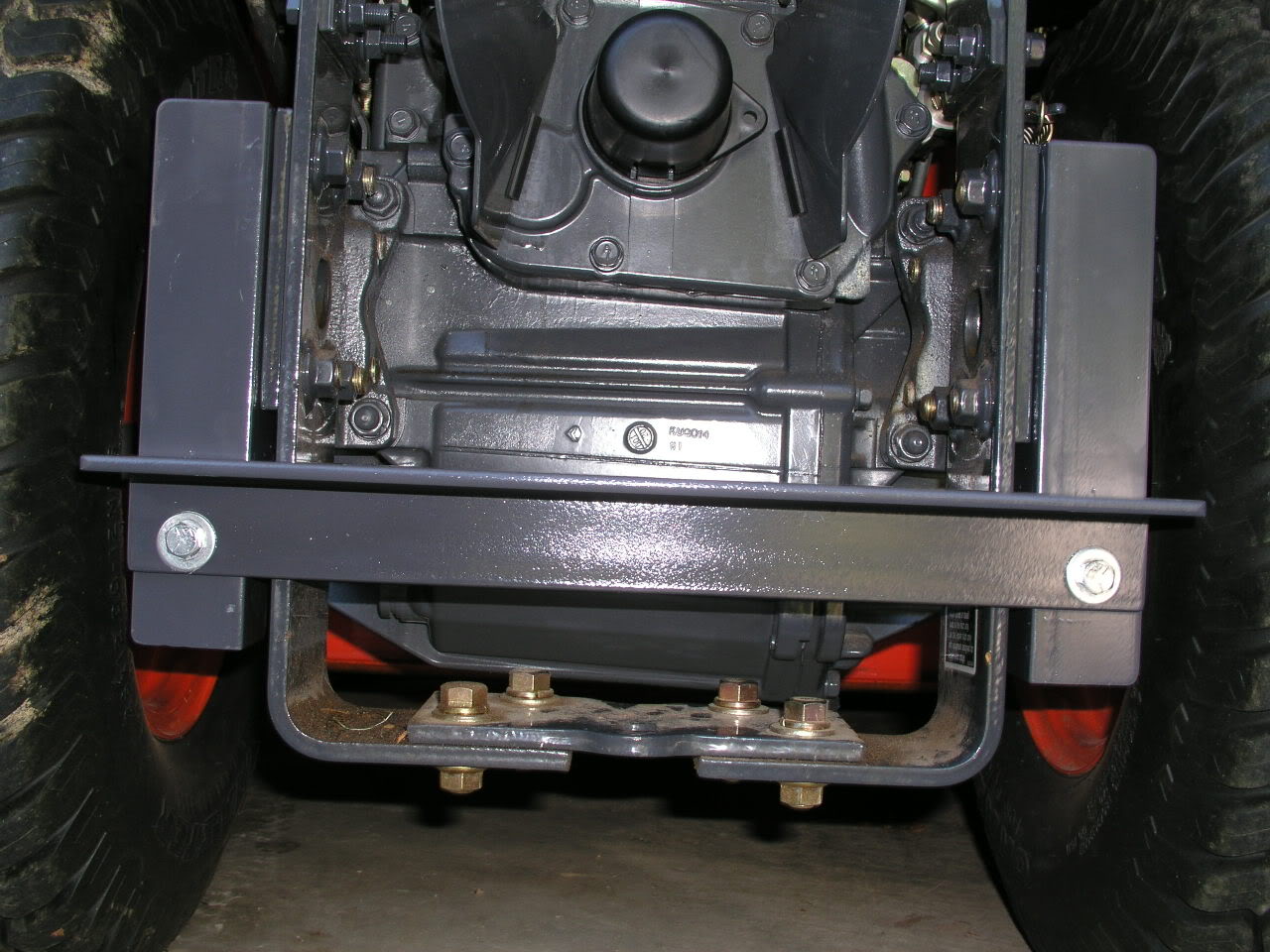

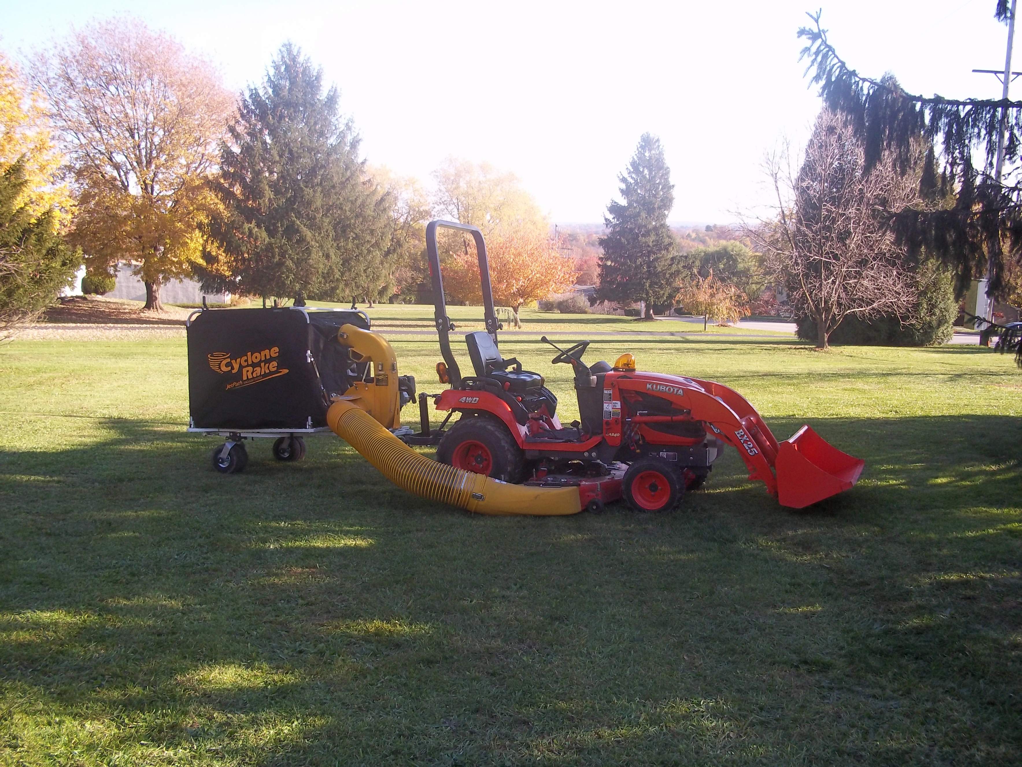

KennyR, I think CR only makes the 3PH hook up for the BX, or any 3PH equipped tractor. The CR needs to hook up to two fixed points so it can't be pinned to the frame-based drawbar. Having two hitch points is how they prevent it from jackknifing. I have seen some members here make up their own frame-based hitch, like this one, which does shorten the overall length of the tractor and bagger. Unfortunately, this design won't quite work on the backhoe models due to the BH subframe, but it could be modified to work I think.
