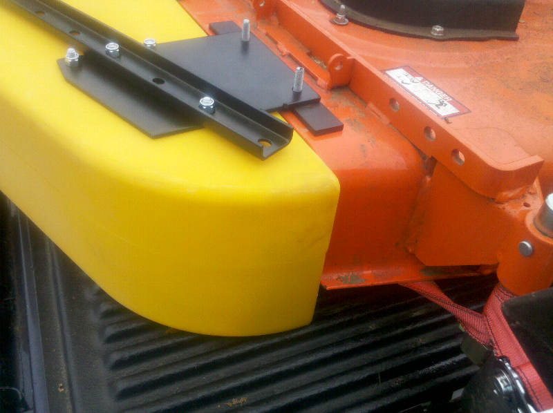

/ Cyclone Rake Z-10 On Order #25
Well, a little late, but here are a few pic's of the CR boot on my BX25. Looks like it's just about even with the bottom of the 54" MMM. I measured the tube opening on the boot and it's 8" even though my hose is the old 7" version. CR uses a reducer fitting that connects the hose to the boot. I assume with the 10" hose on the high end CR models, the boot has to be deeper by virtue of the 10" diameter hose connection.

Well, finally got the Cyclone Rake all assembled. Got a little time in today using it. Have a few observations:
#1. Power unloader hose seemed too small to fit over the chute that it attaches to. We were barely able to get it on and it's just on like an inch.
#2. Power unloader again, when you have a full load (especially of grass clippings) it takes a longgg time to unload. The vacuum hose also gets clogged a lot when unloading...
#3. Getting the vacuum hoses on the roof rack is big pain. They just want to coil up.
#4. This is more in the tractors part, but with the 3-pt drawbar you can't raise the mower without the CR going up with it.
#5. One of the attaching pieces inside one of the hoses came loose and fell off resulting in the Cyclone Rake "eating" it...:(
That said, it sure is nice to just drive around and pick up debris off the lawn. :thumbsup:
Oh, and the whole rig JUST fits in the garage (both length and width wise).
I'll post pics soon. ;)

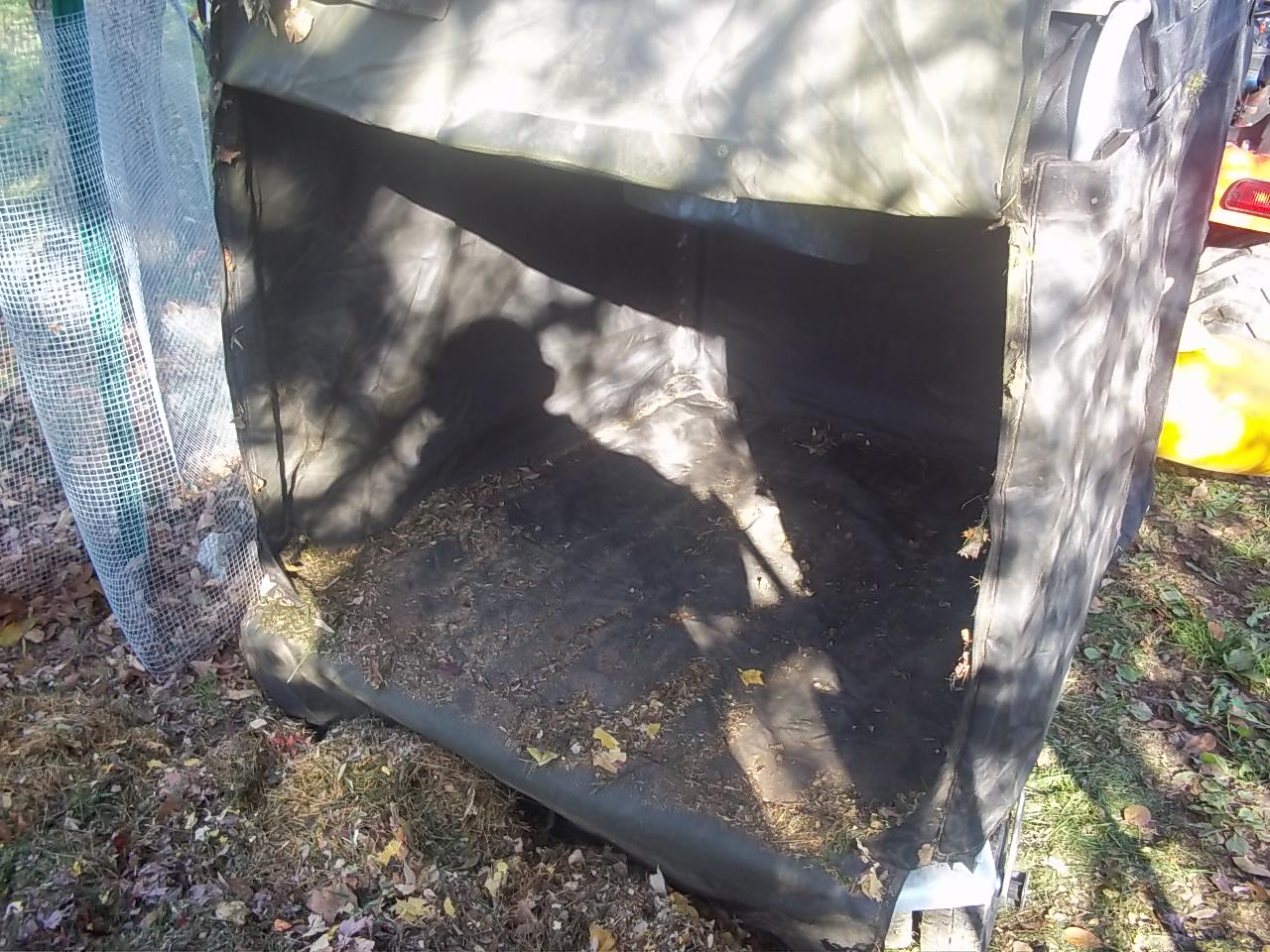

Well, have some pics of the Cyclone Rake:
The biggest problem I'm having now is the top screen keeps getting clogged with grass (I have the "grass screen" installed). It clogs after a few minutes of use. The bag them balloons and after a while the whole screen assembly will just blow off. Anybody have any advice?
On a side note, that thing sure kicks up a lot of dust.
We are getting all the kinks worked out, but I think this will be a worthwhile investment. We mowed today, and it did a great job of picking up all the leaves and clippings. We have plenty of compost material now! :D
All that said, so far I would give it 4 stars.

/ Cyclone Rake Z-10 On Order #34
Thanks for posting the pics and summary of your first major leaf pickup with the Z-10.
Q: Is the grass screen an accessory or a normal part of the collection bag?
From the looks of your pictures, the 3 pt. attachment also seems to put the Z-10 about a foot further back from the BX, with a longer collection hose from the boot. Did you look at the "regular" (non-3 pt attachment) or perhaps Cyclone Rake could send you one to try?
Good luck with your new unit. It's been a record year for leaf-dropping in the midwest.
Can't really help on that since mine only came with one screen and it never clogs very badly. It did, however, come with a stiff bristle brush to clean the screen and other parts. Did you get that with yours?
