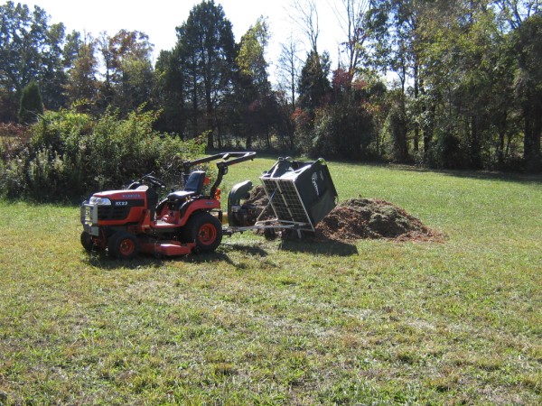

The Cyclone Rake is a good match to the BX. I'm on my 3rd season using the smallest model for both grass clippings and leaf pickup and it's worked well with my BX23 & 60" MMM.
Good idea on the modified hitch. I'm using the 3ph bracket for mine and I've added a hitchball to it to make it more useful. Hookup of the CR takes under 3 minutes and requires no tools.
