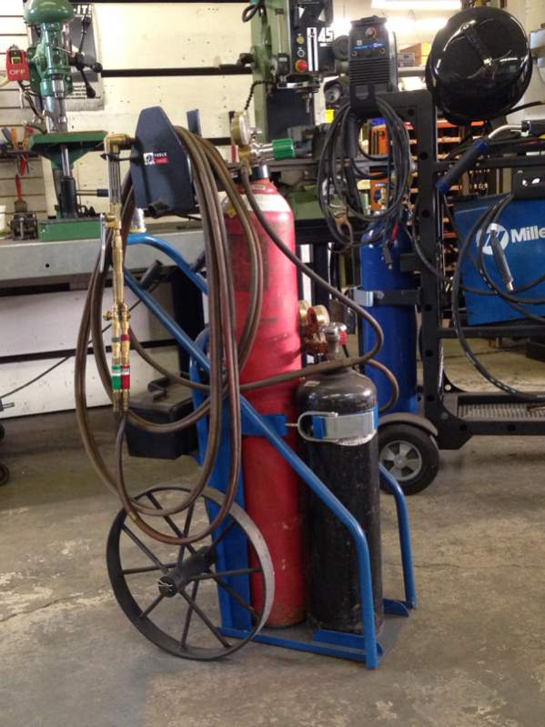

I would like to get a torch set up but the tanks are not so easy to get without paying all year for them!. I will still call around and hope I could get a good price I can live with.
   / Cutting torch #66
The lease on my 'mid sized' tanks are almost $200 a year. I researched different options available in my area but it got so confusing I gave up.
I think I was paying about $50 per annum back in 1967.
Terry
