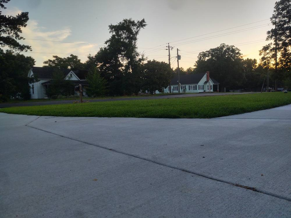

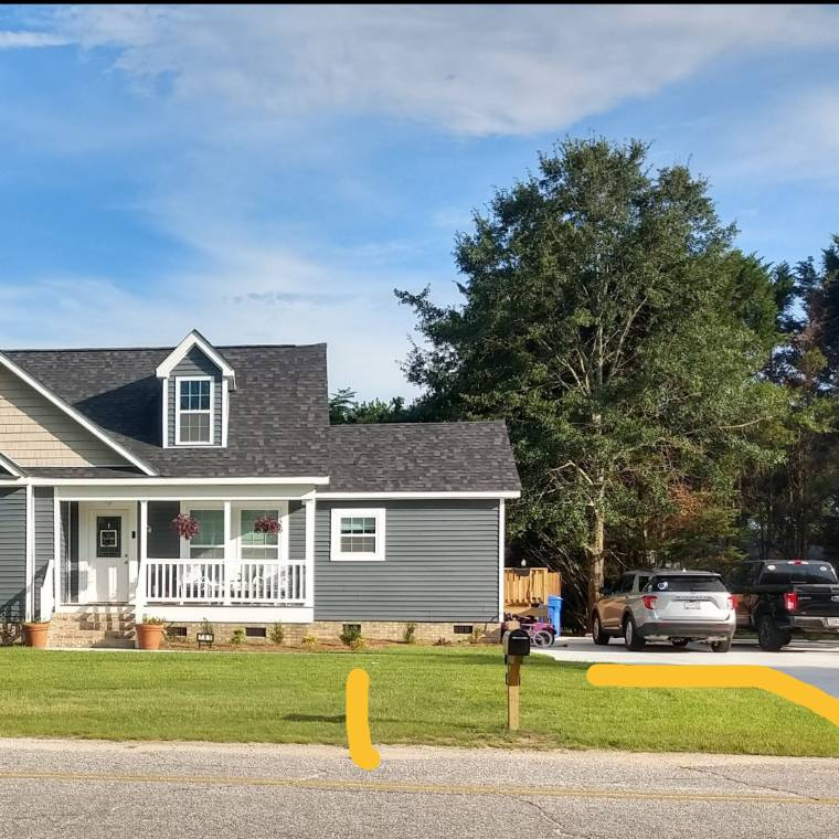

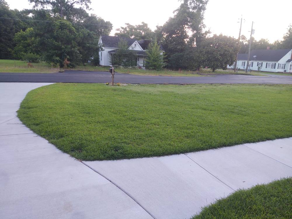

I have a section of front yard that, now that I'll have a tractor, I'd like to cut down and level it out better than it is. The problem is, I already have well established sod there that I'd hate to ruin and need to go buy another pallet or two to replace.
You can't tell in the pictures but there is a hump in this section that slopes down toward the driveway sharply enough in the last 6 feet or so it's difficult for me to cut without scalping the grass. And Centipede does not like being scalped. Aside from the scalping, it would just look better without the knoll there.
It should have been taken care of before I laid the sod, but I actually laid some of the sod before the driveway was installed. I underestimated how much was going to need to be cut down for the driveway. It's done now.
I will purchase a Piranha Tooth Bar for the tractor once it decides to arrive (14 weeks in now). I know that it's possible, but I'm curious about whether I can successfully cut the sod such that I can lay it back down again with the bucket and PTB.
Keeping in mind that I have not used a front end loader on a tractor much, but that I'm generally a quick learner and very determined, would it be an exercise in futility to try to cut the sod with a PTB?
I'm aware I could rent a sod cutter, and that may be an option but I can see myself having a need for this semi often over time, I'd love to have my own solution.

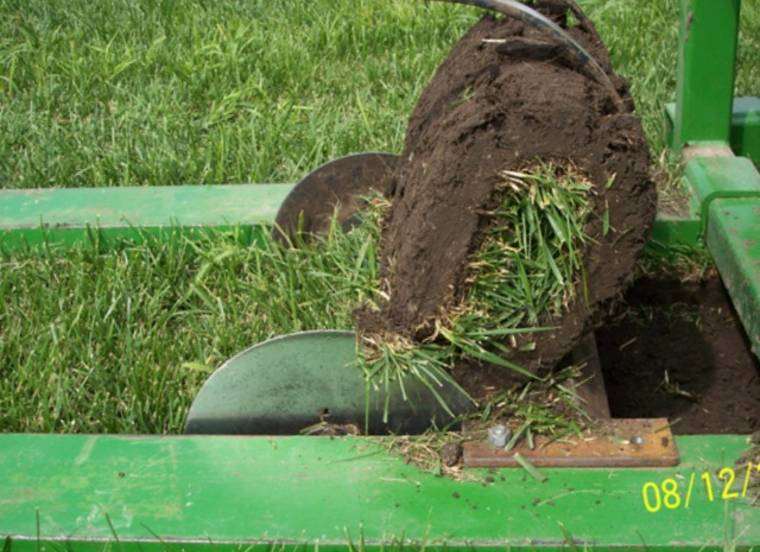

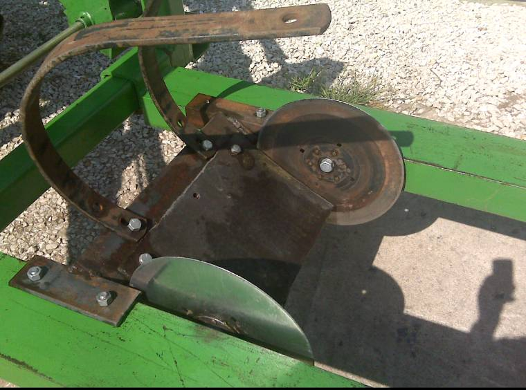

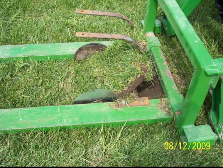

Another idea is building a sod cutter from my forks, sort of like this.

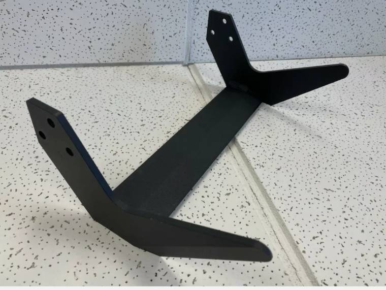

My idea is similar, but involves using a blade for a "real" sod cutter. I've seen a 24" blade.
However, if I can learn to cut it decently with just the bucket, no need to jump through any other hoops.
It sounds like keeping the depth semi consistent is challenging. I can work with it not being perfect, but there are limits!

Sounds like I need to keep thinking about a blade I can bolt to the forks like the fella above. The forks act like skis to keep the depth consistent. I *think* I found that on here.
/ Cutting sod with a PTB #9
That might just work. Pretty inexpensive if you already have the forks. (y)
I do, which is why I'm willing to give it a shot! All I'd have in it if it failed was the cost of the blade. My boss would let me swipe the stock from the scrap metal bin to build my mounting system. I'm figuring some square stock that slides over each fork, with a bolt on each one to act as a set screw and tighten them into place.
I just figured if there was a snowball's chance in heck of the PTB doing it for me there was no need to fool with it. If there is not a snowball's chance, I think I'll go ahead and order my sod cutter blade. I also have the forks, I can start working out exactly how I'll build it.

#11
You can kinda see the hump here. It's hard to capture in a photo.
/ Cutting sod with a PTB #12
I see it. I have similar on both sides of my driveway. Gotta be careful going around/over it as it's easy to scalp.
#13
Yep! I have resorted to push mowing that part with the 20" cut push mower, and I do everything else with the zero turn. That works for now, but I want it all leveled better than this.
I had decided to live with it, but now that I'll have a tractor I can't do that.
I hate to waste the sod, but if I wind up ruining it the sod farm is 45 minutes away and I can buy it for $125 per pallet. I hope to not waste it though since I've gotten it established.
