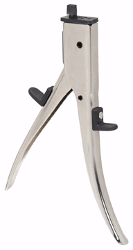

Get a hand powered nibbling tool. I used to install car stereos back in the 70s-80s for extra cash. They work great for making square and rectangular hole. Draw the line where you want the hole. About 1/4" in from the edge, drill a hole that'll fit the nibbler head through, usually 1/4" hole. Then insert the nibbler head, and start nibbling! :laughing: Works great! :thumbsup:
Nickel Plated Nibbling Tool
This is the same model as the one I have and the price is ridiculously low.

Rectangular Greenlee punches? I have a round set, and they certainly are wonderful, but didn't know that they came in rectangular form also.
Yes they do, they even make them for odd shapes like D connectors. The chances that you will find a rectangular one exactly the size that you need are a bit limited. The trick with rectangular punches is to use one smaller than you need then nip out the hole to exact size needed.
