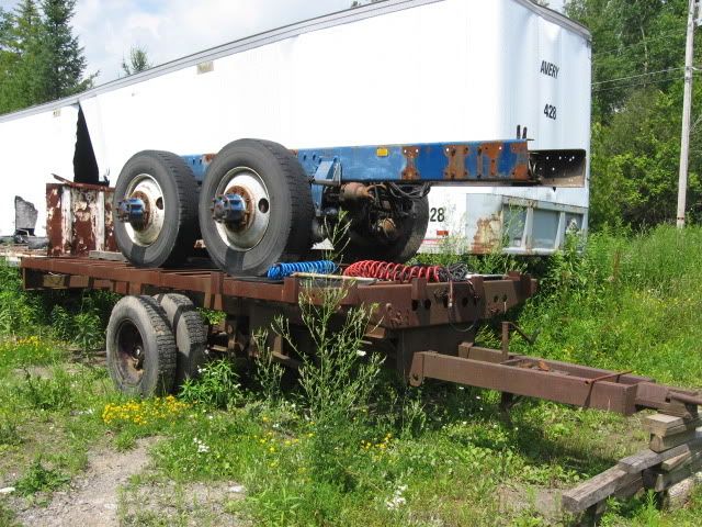

/ Cutting Railroad Track #29
during the last 9 months or so, there were people cleaning
out some scrap metal from neighboring property that i wanted
to buy, but i had stipulated they remove the scrap/junk.
there were a couple trailers, like heavy truck trailers, even
1 full size van box trailer. some of them had steel I beams
and every one was cut with electric hand grinders, powered
by a generator, and hundreds of wheels. pieces were cut to a size
that the 2 of them could load them into an old dodge PU truck.
they finally did get all of them cut up, but it took them countless hours.
here's a pic of some of the stuff they cut up this way:
/ Cutting Railroad Track #30
Oh man! They just cut up that wonderful junk and hauled it away???

/ Cutting Railroad Track #31
yes, and one of my co workers asked about it for
the same reason, snowmobile clubs use them for bridges
over streams etc. but by then they were chopped!
