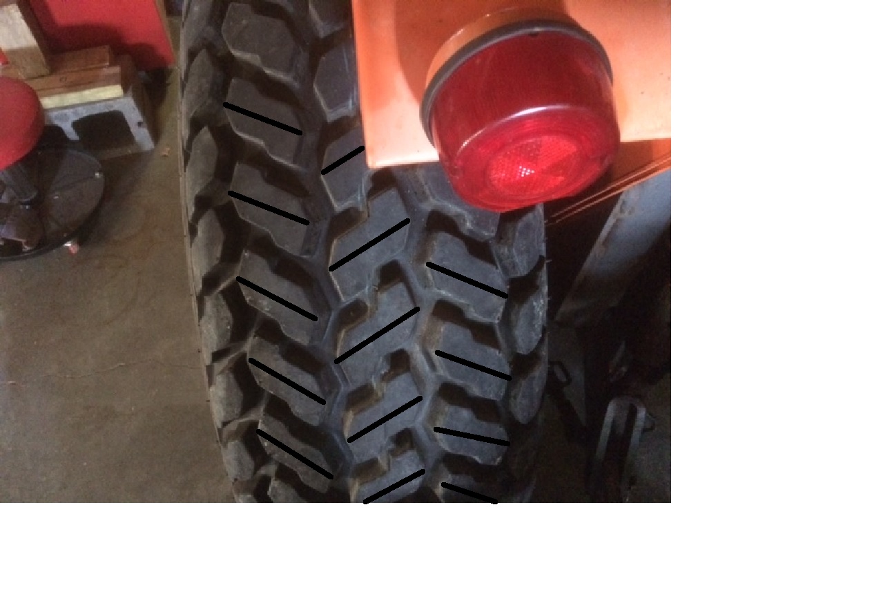

I finally replaced the original 29 year old Bridgestone turfs on my Kubota B9200 recently with these Firestone turfs. The local dealer had them as new old stock and let me have them for $100 ea. (13.6-16 size) My only concern is that the tread pitch is much coarser than the old tires. May "get" to run them in snow this week but wondering if they need to be grooved to get more bite.
Edit: The old Bridgestones had excellent traction in snow and ice.
I imagine those large voids would not pack with snow well.

They look more like R4 industrial tread than turf. Maybe I should just consider them industrial tread.
   / Cutting / Groving / Siping R-4 for snow #543
I would be inclined to groove them with a 1/4 inch pattern like this:
   / Cutting / Groving / Siping R-4 for snow #544
Thanks for your feedback illustration. I wasn't sure about what kind of groove configuration to use. That looks very simple to do.

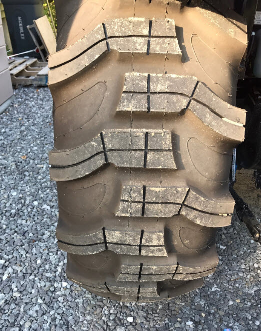

For those who grooved their tires years ago, and still have the same tractor, do you still have those tires, and if so, how are they holding out? Browsing tire grooving irons now.
   / Cutting / Groving / Siping R-4 for snow #547
Yes, perfect! I would do it again if I got new tires.
   / Cutting / Groving / Siping R-4 for snow #548

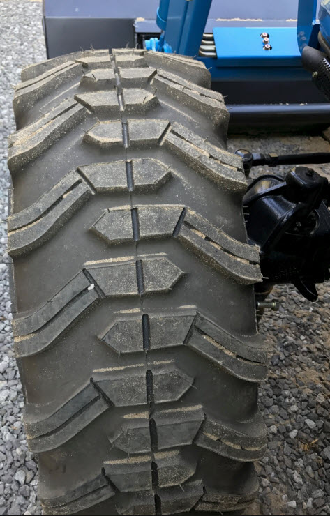

My grooved R4's wore down as usually and had zero tears, ripped lugs or anything negative.
   / Cutting / Groving / Siping R-4 for snow #549
Just did my tires too. It was pretty easy. If anyone need to use the tool, contact me, I'm sure we can work something out.
   / Cutting / Groving / Siping R-4 for snow #550
I guess it is time to revive this thread. Nice job Drewmon.
