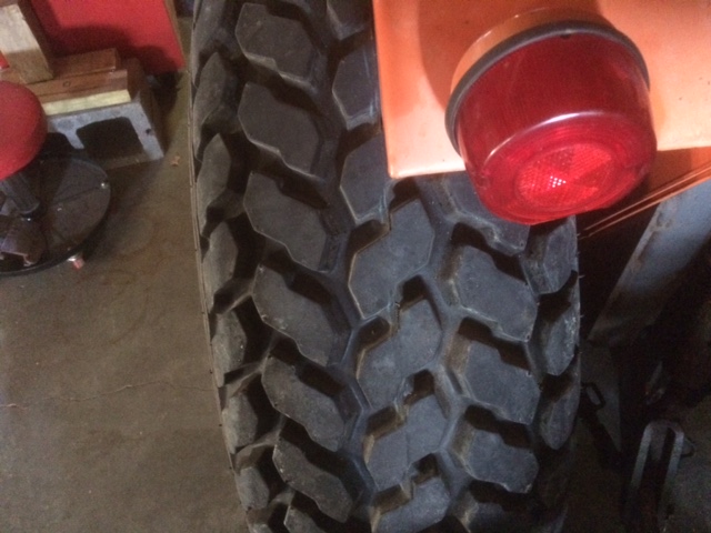

Dickfoster you need to post some picture so we can see you handy work and the pattern you selected.
They look like most of the others on here. I just put one groove down the center or close the center of each lug leaving some meat at each end of the groove.
Here's what the lug patterns looks like. As you can see there is a bit of horizontal and some diagonal lug to it so I think I'm good to go for both forward and lateral traction but it meant the grooves had to snake around and curve some. 1.jpg
The lug patterns were the same front and rear. Oddly enough the same 44 lugs per tire just scaled to the tire size for a total of 176 grooves I had to cut, 88 biguns and 88 littlens.

Sooner or later the nice sharp edge on your grooves will get worn down. My ag tires worked great the first winter but after 5 years with lots of miles they are not so good in the snow. I have lots of hills and a gravel driveway so chains are required so I really don't have anything to gain by experimenting. Do you find the snow sticking inside the grooves?
Ayuh.
FWIW while it may not matter either way, I started and stopped the grooves at about the same distance from the end of the block as they are front-rear. My rationale was this preserved load capacity. Others have gone all the way through with no apparent problem so that might be more conservative than necessary.
