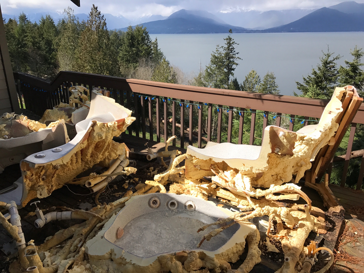

Ha ha... yeah I derailed my own thread but plasma project got bumped. To put a close to the hot tub project... I did get a little tractor time in hauling the sections of the tub that I threw off the deck. I used the hot tub cover as the cushion and to minimize the mess. Here is the load going to the dump tomorrow.

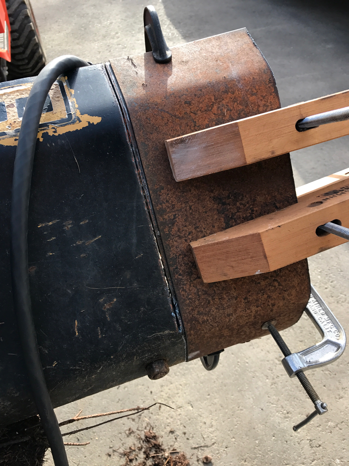

Status... Pouring rain solid all day. Looks like I will have to wait until next weekend. Might try making a template though. Looks like it will be 5in off each end. The blade is welded to the sliding carriage and I'm limited by the cutting edge bolts.

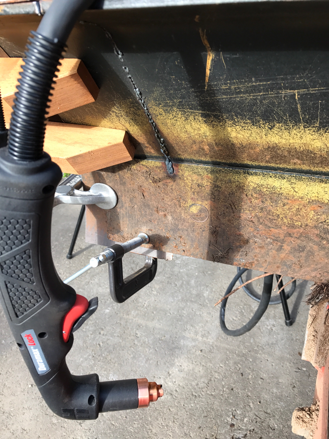

Okay help! Started the cut and hoping I could do it without taking the cutting blade off. Guess not. I started taking the nuts off with the impact wrench but only 2 of 6 came off. The rest are spinners. How do I keep the bolts from rotating?

Job done! Took longer than I thought only because my welder, plasma cutter, and air compressor are all sharing one 220v outlet. What a pain! I really need to put in a sub panel and bring more juice to my shop.
Plasma easily cut the 1/4in but struggled with the 1/2in. Got some ideas why but think I will start a new thread in the welding forum because I don't think it is a simple solution due to the tapered thickness of the cutting edge.
