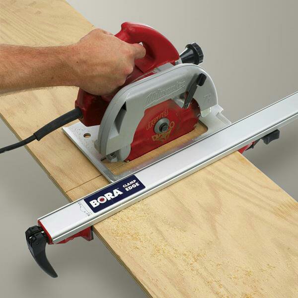

So track saw = measure, mark, clamp, cut one straight line. Do it over again for another straight line.
Panel saw on the other hand can make multiple identical cuts, same as a table saw, but with less effort than a table saw.
If I was still doing production I would look into a panel saw -- what is the cost, accuracy, and repeatability, compared to a table saw.
But can't see spending $600 for the track saw that apparently gives you one straight line per setup.
