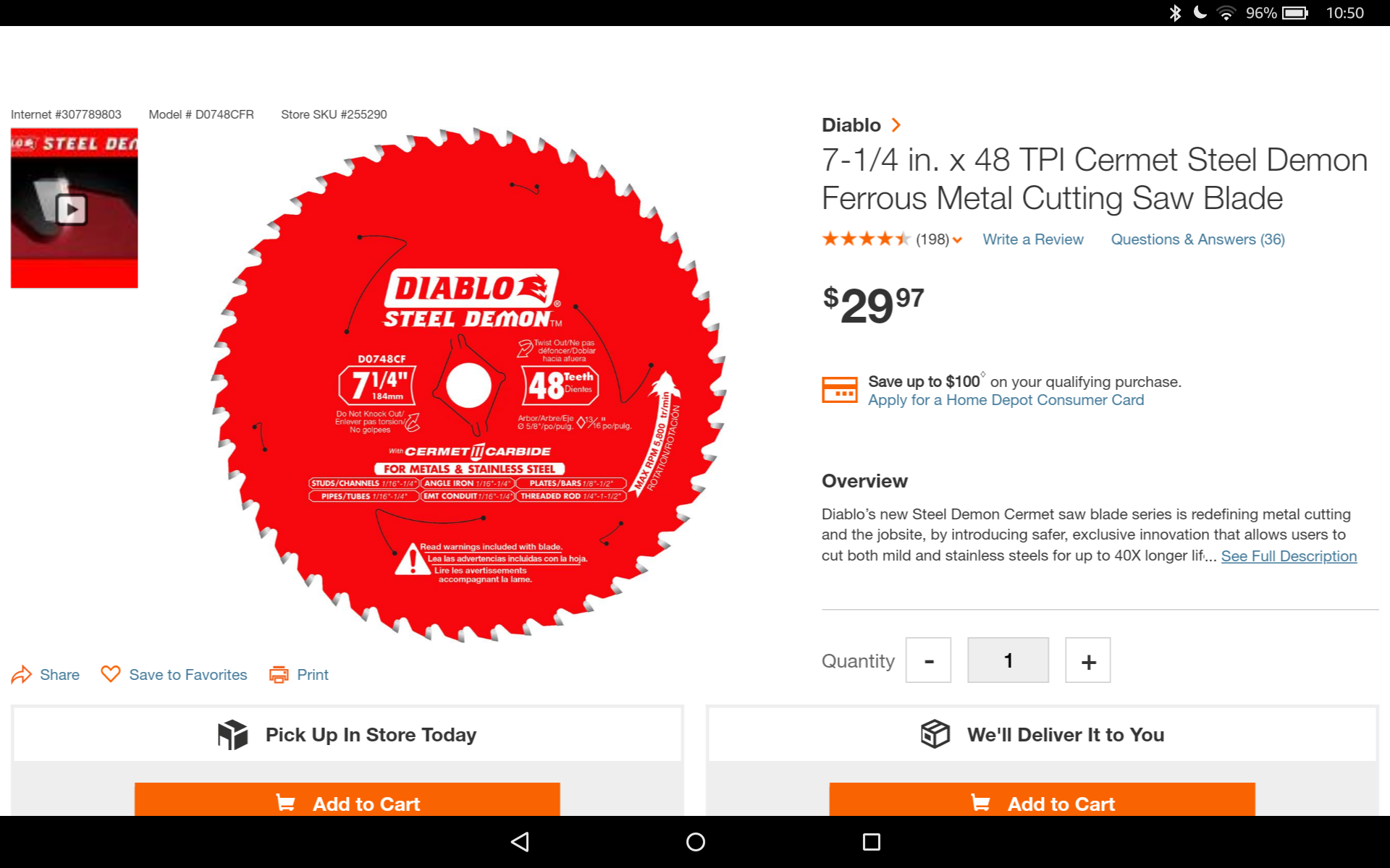

A special saw is not needed.
I use this diablo blade in a 25 year old skill saw and it works perfectly.

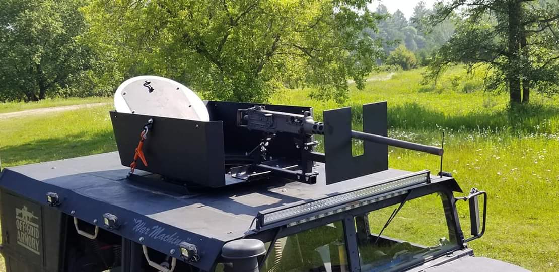

I used only one blade on this full rotation gun turret I built. I cut all the 1/4" sheet pieces and I'm still using the blade.
/ Cutting 11ga. plate #19
Cool lookin gun turret, Dave!
