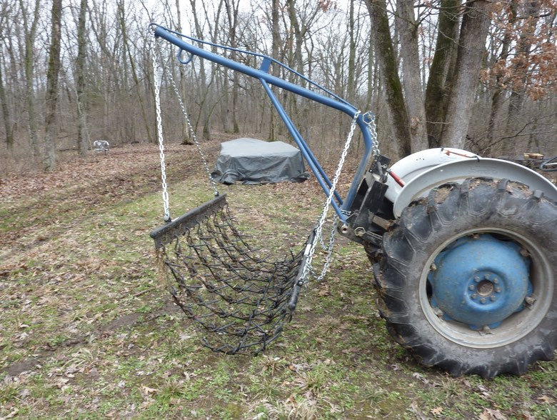

Using the culti-packer will do a better job than you sitting in a Lazy-Boy recliner,,
fence, panel, tires, culti-packer,,,,,,, anything will help.
I built a dedicated tool for this,, but, it was not perfect until I attached a set of dual wheel truck snow chains behind.
The snow chains work well because of the small size, and relatively heavy weight.

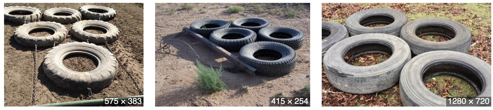

I saw a neighbor pulling 6 truck tires bolted together just this week,
the tires did a wonderful job,,
I would imagine the tires will last 60 years or more, no matter how much you pull them.
But a lazy boy is much more comfortable than a tractor on corrugated fields! :) The truck tire thing is interesting though, I have a crap load of tires that I've been finding and getting rid of here. I have a bunch of large ones left that I haven't tossed or turned into animal rubbing posts yet. Did he bolt the together flat or in the rolling position? Seems like it may be more maneuverable too. Last year I had no paddocks set up (had no cows until my wife decided to do an October surprise) and this year I have 6 of them so far with alley ways to work around. Retirement my butt! lol
Just bolted together laying down,, if you get real rambunctious, you can add a second row.
If you bolted 5 together, pull from #2 and #4,, for a more even pull.
I use a cable as a drawbar, rather than chain. The 5/8" cable stays pretty rigid.
