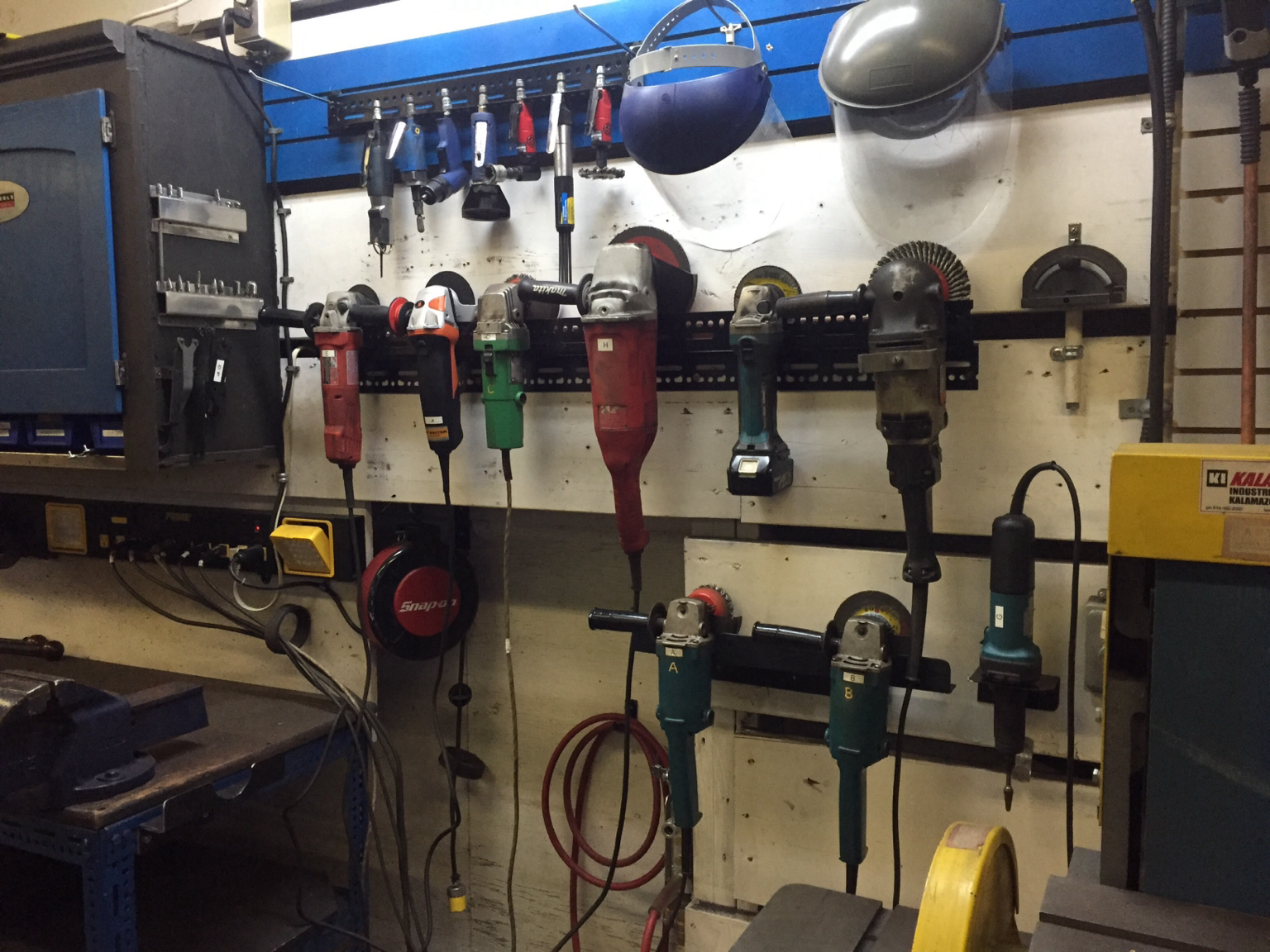

Gee Big Barn! How can you possibly get by with ONLY 8 COWs? Your shop looks like a COW supply house :)
Darn "tool ****" addiction. I try my best to attend the weekly meetings. "Hello, my name is Terry......."

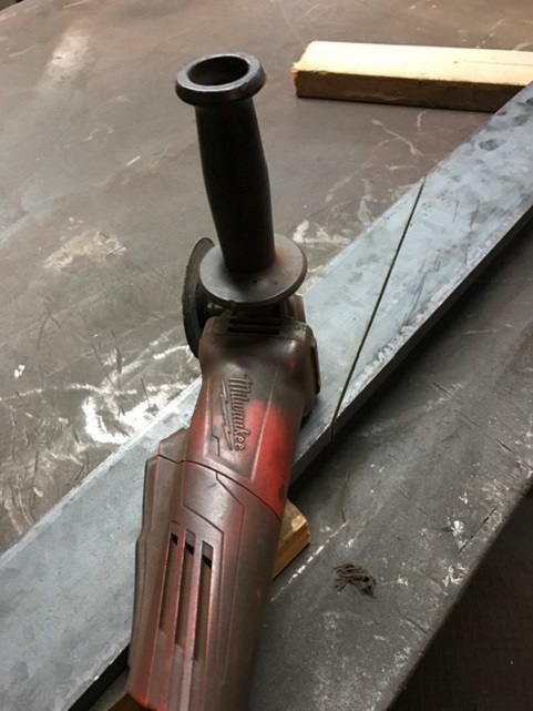

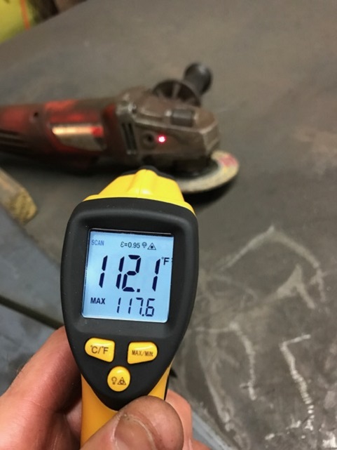

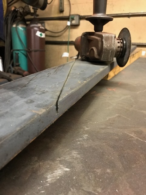

I just happen to be using the Milwaukee today with a cut off wheel to cut some 3/4" thick X 4" wide hot rolled. The angle is to long to cut with the saw, I have 4 pieces to cut. The actual cut is 11 1/2" long. I don't think a HF grinder could stand up to this challenge.

/ Cut-off wheels and angle grinders #31

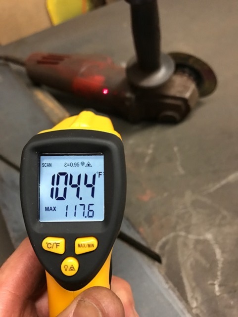

Okay I just got done making my 4 cuts, I made it happen as quickly as possible. It took me about 35-40 minutes to cut these. I took the temp of the grinder after last cut. You can see the red laser mark where it's pointing. I don't think it's to bad. The Mt. Dew can is for reference to size.
