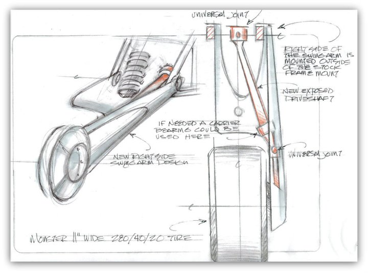

I've attached a sketch I found on Google of what I would use. This a swing arm concept from a motorcycle. The key is how it attaches to securely support the wheels. You would not use the drive shaft system.
With this design you could run a frame member from one side of the vehicle to other to secure the swing arms. This would make a very rugged suspension. Attaching the suspension just to the side will not be strong enough.
Of course just my opinions! :thumbsup:

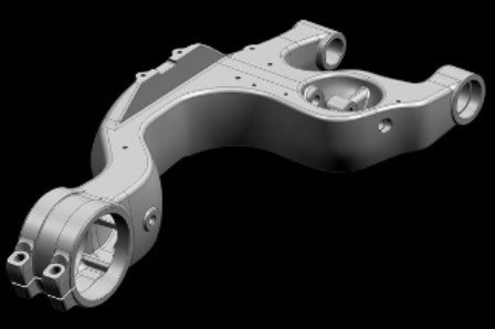

That is really cool, if I only had their budget. It appears that the Mini Crusher doesn't use any kind of swing arm. It just puts a suspension really tight to the tire. The air suspension that I'm going to use will require close to 5 inches of space. So it doesn't really give me much choice but to put the shock either in front or behind the wheel. The machine is getting wider than what I like already. If I move the wheels out another 4 inches, it will be too wide.
I'm just trying to get my head around that swing arm system. How I could attached to what I've got. I'm not quite sure what you mean when you say that I could go from one side to the other. Where would you suggest I put it.

would that not affect my ground clearance, I want to keep the middle as open as possible. One thing I have looked at is a single-sided swing arm that are used on motorcycles. I could build something like that.
