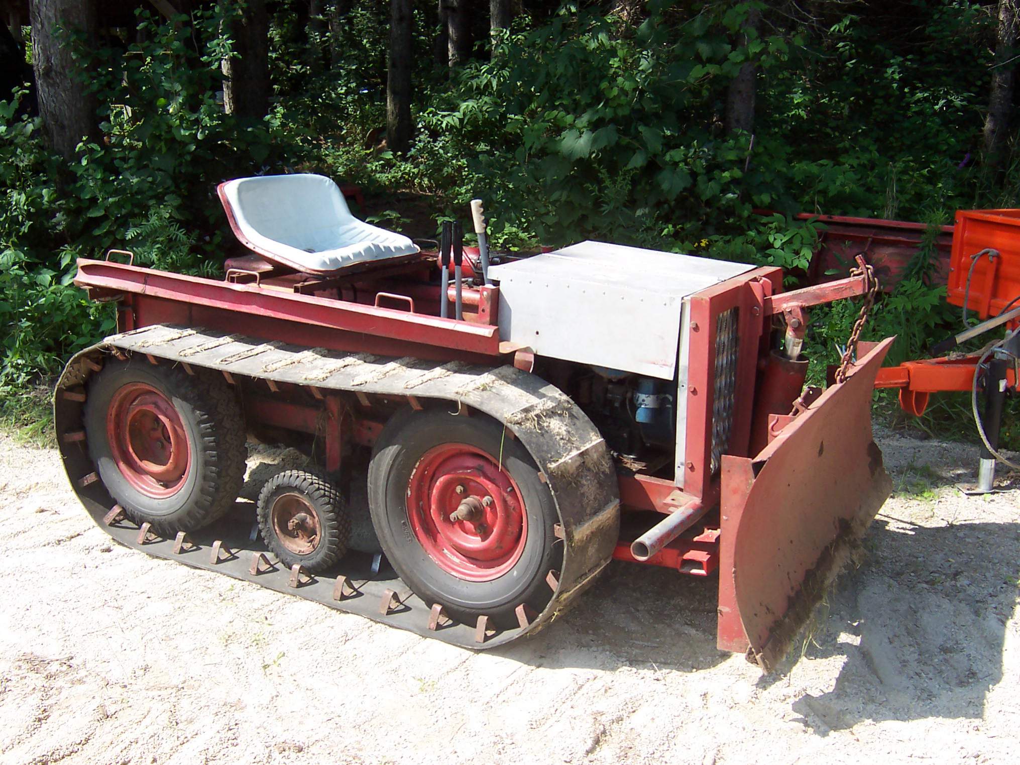

I've always wanted to build some sort of small tracked recreational vehicle myself - something along the lines of an amphibious tracked Argo, as I have earthmoving gear for excavating...etc... I don't need it to be anything other than a fun project.
However, I haven't progressed beyond the initial concept/design staged & accruing some assorted parts primarly because of time - my initial inspiration was this photo which I saw on the internet (it may have been this site ) Picture%20001.jpg
Anyways for what's it's worth, conceptual IMO the cheapest/easiest way around the expense/complexity of track gear should "in my theory" be driving through a vehicle diff/axle fitted with:-
1) an "on demand" air locker diff to provide even power to each track for straight forward/reverse momentum
& 2) seperate brake actuation to each brake disc to enable steering through individual track braking (with the air locker disengaged)
The commercial track sprockets/idlers/chains/grousers & rubber tracks I have deemed too expensive for my project, & self built rubber tracks (like this photo) too time consuming & too much trial/error - so I've purchased at a good price at auction a set of Bobcat Skid Steer over wheel tracks which allows me to use standard car wheels/tyres for the drive sprocket's/idlers & homebuild the track frames (again like this photo)
Good luck with your build & please keep us appraised of progress.
