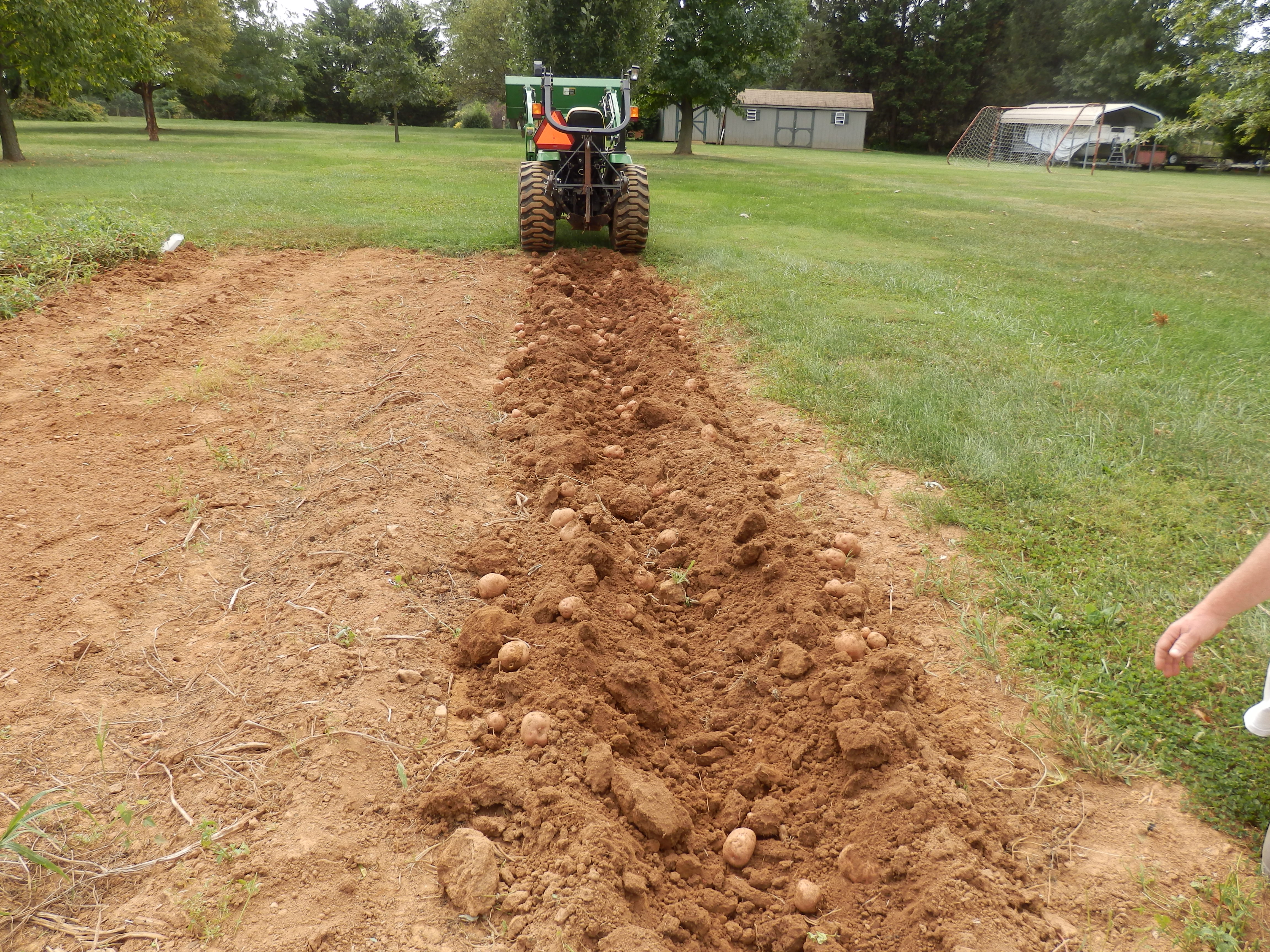

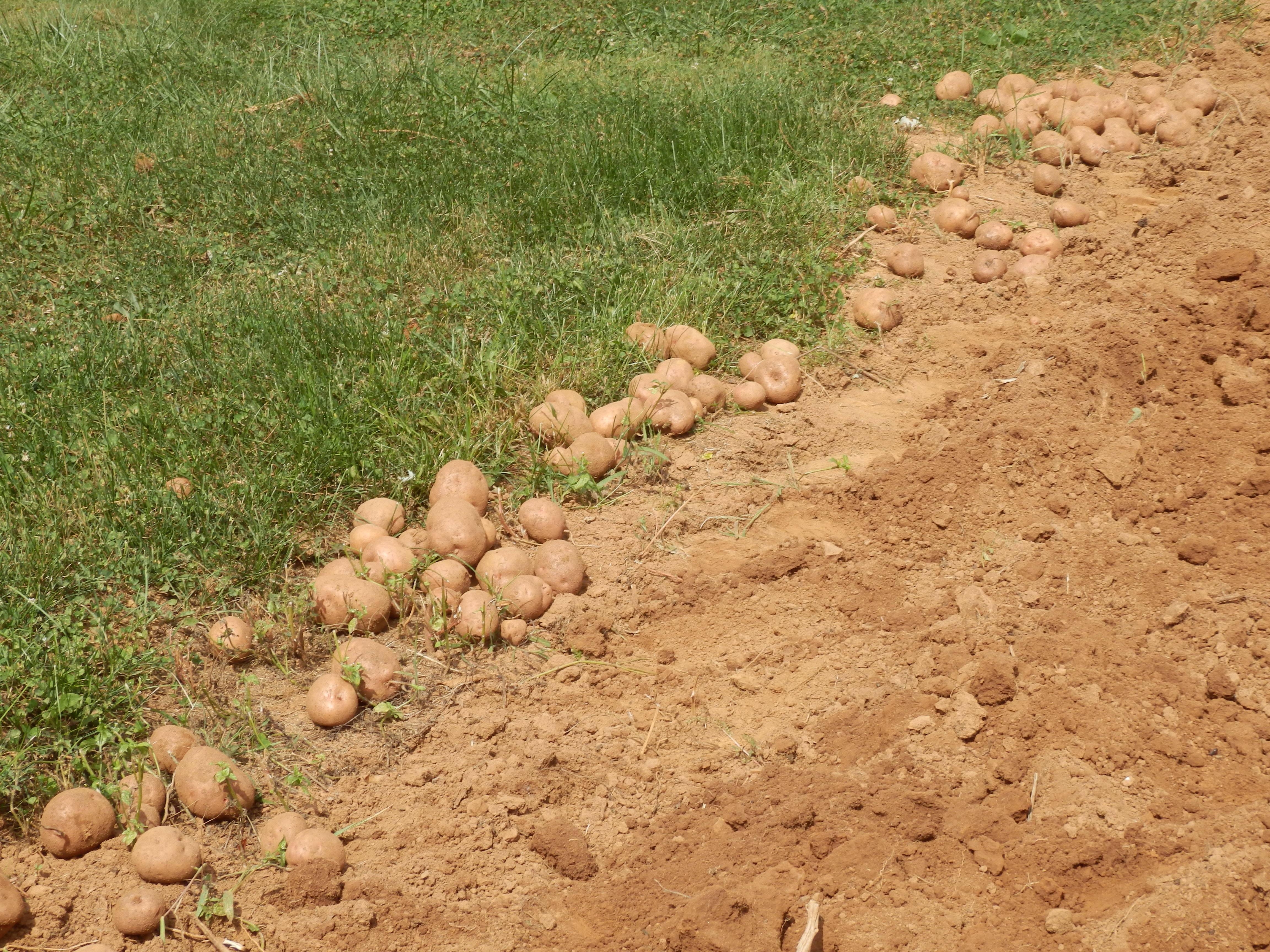

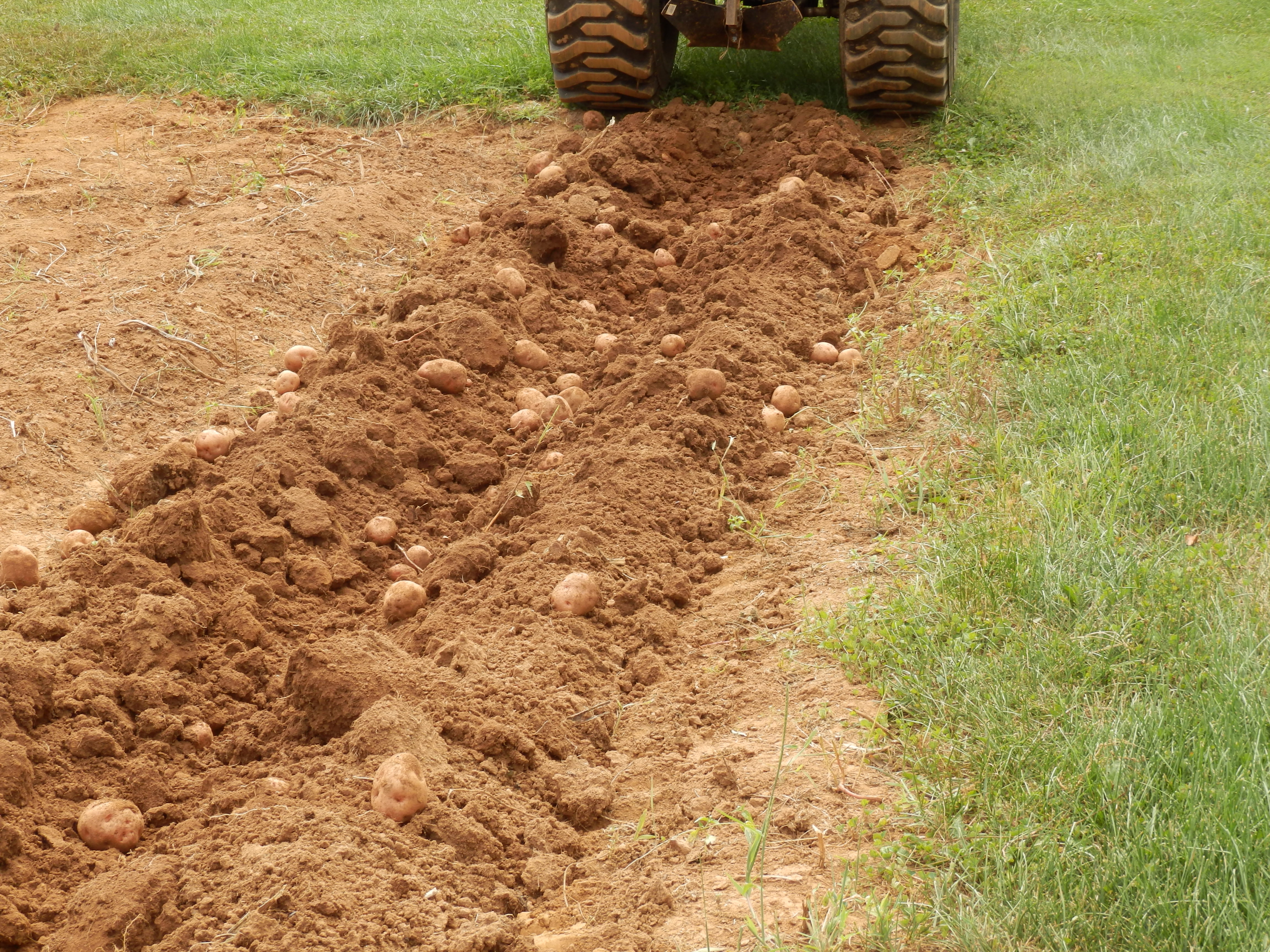

Hi All,
I've kept this one pretty close to my vest for the last few weeks. Tried it out today and am very pleased with the results.

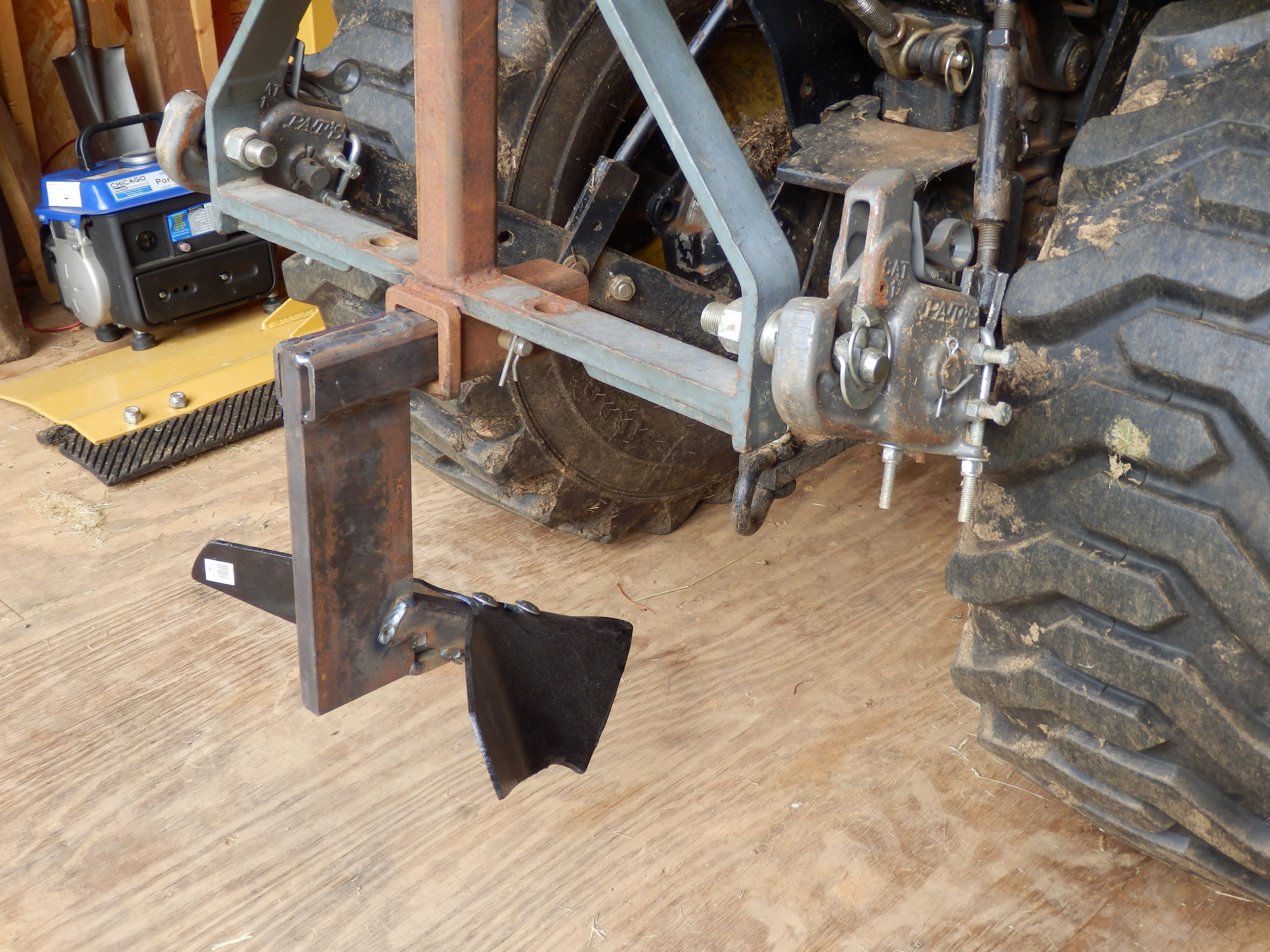

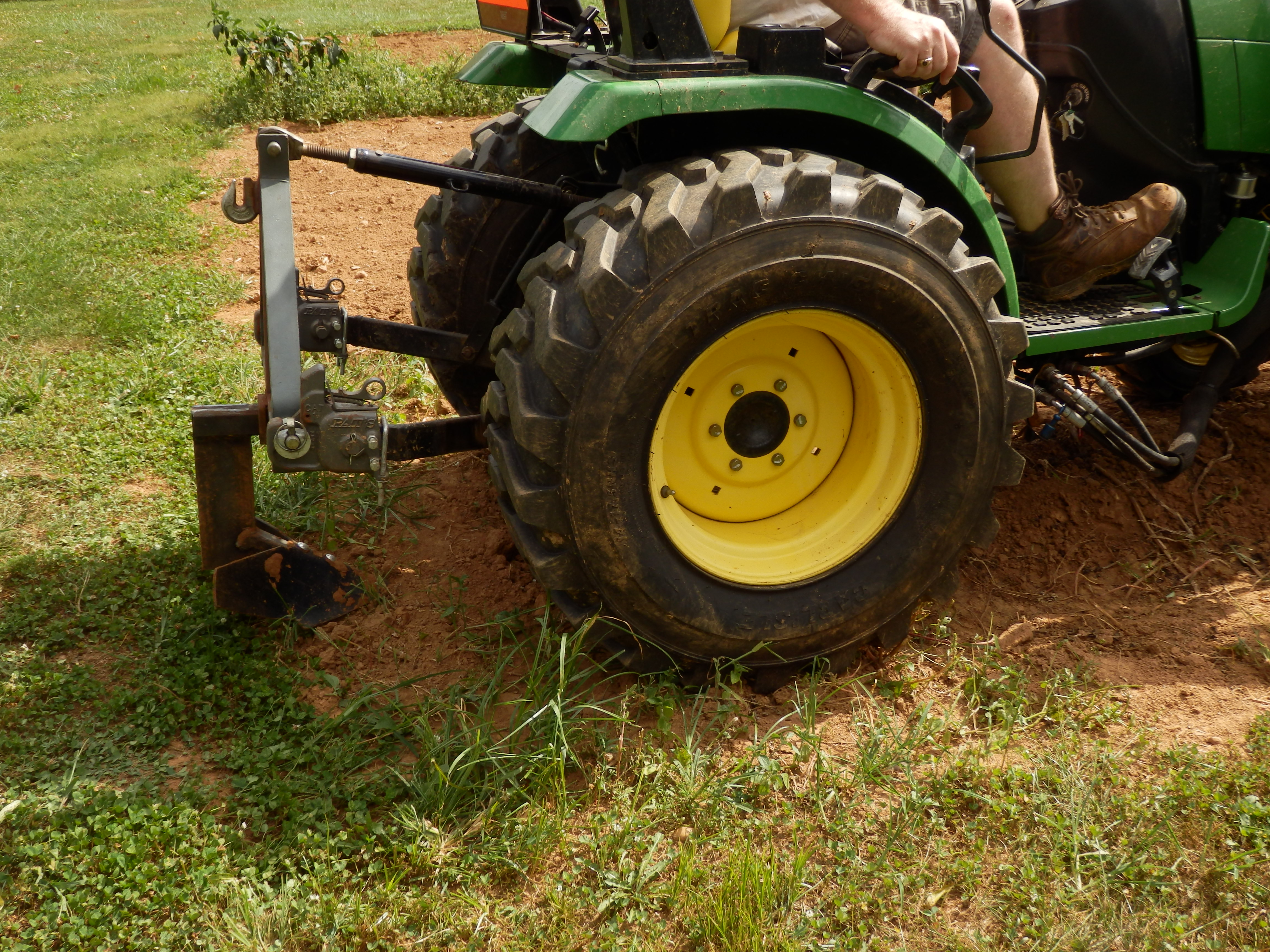

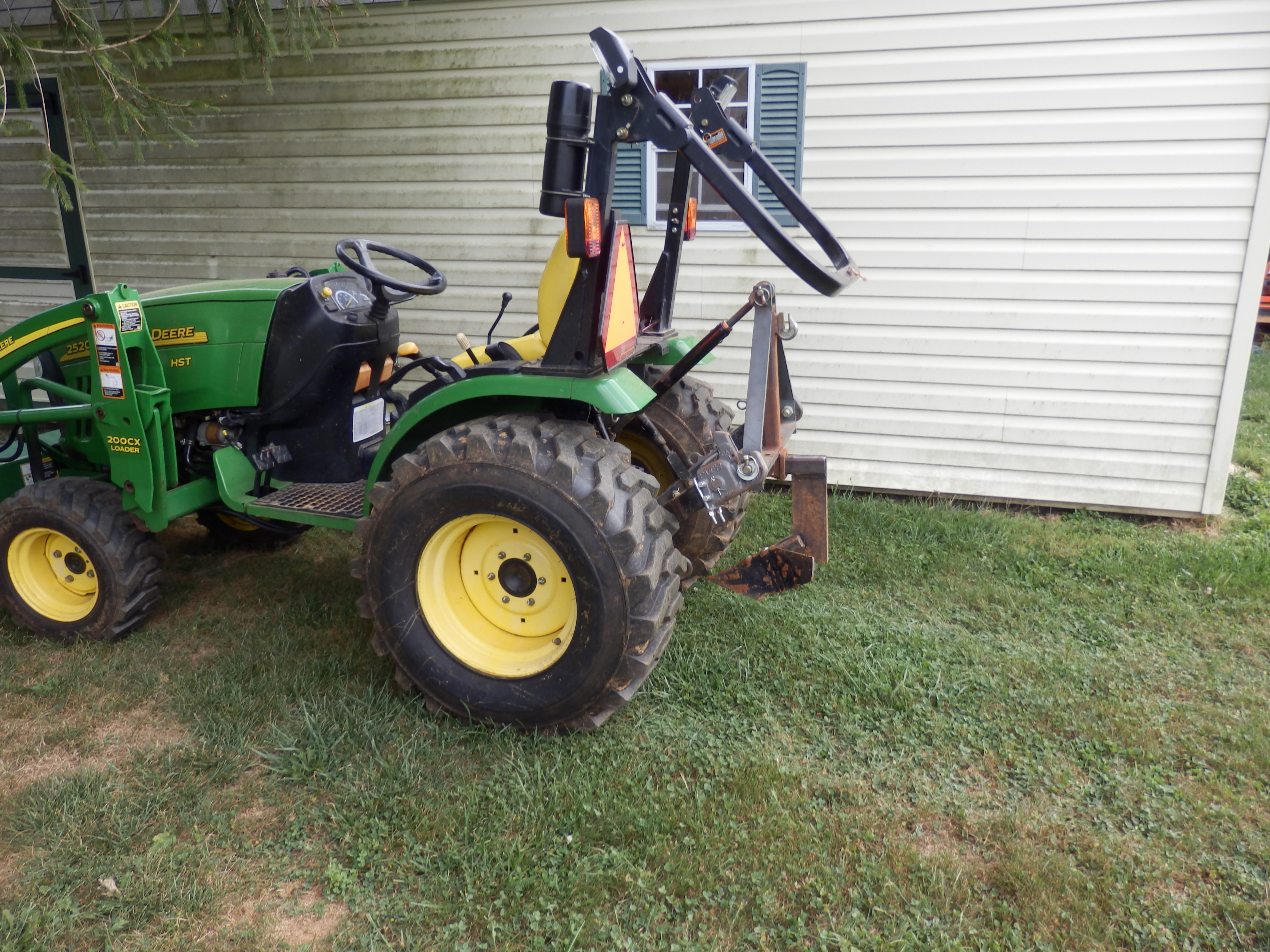

1) I have a triangular 3 point drawbar that many of us use to move light trailers around.
2) A couple of years ago my welder friend beefed it up with a center post, 3/8" log hook, and 2" receiver
3) I wanted a potato plow that "plugged" into the 2" receiver.
4) My Amish welder friend produced the beauty shown below.
I also have a short video clip, but haven't figured out to attach it yet!
Frank

Sure beats a potato fork. Nice Job. I shorten the right side life term on my tractor and use the middle buster / potato plow like a one bottom plow. Works good enough for me and gives more use to the middle buster.
/ Custom Potato Plow at Work #3
Looks like a great device. I have some sweet potatoes to harvest in a few weeks. I am thinking about using a spring tooth chisel plow. Do you think that would work?
/ Custom Potato Plow at Work #5
Good idea. I'll try that. Right now I have a middle buster and change the plow foot to the one the OP is showing. Not a lot of trouble but cranking the right lift arm would be better and easier and I'm all for easy. :)
Get you a extended reach hand pick up thingy and a lawn mower trailer for picking potatoes.
Good tool you have there farmeratheart. I too try to use every implement for several different tasks. Some work some don't. Only way you'll know is try it.
