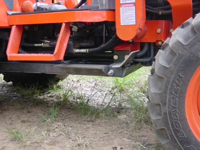

   / Curved steering rod on CK30? #24
Like this?
   / Curved steering rod on CK30? #25
</font><font color="blue" class="small">( Like this? )</font>
Yes, that'll work. Looks as though what you've done with the belly pan is to place it so that it's just in front of, and protecting, the filter. Great idea.
John

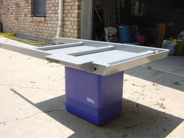

   / Curved steering rod on CK30? #26
Were I to buy a CK30, I think I would weld in a protective frame around that filter
I think KiotiJohn will have a CK30 pretty soon /forums/images/graemlins/grin.gif /forums/images/graemlins/grin.gif
   / Curved steering rod on CK30? #27
John, it covers from the engine oil pan back past the filter. I didn't want to tear the filter off, then figure out I needed protection. /forums/images/graemlins/shocked.gif
   / Curved steering rod on CK30? #28
Very Nice! Can you supply a more complete picture of how to make it?
Thanks,
Mike
   / Curved steering rod on CK30? #29
I've got some on my home puter, I'll post them when I get home.
   / Curved steering rod on CK30? #30
Here's a pic or two of it off the tractor.
