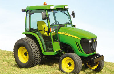

The cab on my HPX is a Mauser. They make cabs for compact tractors too.

does mauser have a website, i did a quick search on the net, did not find one
thanks,jim
/ curtis cab on a 2320 #11
mjncad,
You'd think Mauser would have a US dealer, My HPX cab was through John Deere, and from the factory, so maybe a JD dealer has access to Mauser products. I guess keep Googling til you find one.
Jordale Perry also makes cabs. Jodale Perry Corporation
They do have a cab for a 2320, something in the $4000+ range.
