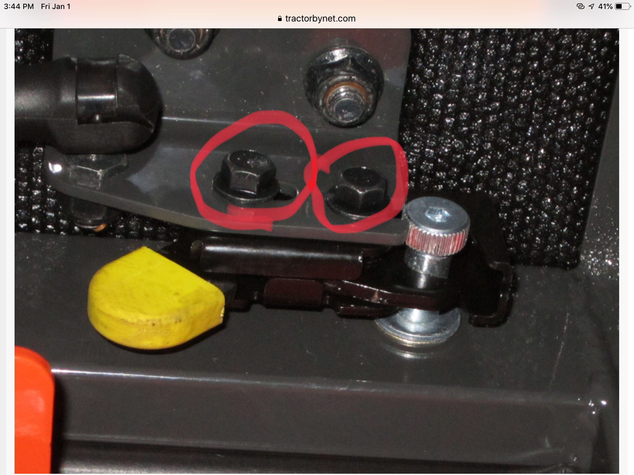

They are good cabs I think it just not adjusted correct see post #12 looks like the bracket is hitting the striker bolt....The dealer should make it correct they installed it.....

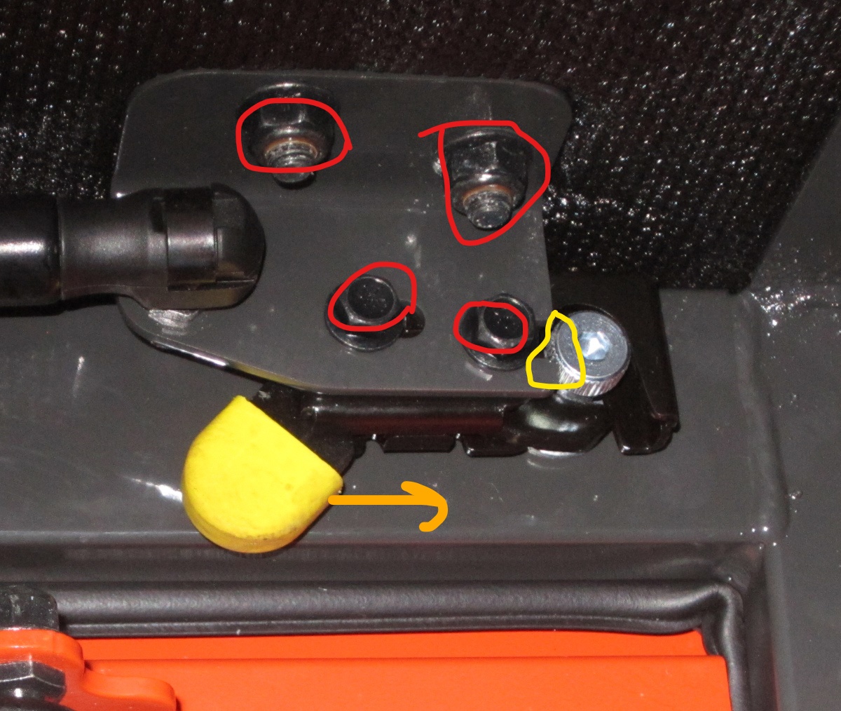

I'm afraid this got off topic for a bit. I have a problem, I'm just asking if anyone else has experienced this, and how it was resolved.
Bottom line, the latches don't work. The instructions only say, "adjust them". I've loosened the adjustment bolts. I've pushed them through the full travel of their adjustment, eventually I got one to work, sorta.
This is the lever all the way down.
This is the lever all the way up.
I have no idea which way is "open". The arm stays around the pin, period.
This is a roof latch, I've moved it through the full range of adjustment, but it can't be moved.
Can the latches themselves be assembled wrong? If something is wrong, could the act of tightening the adjusting/mounting bolts prevent them from moving? Unlikely, as I can't move the lever even with it hanging loose.

Ok, see where the pin screws into the frame? The brass part is a rivot nut, the pin screws directly into it, the washer on it does NOT belong there. Why he put it there, and one on all 4 pins is beyond me, but taking it off, sure helped.
While it still doesn't work like the ones in the video, they DO work now. Maybe further adjustment will help that, maybe it's just my limited range of motion, or maybe that's as good as it will get.
/ Curtis cab latches #35
I can see why that would make it almost impossible to open as you would be binding the latch against its own frame.
