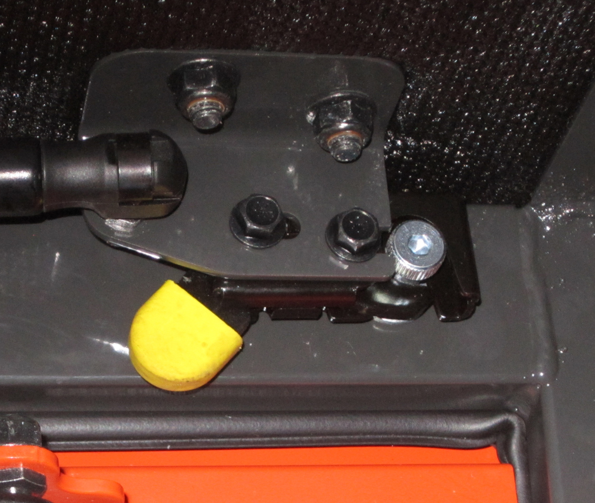

So I bit the bullet and had a Curtis Cab installed on my Kubota BX. No doubt the basics are the same for Curtis Cabs on all makes, so here is my dilemma, no matter what I do, I can NOT operate the little levers to lift the roof or remove the rear panel. My dealer is no help (I really should have driven to the one farther away for this), Curtis Cab didn't respond to my question.
Does anyone have a Curtis Cab, and can show me how the devil these latches operate? I have a hunch they are out of adjustment, but all 4 won't operate, no matter how I try to move or depress them. I think this is the first time this dealer installed this cab, so it's likely they are all the same wrong.

It looks like you lift (D) latch up both at the same time and push the rear panel out its hinged on the top then lift up to take the panel off........
/ Curtis cab latches
I agree, but no matter what I do, which way I try to move the lever, no matter how I try to depress the lever, it simply won't move. This is consistent with all 4 of them, 2 on the roof, 2 on the rear panel. It says they are "adjustable", but doesn't indicate how. My disabilities make it hard for me to reach them, much less get in there and start playing around with screws to see what happens, hence why I'm inquiring if anyone else has ran into this.

I think the pin is what adjusts the end of the pin might be a torx head like this.....torx pin.jpg

Rear panel latch:
Roof latch:
/ Curtis cab latches #11
Try loosening (NOT removing) the two bolts I have indicated on each latch. Let the latch assembly slide up away from the striker pin a bit. If that allows you to operate the latches, adjust so the panel latches and unlatches smoothly.

Same as RickB but I think you have to loosen all four in red , It looks like( circled in yellow) the bracket is hitting the striker pin...Inkeddoor_LI.jpg

Start with the two I circled, they have slots and will allow the latch to move away from the striker. The two nuts only serve to attach the L bracket to the panel. If that ends up being wrong, go ahead and loosen the nuts.

Okay, after a few days of delays for moving $&($%&(@%&*$ snow, I finally got to those bolts.
They loosen the latch and allow it to be repositioned, nothing more. After much fiddling, and repeatedly picking up the socket because of the $*#W*^#(^)^ COLD, I finally got two of them to move, a little. What this does, I'm not sure. It might release the lock, but I still couldn't push anything open.

Curtis finally replied after my third inquiry, they asked for pictures, which I sent, awaiting any advice now.
I have tried to adjust the latches, no matter how they are adjusted, the levers do not move, period. THAT is an adjustment problem????
