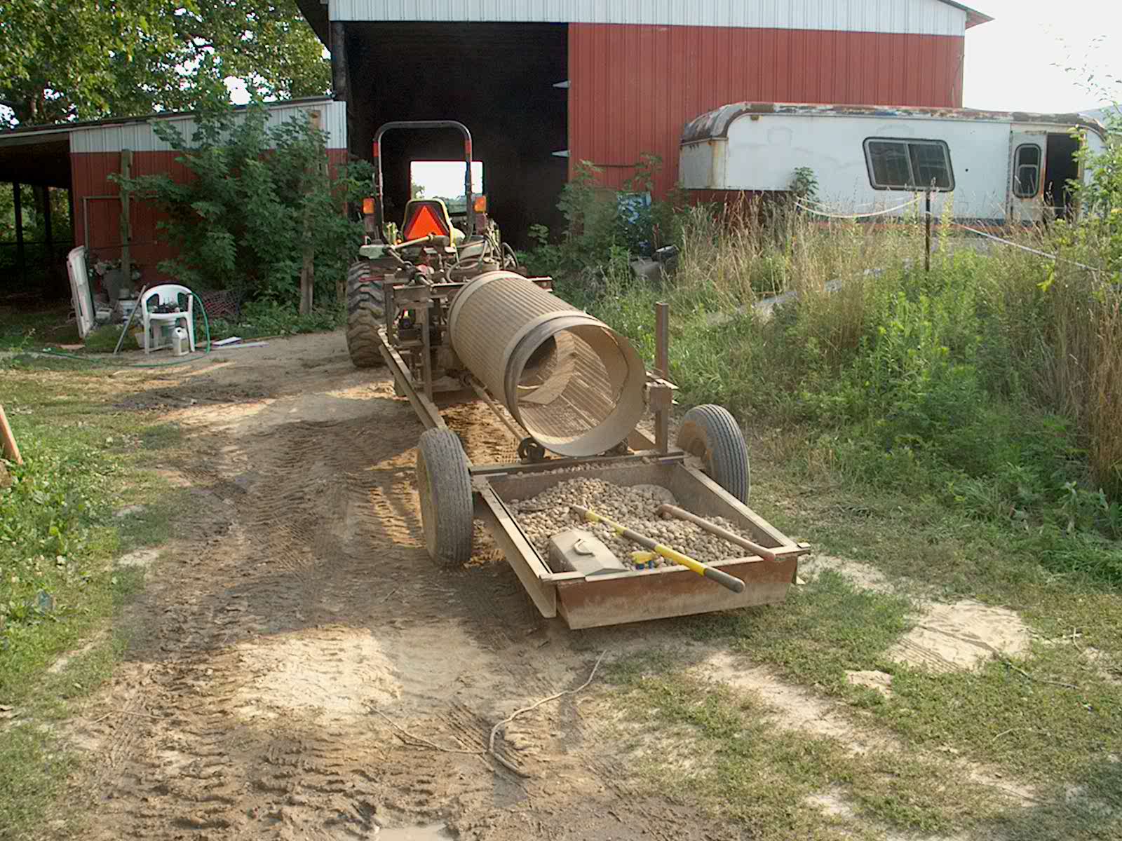

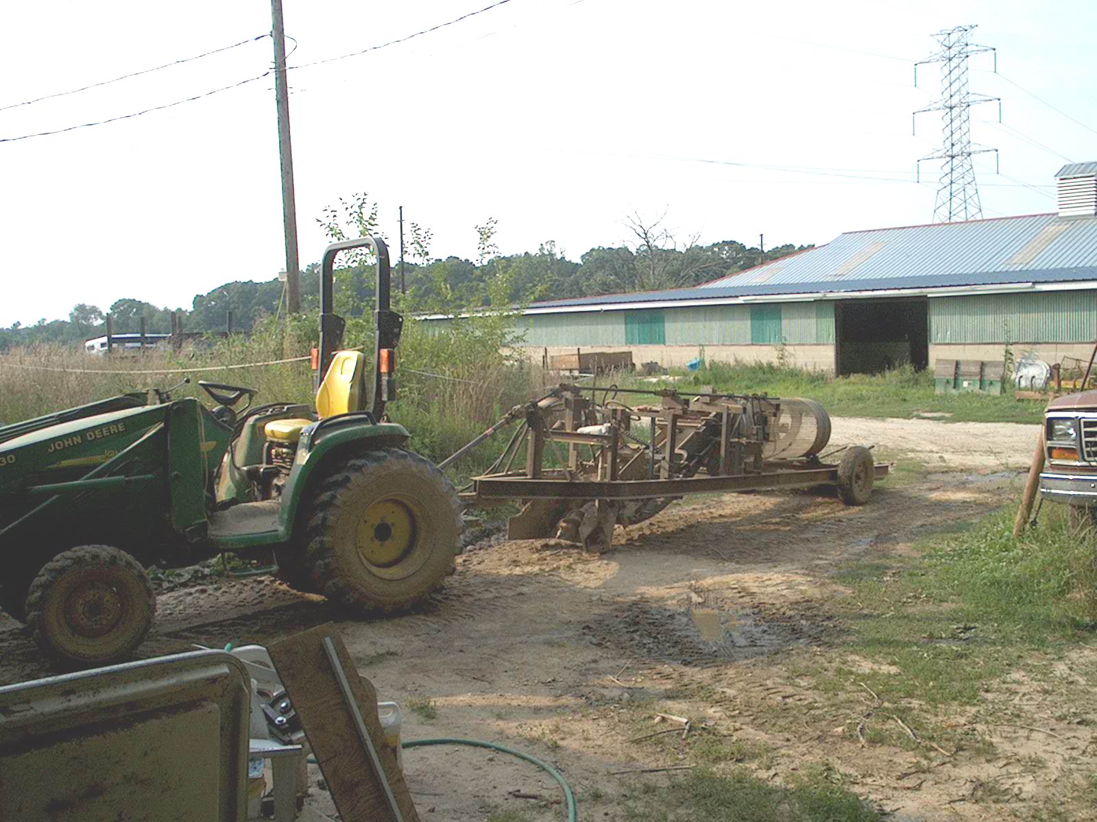

here are more views.

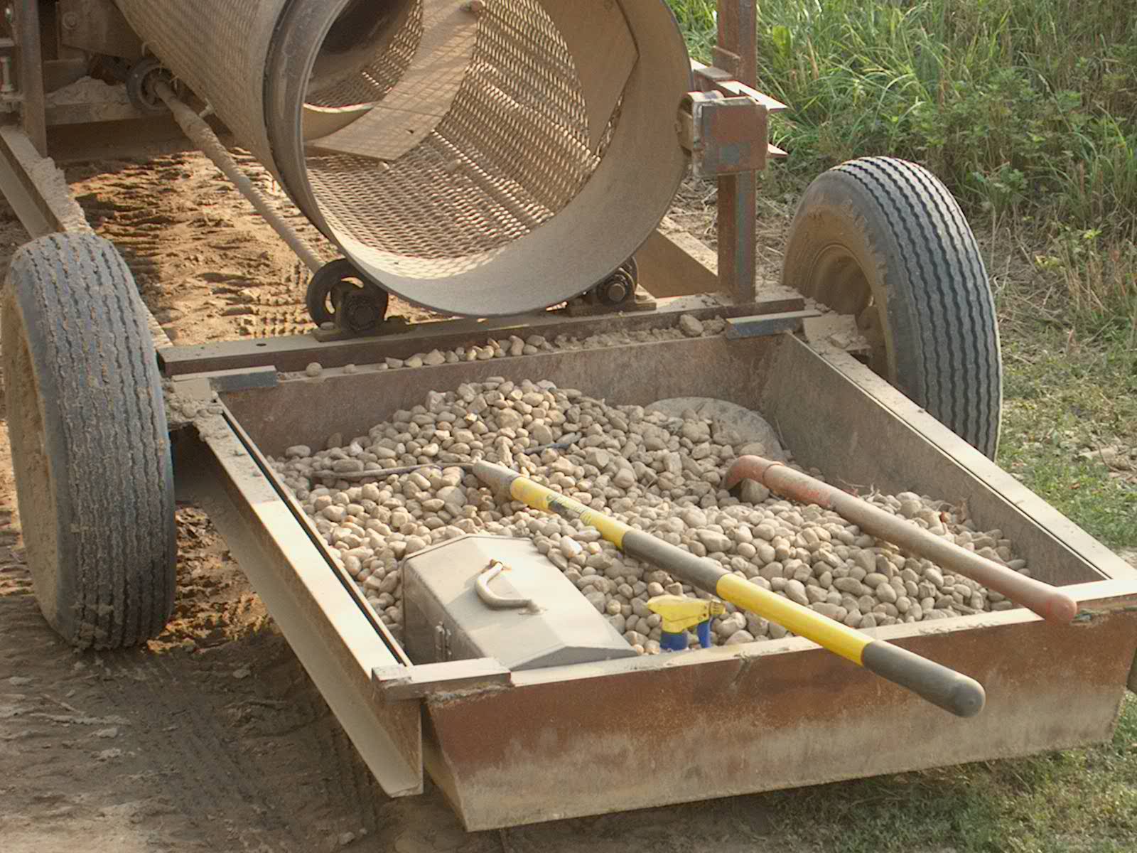

it's a rock and stone picker to remove them from my horse training track

Wow! That setup must have a 500 foot turn radius? Sure hope your training track is a large circle.;)

I wonder how slow the tractor has to go in order for the tube to dislodge the dirt it is picking up.
When I first looked at the pictures and saw the shovels, I assumed you were hand feeding this monster. The last picture shows just a little bit more and I realized you pull this thing thru plowed dirt with probably great results.
Any chance of putting a couple of hydraulic cylinders under that rear catch basin so you can just dump it, instead of having to shovel them out?

i lift the hopper out with the forks and dump the stones on a pile
i use the rake to pull the rocks to the rear, i wanted to keep it simple

I noticed it being a basket with retaining lugs AFTER I hit the submit button. Figured you had a reason, but you have to admit it would make it easier to drop them off it you had a cylinder on it to flip it over.

hydrolic dump would have added to complexity and cost and i couldnt have dumped in a pile due to hight

Wow, that auger/conveyer belt setup is downright brilliant. I can't even begin to imagine the math that went into the gearing setup! A smaller scale version of somthing like this would be invaluable to me. As a horse owner myself, I curse all large rocks I come across in our arena and round pen.
Just one question comes to mind...
How many PTO HP does that little deere of yours put out, does it run the whole works without any trouble?

not much power, it can be turned by hand
the math was that looks good and vary engine speed
if i was to start again id do some things differently but i had to make do with what i had so in some respects its a kludge
i may upgrade it in the future

I would think stationery would be more troublesome than movable, due mainly to having to handle the material three times. Once to load it, once to haul off the clean dirt and once again to haul off the rocks. Plus allowing room to manuever around it, high enough to get under it, etc.
I ran stranding machines for years that were just big tubes, made of 1.5" thick steel by 100 foot long. Most were run by belt drive with rollers underneath for them to spin on. I often wondered why they didn't design them to just power the rollers since the weight of the tube wasn't going to allow it to slip. Must have been a reason, but it always slipped past me.
What I want to know is where did you get that tube? Seen some things similar but never exactly like it, and it looks just like it was designed for that purpose.
I wonder how much trouble you will have keeping the small rocks cleared out of the holes in the tube. Since they are inside trying to get out, a pressure washer might be the way to force them back in and continue to the rear. A daily maintence of a few minutes with a pressure washer might be all that is needed to keep those rocks from filling all the holes.

Can you post a bigger photo of the pick up tube ... where & how the dirt is collected?
I can't tell for sure, but it looks like you have an auger screw to do this?

the screen is mad of 2 pieces of 24" steel pipe and expanded metel rolled to a diameter of 24' with 2 strips of 1/4x6 steel rolled to splice it all together ill post a pic later
no problem really with stones clogging the screen
i made some mods yesterday and today it works better but i still need to add something to make it more efficient
ill post more pics when i get a chance
