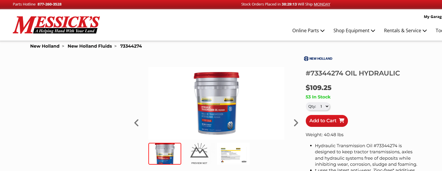

That is the latest from CNH unless you really want to go crazy;
   / Current name of New Holland Universal Tractor Fluid #3
$115 for 5gal sounds about right. Cost more than some but less than others..however the correct oil is always cheaper than replacing parts like a wet clutch, brake or anything in a HST system.

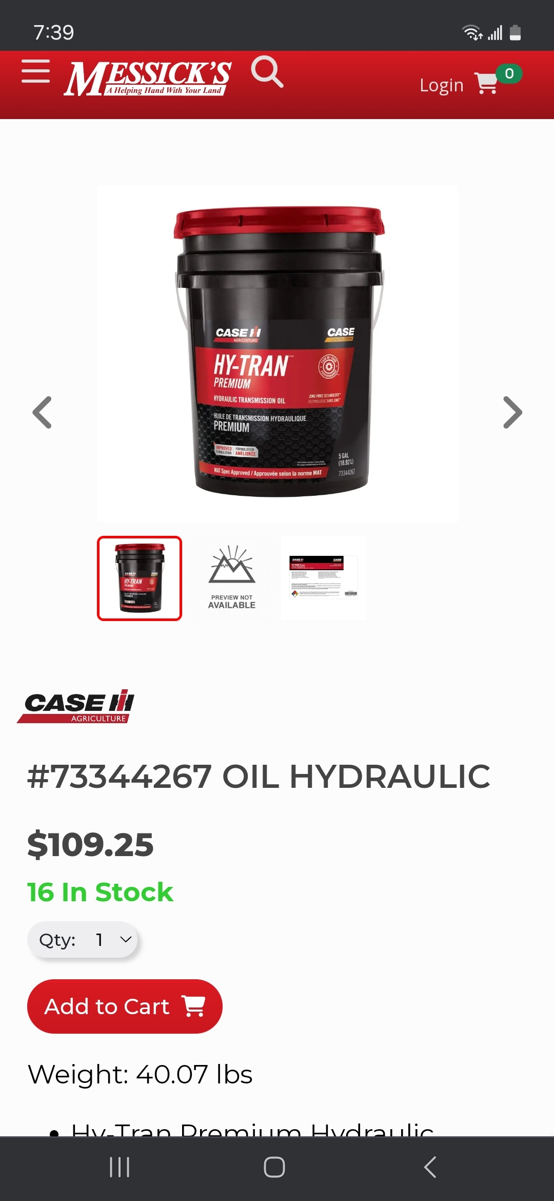

Mastertran Ultaction 73344267 is available

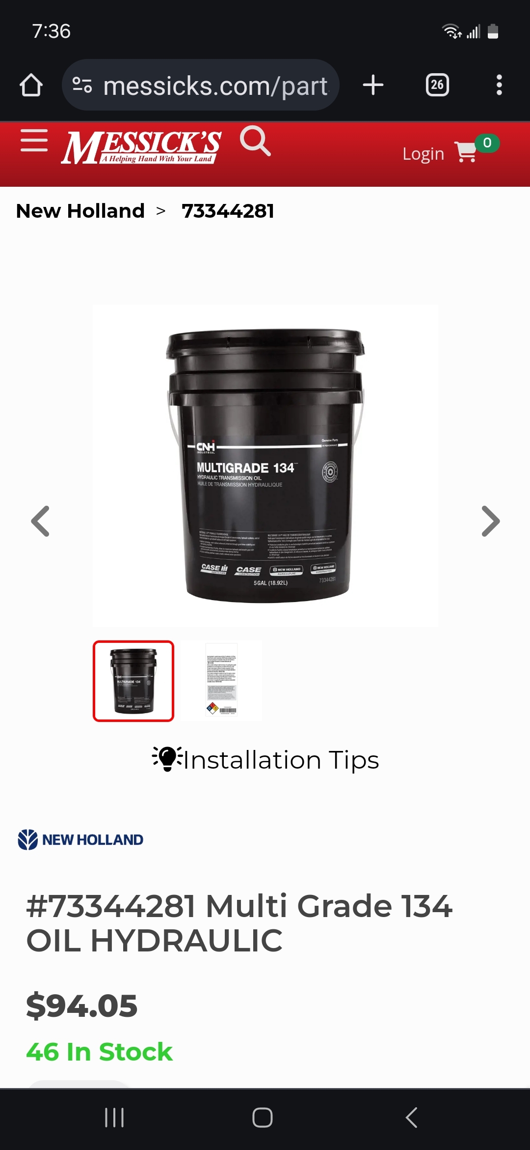

New Holland 134D general hydraulic oil 73344281 should work, but the prior is probably best for hydro.

Messick's price for the non-synthetic.
  • Hydraulic Transmission Oil #73344274 is designed to keep tractor transmissions, axles and hydraulic systems free of deposits while inhibiting wear, corrosion, sludge and foaming.
  • t uses the latest anti-wear, Zinc-free* additives to provide premium performance and protection for all generations of equipment — from legacy to CVTs.
