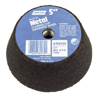

Looks like this?
But diferent thread.
Could you take a 5/8 bolt and drill and tap it to fit your grinder,
making your own custom adaptor.

That's the type, thanks for the picture. As mentioned in my first post, I had tried an adapter, but it was the wrong size. That didn't keepme from mounting one of those full sized wheels however ;)
But, those big cup wheels are too much for the compact grinders. Lot's of mass spinning around.
