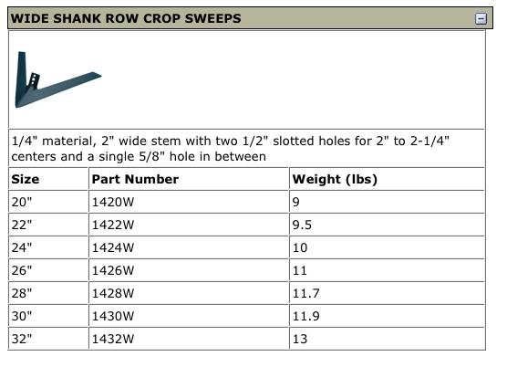

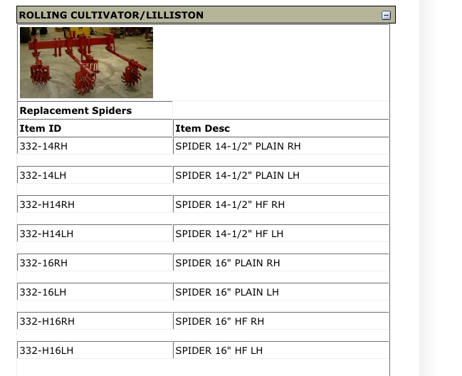

If the rocks are too many or too large for shallow rototilling, take the tiller off (if you have that model) and use sweeps or a rolling cultivator behind the drive unit on a home-built mount.
From:
Wearparts - Row Crop Cultivator/Other Cultivator Sweeps and Accessories
