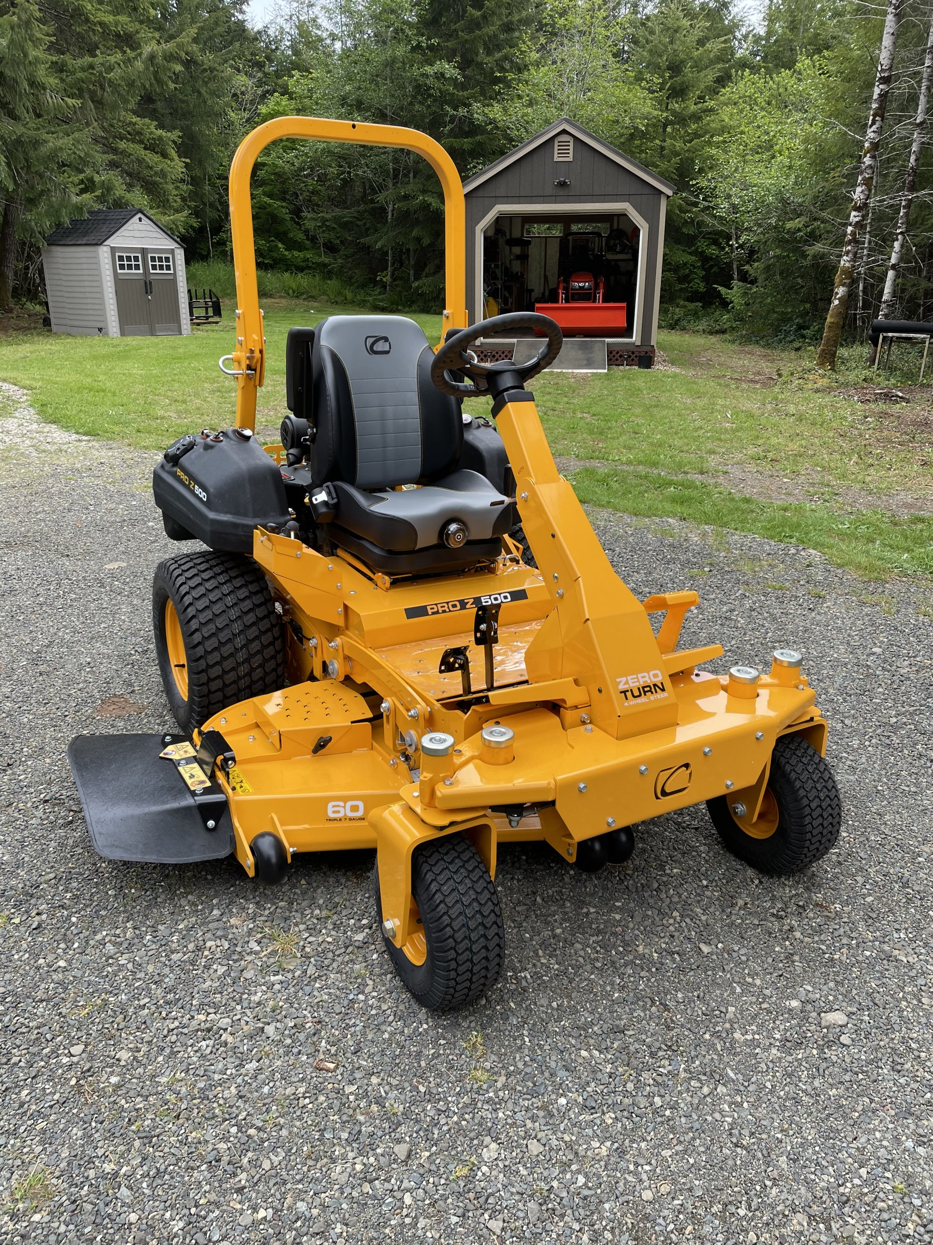

I recently purchased a 2021 Cub Cadet Pro Z 560 S after extensive research and demo’s on my property.
I’m extremely happy with this mower.
MikeView attachment 707169
