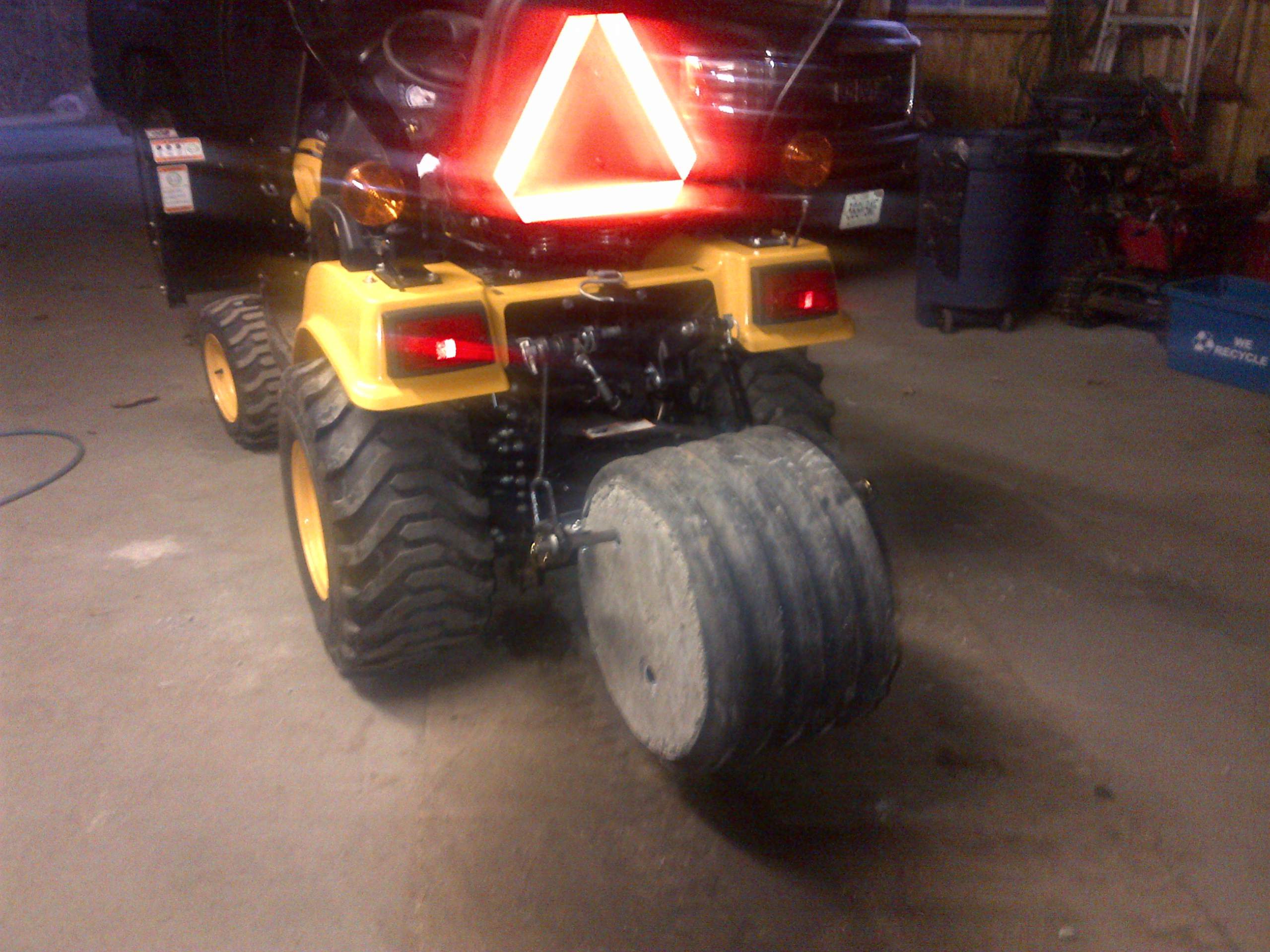

I have the small SC2450. I built a small counter weight using an old piece of culvert and cement. Works well because I can roll it around when not on the tractor. Make sure you put in a piece of pipe while it sets so you can slide a rod through
