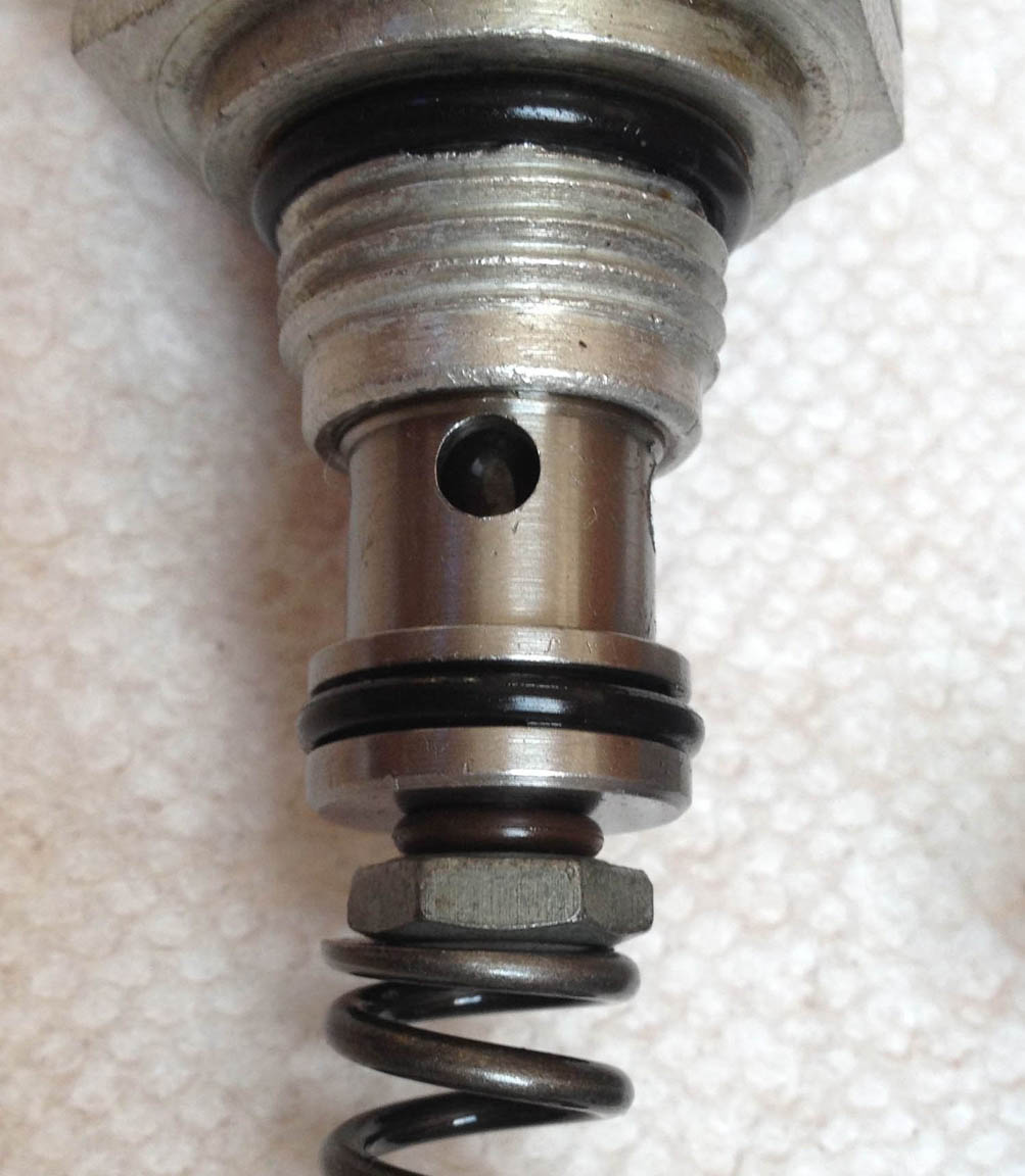

You have drawn the 2 valves with a check in them. The manual lower valve has a seat that would function as a spring-and pressure-activated check. The seat appears to be perfect. I suspect the manual lower valve is rarely used. On the Solenoid valve, I can't see the 'seat', iand it doesn't look like this valve can be disassembled. I will take it apart again and look at these carefully. Are there any pics that I should take? Closeups of the valves?

The solenoid valve probbaly doesn't have a "seat" as it blocks/unblocks holes in the side of the valve rather than pushing on a seat. Its "seat" is the side of the hole that it goes into.

I see…. thanks Aaron. I will look at that. Like a shuttle valve that pressure does not energize? Makes sense then that it could wear out and leak since it's not pressure-energized.

Usually the solenoid can be dismantled IF you have access to collet to grip the nose or cage. Look closely at the connection between the cage and retainer threaded area. Does it look like these are two seperate pieces? The cage in most cases unscrews from the tube assembly. This joint may be loctited. See the attached data sheet on the Delta Power valve. This valve has TWO sealing points. One is the pilot pin to the main poppet and the other is the main poppet to the cage. Both of these are metal to metal seats.
NOTE: A couple of companies may have the tube assembly unscrewing from the retainer or mechanically staked this joint so they cannot be dismantled
If this was a spool valve like azclan described it would always leak some.

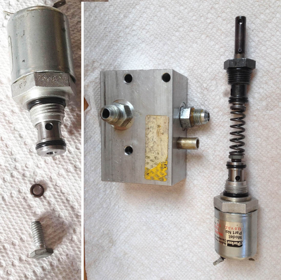

OK I eliminated the solenoid valve. I put a fairly tight-fitting bolt, with an o-ring around it, into the hole. The spring for the manual valve on the other side, pushes against my 'plug bolt' which is also energized by hydraulic pressure. See this in the pictures attached below.
The walkie still creeps down!
So I guess the Solenoid valve is not the problem. The manual valve is a 45deg seat, is pressure energized, and appears to be 'perfect'. I'm pretty sure the hold valve (ball-check) is perfect too. And the return tube from ABOVE the cylinder packing, is DRY. There has been no fluid passing thru it in a long time so I conclude the cyl. packing is 100%.
As if I wasn't stumped before now I'm really stumped. Its like the manifold has a crack or void or something.
