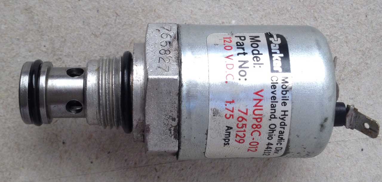

Sodo,
Not exactly sure how the Parker solenoid valve is made but it has at least one sealing surface and possibly two. Since you say the valve is working perfect does that mean it lowers electrically? Parker DS091C D012HP valves are 3/4-16 threads and have .623 diameter nose for sealing in a .625 diameter hole. This is an odd ball cavity so finding a replacement valve may be difficult.
A concern I have with this electrical valve is what is controlling the lower speed when using the electrical. Is there a metering orifice in solenoid valve or some restriction below the valve. The DS09 is rated @ 5 GPM with @ 70 PSI pressure drop so this would allow the mast to free fall which is not good.
If you want to experiment: Remove the solenoid valve and look at the drill diameter below the valve cavity. Is the hole around 3/8 to 7 /16 in Diameter? Is the nose of the cavity reasonably smooth? If yes get a 1/2" diameter steel ball and a #8 SAE fitting. Put the ball in the hole install the fitting and operate the lift. The ball should seal on the nose of the cavity similar to how the check valve ball seals. You may need a soft spring to hold the ball in place.
This would help identify what is leaking.
Ditto what oldnslo said or plumb in a shut off valve on each the lines. Just dont "deadhead" the pump, I dont think that pump has an internal relief.

Sodo,
Regarding the walkie's operation, every button, valve, function works perfect, so I am assuming the solenoid valve is working.
The ONLY problem** with the entire forklift is (with a load) it creeps down an inch every 5 seconds.
A concern I have with this electrical valve is what is controlling the lower speed when using the electrical. Is there a metering orifice in solenoid valve or some restriction below the valve......allow the mast to free fall......
Noted-good call thx for mentioning that. Will look @ circuit & valve for a down flow control before considering a substitute to OEM solenoid valve.
If you want to experiment: Remove the solenoid valve ..........try .... 1/2" diameter steel ball and a #8 SAE fitting ......& spring.......
Great suggestion to isolate the 2 valves, will have a look at that option. Thanks!!

On the Solenoid valve, I can't see the 'seat', iand it doesn't look like this valve can be disassembled. I will take it apart again and look at these carefully. Are there any pics that I should take? Closeups of the valves?
The solenoid valve probbaly doesn't have a "seat" as it blocks/unblocks holes in the side of the valve rather than pushing on a seat. Its "seat" is the side of the hole that it goes into.
SoDo,
Usually the solenoid can be dismantled IF you have access to collet to grip the nose or cage. Look closely at the connection between the cage and retainer threaded area. Does it look like these are two seperate pieces? The cage in most cases unscrews from the tube assembly. This joint may be loctited. See the attached data sheet on the Delta Power valve. This valve has TWO sealing points. One is the pilot pin to the main poppet and the other is the main poppet to the cage. Both of these are metal to metal seats.
NOTE: A couple of companies may have the tube assembly unscrewing from the retainer or mechanically staked this joint so they cannot be dismantled
If this was a spool valve like azclan described it would always leak some.

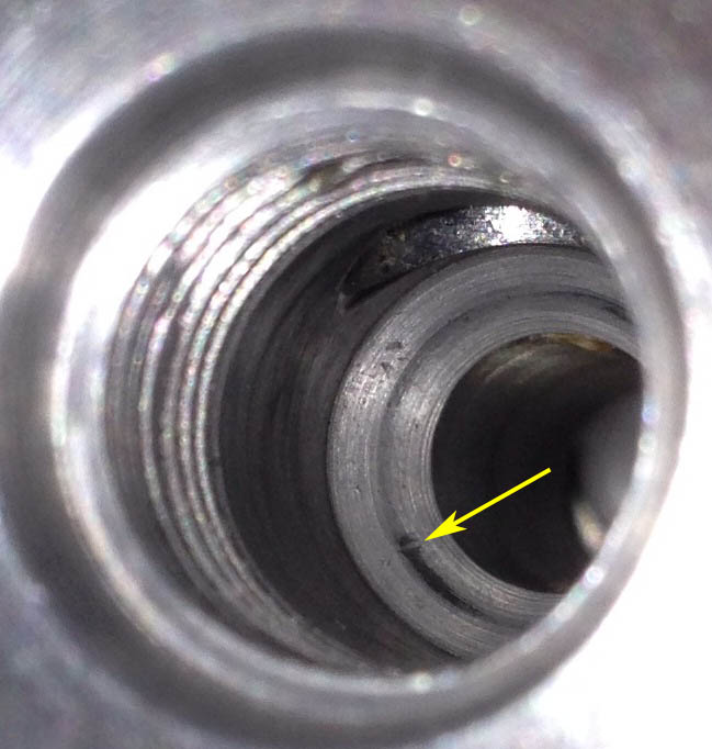

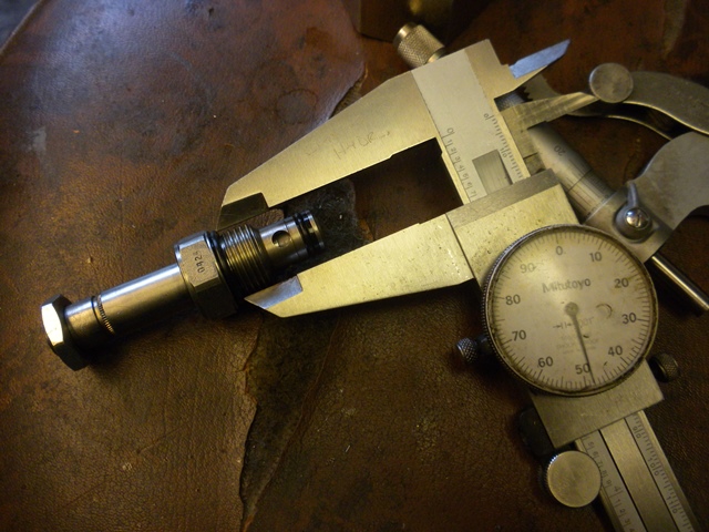

OK I eliminated the solenoid valve. I put a fairly tight-fitting bolt, with an o-ring around it, into the hole. The spring for the manual valve on the other side, pushes against my 'plug bolt' which is also energized by hydraulic pressure. See this in the pictures attached below.
The walkie still creeps down!
So I guess the Solenoid valve is not the problem. The manual valve is a 45deg seat, is pressure energized, and appears to be 'perfect'. I'm pretty sure the hold valve (ball-check) is perfect too. And the return tube from ABOVE the cylinder packing, is DRY. There has been no fluid passing thru it in a long time so I conclude the cyl. packing is 100%.
As if I wasn't stumped before now I'm really stumped. Its like the manifold has a crack or void or something.

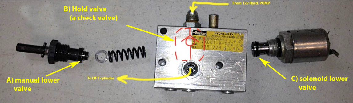

Check valve should be an easy test. Raise the mast and disconnect the supply line from the pump. No oil flow not your problem.
Manual lower and Solenoid are going to be more difficult. On post #10 you showed the manifold and labeled the plugs. Is there any way to put a plug that you can remove below plug "E" to isolate the cylinder port from the solenoid valve? You could use the same plug to isolate the manual lower valve. This would prevent the cylinder pressure from getting to these valves and should eliminate them one at a time.
This is very do-able; I can crack the fitting to the pump. I have NOT done this yet. Such an easy one, thx for mentioning it. I sure wish you guys were here looking over my shoulder.
I tried to remove plugs B,C,E but they are soft aluminum and the tiny hex was clearly not going to turn it. They have a fairly large thread diameter. The steel fittings had threadlocker and came out HARD. Would have to get the torch out and get serious.
But pretty sure my bolt-plug isolates the solenoid valve. It doesn't isolate the (new) o-ring at the nose of the valve though.
Isolating the manual valve maybe can be done the same way if I remove the spindle? Or there may be other ways.

Sodo,
The spring is in the same pressure-cavity as the (very light) spring for the hold valve (a ball-check valve). The bolt head is energized like the ball of the check-valve (not the other way around - i.e. relief valve).
Are you saying the nose of the solenoid valve and manual lower valve are connected to the cylinder port. If yes I have been looking at this backwards.
My thoughts on the circuit where.
Pressure connects to "D".
Cylinder connects to "D" through the check valve.
"B", "C", & "E" connect cylinder to top port of manual valve and solenoid valve.
Nose of manual valve and solenoid connect to tank.
If this is wrong I have been giving you some bad advice.
