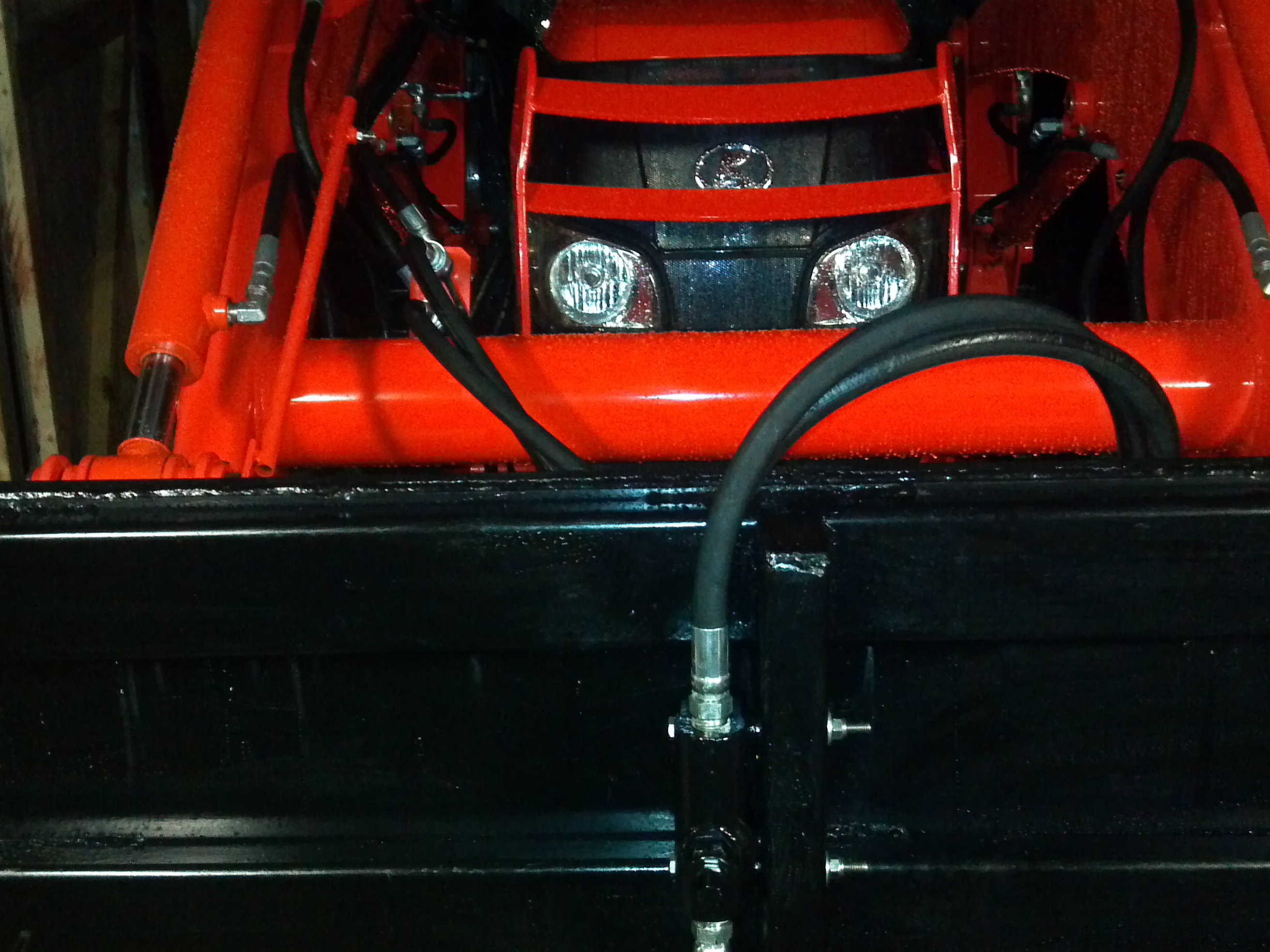

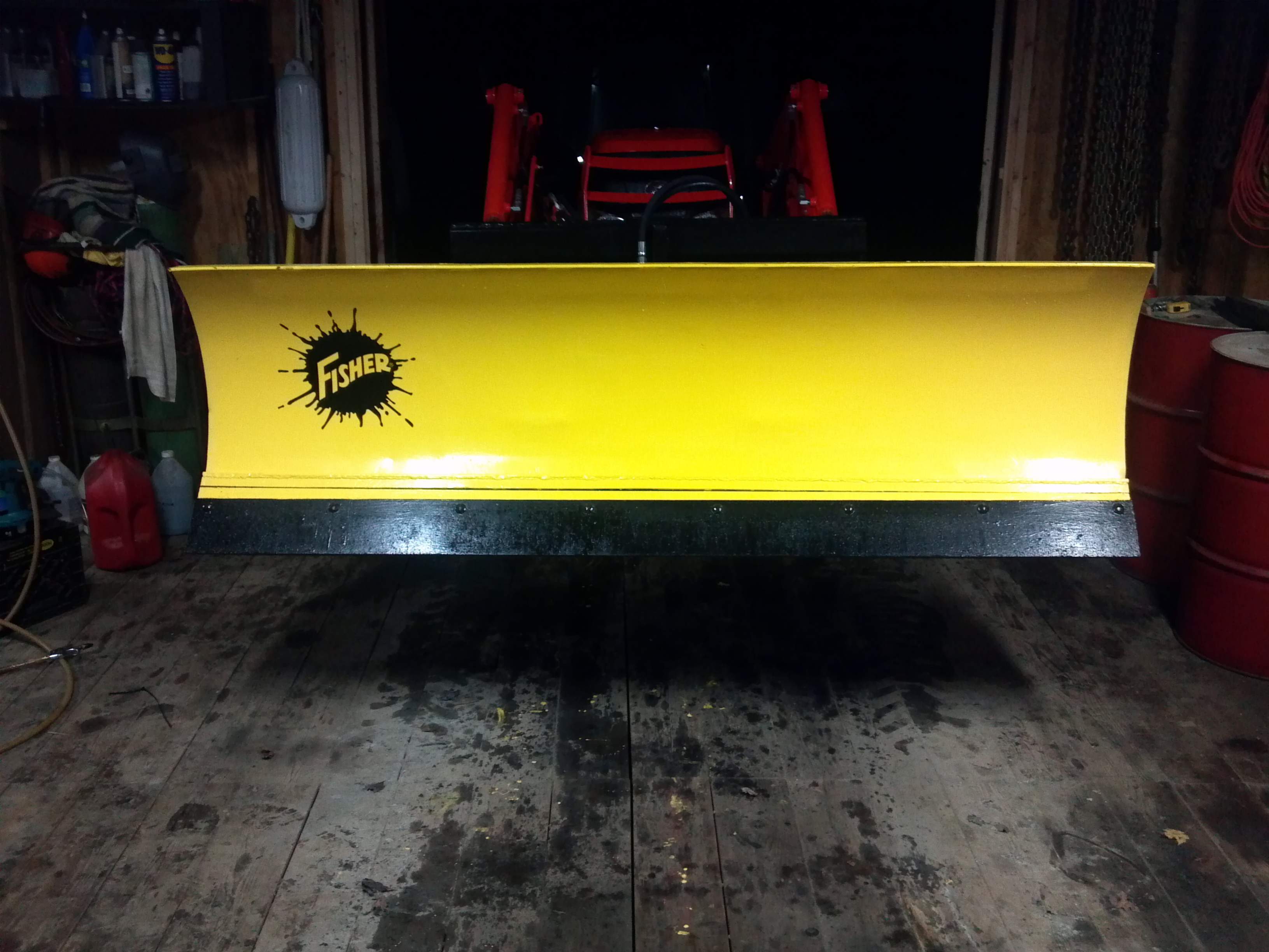

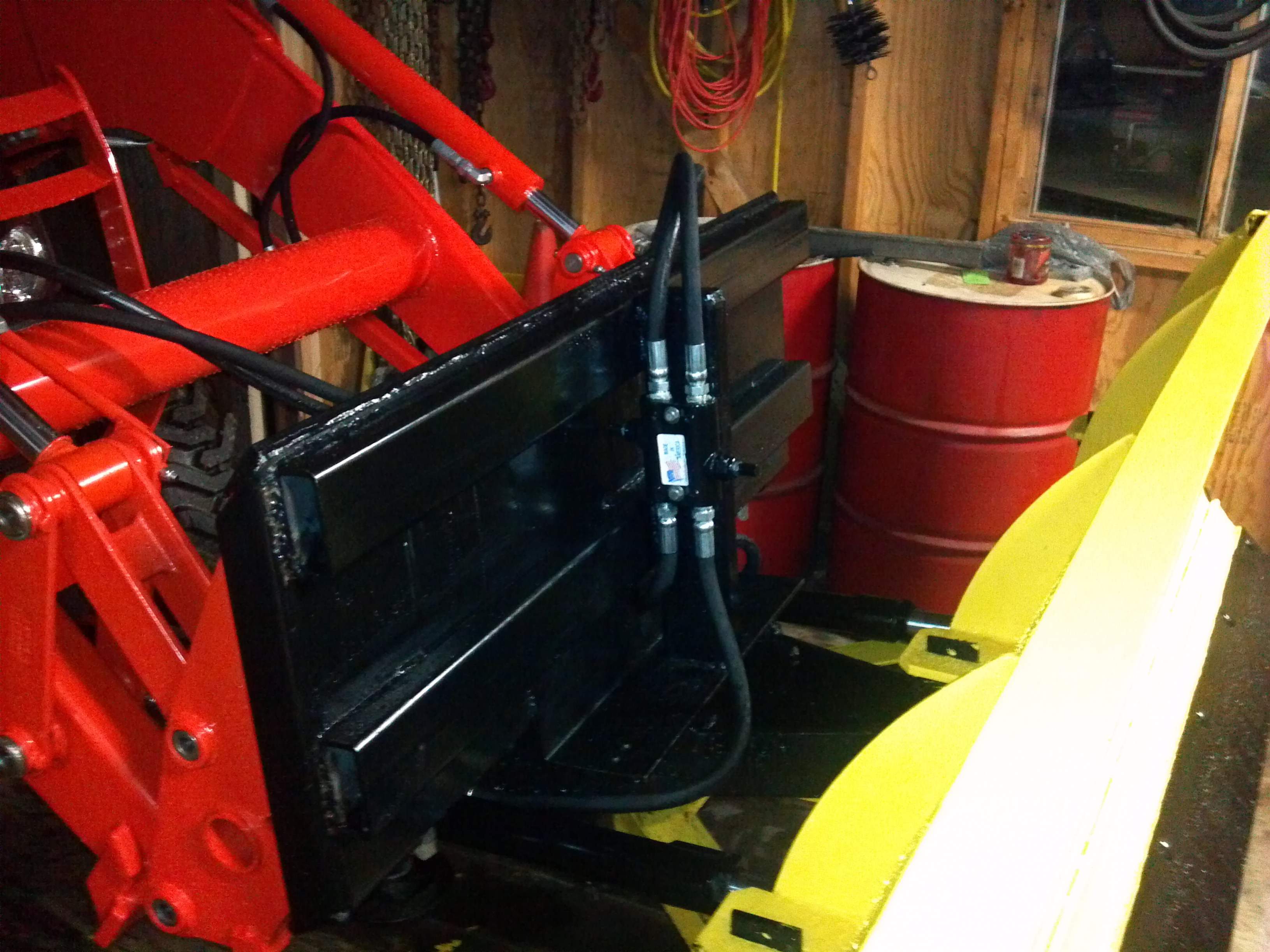

So last night I when I got home I went out to the shop....still scratching my head knowing that the relief valve should work! So I bi-passed the valve and plumbed the hoses directly from the cylinders to the working hydraulic ports serviced from the rear remotes. The result were the same, hydraulic fluid pooring out of the quick connect service ports (WTF).
Come to find out both male ends on the hoses were malfunctioning, what are the chances of that! So I relplcaed the connectors (both pioneer 4010-3P) plumbed in the valve and gave it a whirl. Everything worked as it should!!
If you never try anything nothing ever goes wrong.
The plow started out as a pile of junk that I picked up for $200 included with the plow was a sorts of steel that I scrapped for $70. Attached are some pics of the finished product.
Total cost of the project was $545. (Plow 200, Steel $150, valve $80, hoses and fittings $105, paint and primmer $20 (rustoleum), welding supplies $50, decal $10, salvage of steel ($70).
On the other end of the tractor I put a 78 inch agro trend snow blower with a hydro shoot......Now we need some snow.
