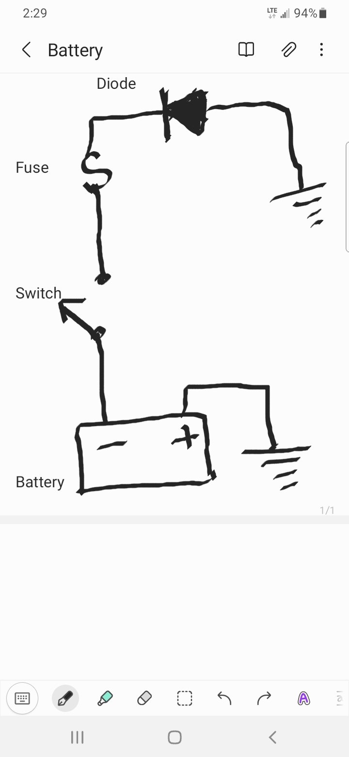

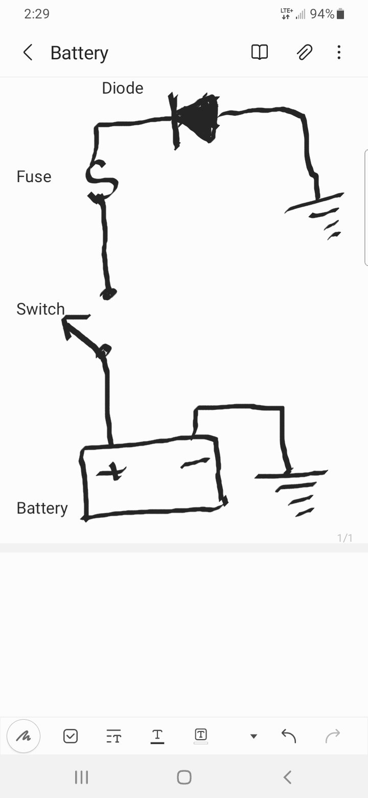

Why would a fuse blow with reversed voltage? Fuses aren’t directional.
   / Crossed cables while trying to jump start. #17
Because of the alternator diode and any other diode or polarity sensitive device in the circuit.
The first drawing, negative ground battery when you close switch nothing happens.
Reverse battery leads, close switch and fuse blows. Diode is forward biased and draws lots of current.
The first negative ground drawing diode that direction current doesn't flow.
