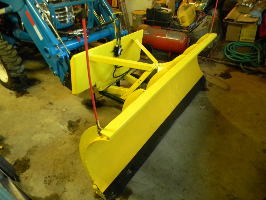

Quick question? I just installed a prince cross over valve on my loader mounted plow. When I was plowing this week end i fetched up on a rock, my trip edge tripped but pretty much stopped the tractor, I was going real slow but the cross over valve did not release trying to figure out do I adjust the two valves in or out for less pressure? I bought the 3500 lb unit and was told it comes preset at 2500 Lbs. not sure if I need to adjust it or not?
any helpful hints would be appreciated.:confused:

I was at full angle I hit the rock at the far outer end of the plow on the leading edge.
I have 2 single acting cylinders.
