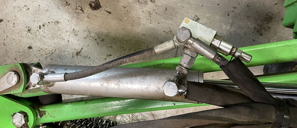

Revisiting this issue....
On the advice of the dealer, I removed the safety valve and connected the lines directly to the cylinder, then tested with my spring mowing (delayed this year).
The results are confusing. It takes me five days (at two hours a day) to mow the field. The issue did not appear the first four days, but then did a couple of times on the last day. It was probably the hardest test, the steepest side-hill where I retract and extend the mower to pass trees. And unlike before, I did get it to extend by bouncing the head up and down a little with the other cylinder. So removing the valve seems help, but not fix the issue.
I see that the geometry of the linkage puts the cylinder at the worst advantage when starting to open, and it requires the cylinder to close, the direction it has the least power. It it possible it requires so much hydraulic pressure when trying to push the head uphill that the tractor relief valve is opening?
Here's the cylinder when the mower is in the closed position, which is where it is when it has trouble opening (the safety valve is installed in this photo):
   / Relief Valve - How to Override? #18
It could be the tractor hydraulics, have you reversed your couplings so the cylinder operated the reverse way as it does when you have issues.
