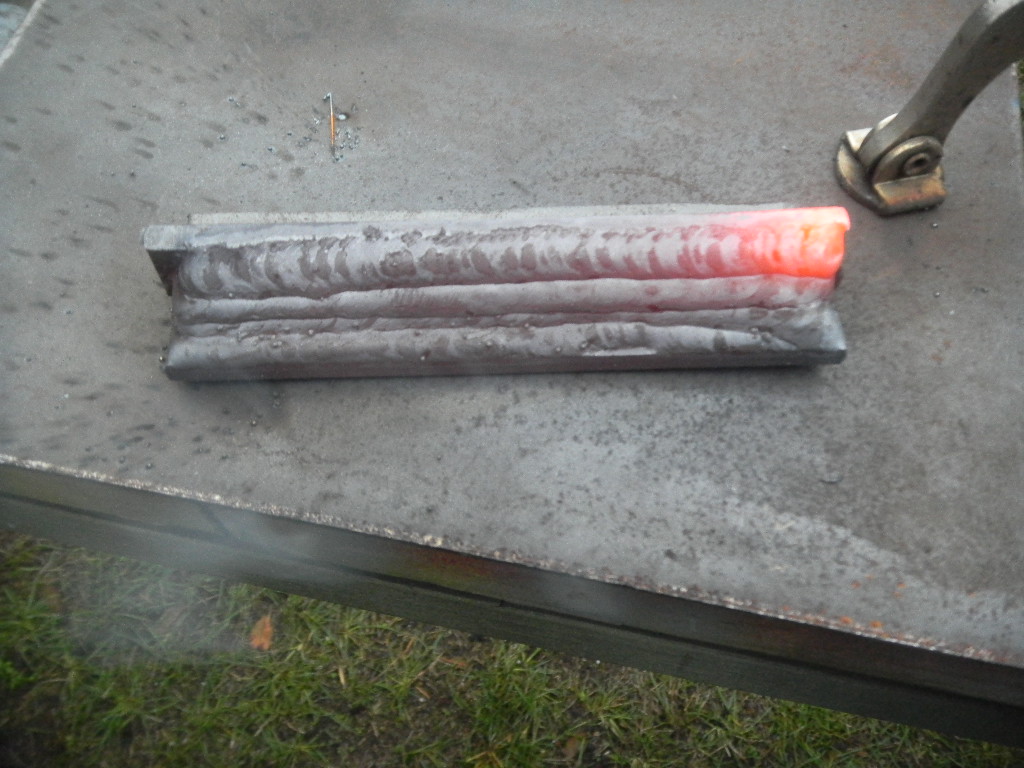

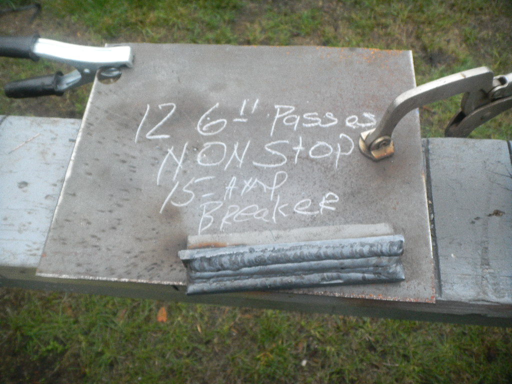

I did an endurance test with an Everlast i140 Mig welder on a 15-amp breaker.

So whos going to run a 6ft bead with a 140v welder?. Just saying
Welds look good. Hows penetration on the first the pass on cold steel.
