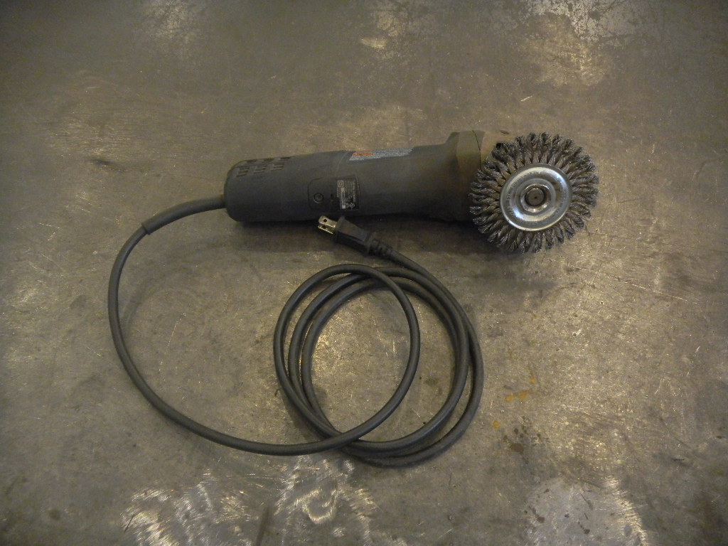

First thing I would do, is get a 4-inch grinder with a cup brush, or inline wire wheel to clean the metal before welding.

I have one, I hit the steel before, I guess I didn't do it wide enough.

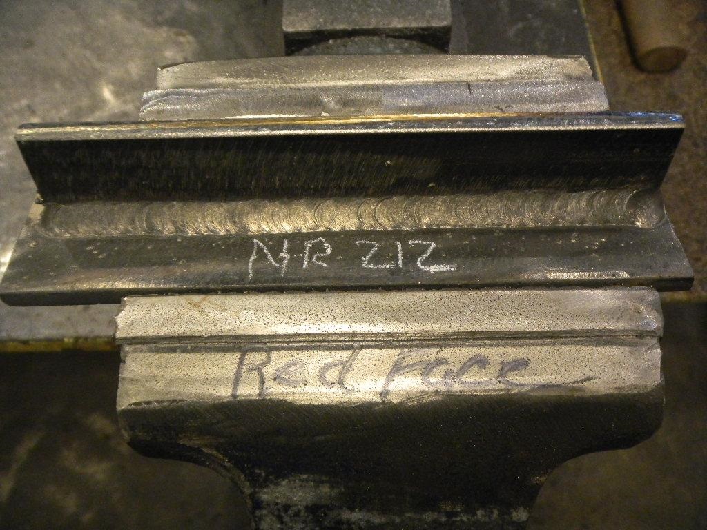

I really like Lincoln's NR-212 self shielded wire.
