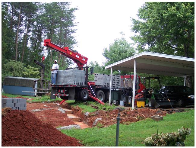

Try again

<font color="red"> PS And I thought we didn't put in-line photos up.
Great pic though</font>

Well, if you're like me and have been putting off cleaning the engine area...looks like your time has come!! Can't seem to download that last attachment though....hope it's a cheap& quick fix!
