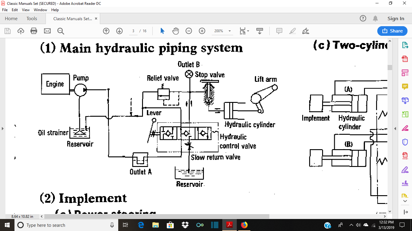

I am convinced that the problem is in the 3 point. It could be a couple things including a leaky relief valve.
The circuit shows the 3 point valve as a 3 position so it has a neutral. This part could be leaky as well.
I think I may take the valve apart and see if there is anything obvious.

All those 3 points leak with age. The shaft in the valve is just a machine fit. As it wears fluid can slip past and "leak" internally. When the machine is on it just adds the ting bit of fluid so you never see you implement drop, but when tractor is shut off that's when you will see it slowly fall down.
I have had mine apart a few times. There are no spare parts to be had for them other than parts tractors and there is no seviceable/wear parts on the inside of them either.

Yeah it looks like I need to pony up for a new valve. While I'm at it I need to replace the loader valve and loader lines.
My plan with this tractor is to haul it over to Montana and clear my property and do the site prep for the buildings. I really need it to be dependable.
/ Creepy loader #32
I'd go with a new loader valve and a new lines. Not so much the lines. Just thinking of a Frontier Loader I'm all to familiar with. And if there is fluid getting past the 3point valve that's not a problem. Esp in Float. All the loader valves should be closed and any fluid to them is stopped and diverted back to the reservoir. When the 3pt. control is in Neutral it won't matter much about the weight on the 3pt. arms it still going to get stopped at the loader controls and diverted to the pump reservoir. The raise and lower of the FEL. bucket are the most used and the most pressure needed. Perfect example is a Cold water setup. Only one Dump Cyl.. It's really hard to diagnose not having it...........
