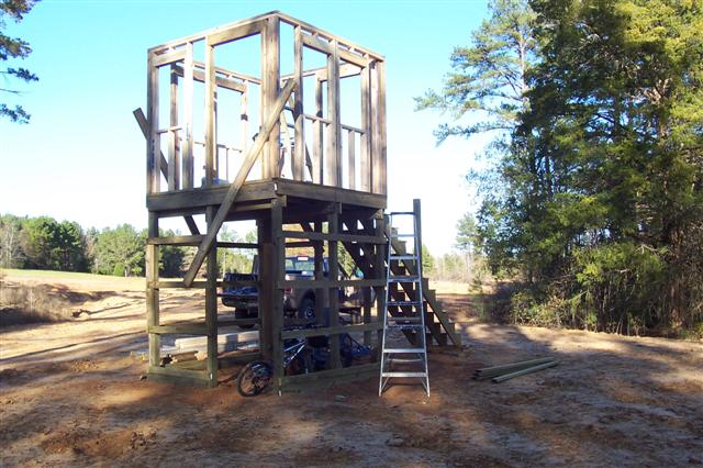

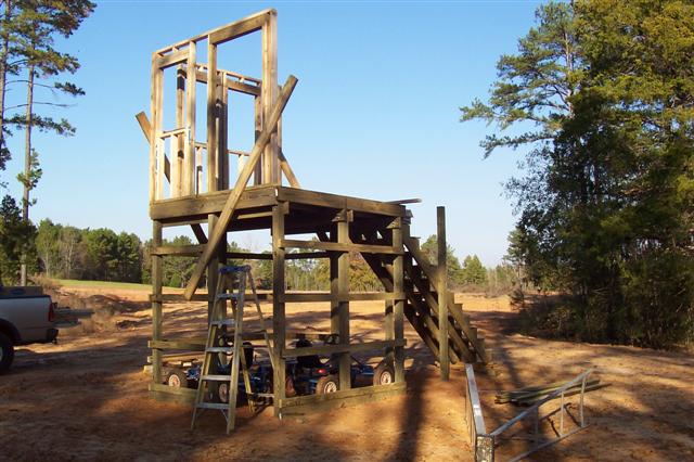

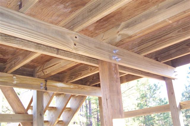

I had a littel time yesterday to get started on the walls, but first I wanted to make sure to get all the carriage bolts in. I knew that if I didn't, it would just be something that kept getting put off. Most of them are 1/2 X 6 inch galvanizid, but the oned down the middle are 8 inches long. I put two on each post except the middle post, that one got three.
Then it was pretty standard framing except I used three inch screws instead of nails. I'm sort of expecting this to get allot of use and over time, being out in the elements, I'm just paranoid about something coming loose. Screws should make sure this doesn't happen. Being somewhat tall and thin, I also worry about movement from a storm, so just another reason to over build!!!!
There are six windows and two doors. One door will be sealed off for now, but easily converted back to a door when I start building the playground.

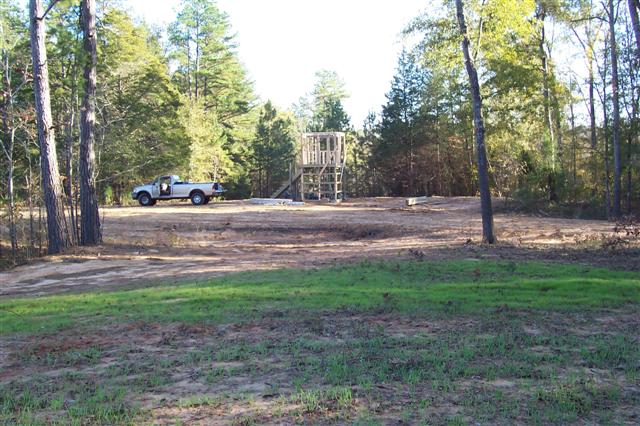

The last picture is from the food plot. You can see the oats, which are what I was standing in while taking the picture, and then the rye grass. All the deer tracks are in the oats.

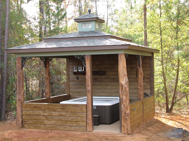

Here's a picture of my gazebo that I built for my hot tub. I'm going to make the roof of the deer blind like this, except for a giant copper weathervane. The siding for the deer blind will also be the same on the top half of the blind. The bottom half will be a board and batton with Hardi that I'll stain like I did on the gazebo.
