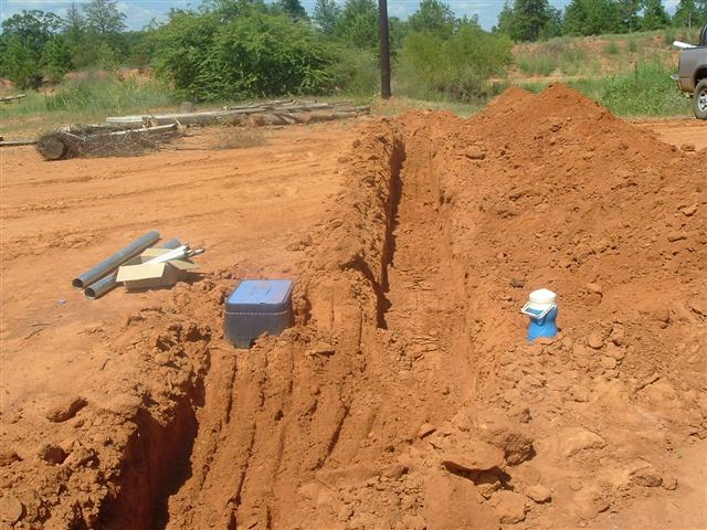

/ Creating a Workshop & Home
#283
While digging the trench, my front tire blew out. I mean it really blew out. I put a tube in it a year ago, and it just exploded, forcing the tire off the rim. It was so powerful that it ruined the bead of the tire and I had to buy a brand new tire. $81 for a tire, $10 to install it and another $4 for a valve. Oh well.
Here's the trench leading to the house. I only need to be a foot down, so it's pretty fast digging.
#284
Here's the water meter. I've only seen them in the ground in a box, so it's interesting to see what one actually looks like.
The water district put the PVC fitting on it out of habbit and mentioned it to me after the fact. I need to replace it with a galvanized nipple for the back flow device.

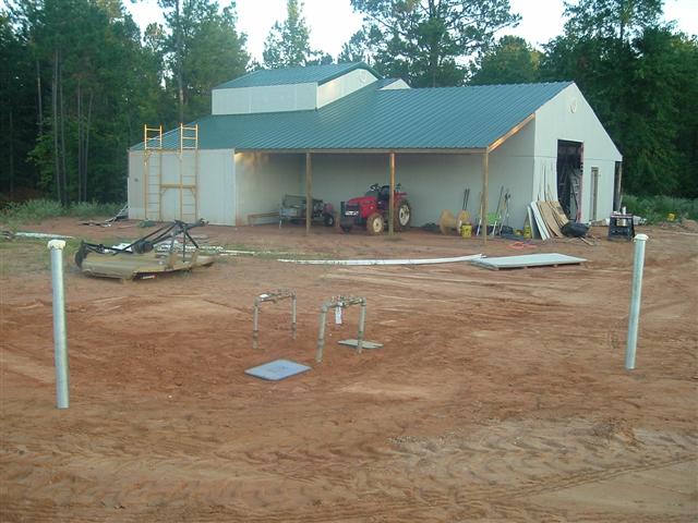

#285
Here's were it gets interesting. I'm familiar with residential construction and single family homes. No real experience with this bigger stuff and commercial applications, so things keep popping up that I didn't expect.
I knew I had to put a backflow device in to illiminate contamination back into the water mains. They do this for every customer. The one they want me to use is called a RPZ and must be installed above ground so it can discharge from teh bottom if there's a problem.
I have no idea how this happens, but understand that they want it installed in a certain way. No problem, tell me what you want and I will do it exactly that way. No thinking on my part. /forums/images/graemlins/grin.gif
The suprise came when I was told I had to have another RPZ for my sprinkler line "AFTER" the first one. Just because it doesn't make sense to me, doesnt' make any difference. If they want it, I'll do it. /forums/images/graemlins/wink.gif
The box on the left is for the meter. Then I went up an 18 inch nipple, a union and then a 12 inche nipple befor bringing it into the first 1 1/2 inch RPZ. I came back out the same way, then transitioned into Sch 40 PVC. I T'd that off down to one inch for the sprinkler line with a brass gate valve. That's int the box on the right.
The 1 1/2 inch PVC line continues to the house while the one inch line goes into another RPZ with the exact size fittings as the first one except one inch. It then crosses the road where it will remain caped until I get back to it.
#287
To make sure somebody really wants to drive into it, I put in two 4 inch poles to help them know when they are getting too close.
I'll paint them bright yellow too. /forums/images/graemlins/grin.gif

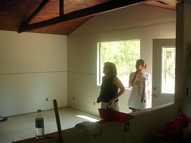

#292
Steph finished staining the ceilings and beams in a Red Oak by Minwax. We're both very pleased with the result and will do it again in our future projects.
This is the family room.
Notice the nice Texas Star on the front door. /forums/images/graemlins/grin.gif

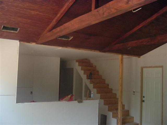

The stairs have all the storage I was able to provide in them. There's many days of work ahead just finishing them off with some of the ideas I have. Nothing simple going on there. /forums/images/graemlins/frown.gif But in the end, I'm hoping for something unique and satisfying.
The door was an afterthought. It leads to the workshop.
During the drawing of the plans, we weren't sure of the exact location of the stairs, and how much space there was going to be.
Another mistake was in the layout we had originally planed for the furniture. My Mom was visiting at the time when the framing was just getting started and suggested we put the big sreen TV on a different wall then the plan called for. DUH!!! It changed everything and really opened up the space.

/ Creating a Workshop & Home #297
Looks great Eddie..........continue fulfilling that dream /forums/images/graemlins/grin.gif

Eddie, I was showing Kathy your progress and she asked me how many bedrooms you will have and where they are located? I know you have the master bedroom upstairs, but I'm not sure of the other(s). I guess I could go back through your posts, but with a dialup, I might be half the day looking for that info. /forums/images/graemlins/blush.gif Can you tell me how many bedrooms and if they are both upstairs?
Things are looking really good. I know you are scrambling to get done by September. It looks like you're gonna make it to at least the livable stage on time. /forums/images/graemlins/cool.gif

As to the floor plan, or layout. The bottom level has the family room, kitchen, master bedroom and a bathroom. We put the bathroom off the hall, so there's no bathroom in the master bedroom. Not enough space.
Upstairs are the kids two bedrooms and the other bathroom.
Total square footage for the home is 1,032. The public bathrooms add another 320 sq ft of heated and cooled space. The workshop and utility room are 784 sq ft for a total of 2,136 sq ft enclosed. There are two covered areas so far, with two more to come. One it 12 ft by 30 ft and is where I'm parking my CUT and storing outdoors stuff, the other is the long 4 ft by 48 foot porch in front of the bathrooms.
In order to squeeze as much into such a small living area, we don't have a dining room or even a place for a table to eat at. I build a long breakfast bar in the wal seperating the kitchen and dining room that will handle three easily, and four if you like each other. We always eat on the sofa anyway.
Storage is under the stairs. The bedrooms will have the beds tight against a corner wall to allow space to get around and every inch will just about be utilized.
