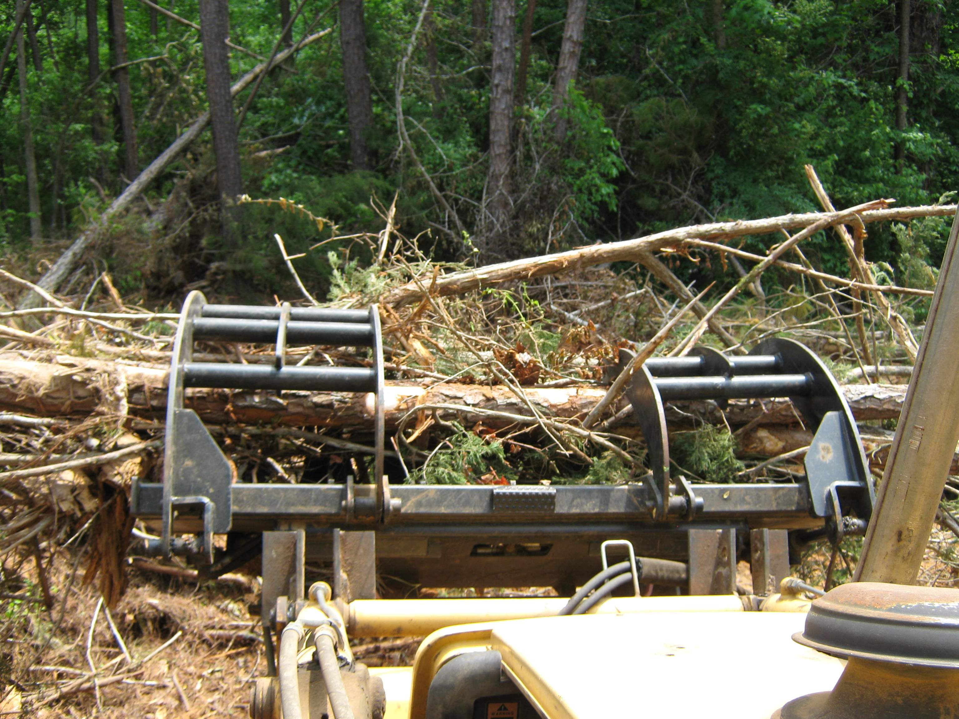

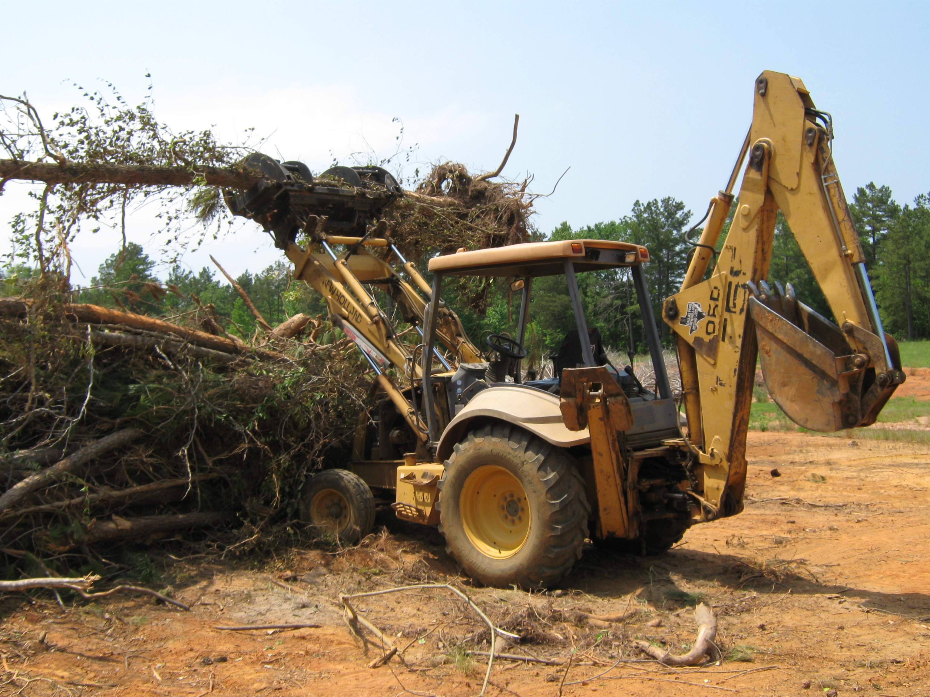

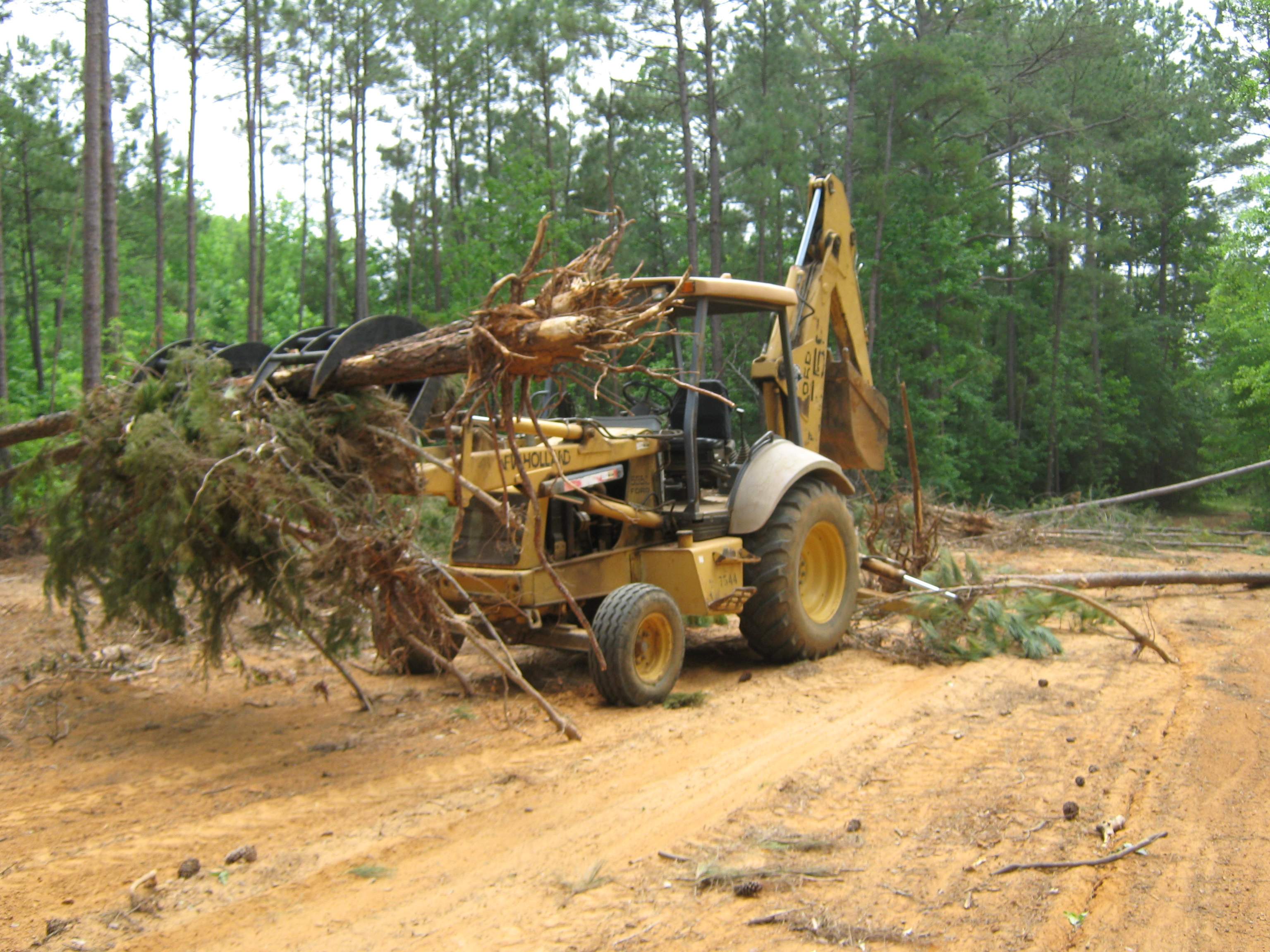

I remember in one of the posts you mentioned you came up with some type of grapple for your FEL. Would you tell me more about it please. I think I remember you said it was not hydraulic?

I tried a few ideas on a home made grapple for my front bucket, but they all failed on me. After wasting so much time and money trying to find a way to save money, I bought a hydraulic grapple long after finishing the tree removal part of creating Lake Marabou. In hindsite, I really could have saved all sorts of time and energy if I had the grapple then. It would have resulted in less dirt in my burn pile, cleaner burns and of course, less effort from getting off the backhoe, wraping the chain around the tree, draging the tree, unhooking the chain and then pushing/lifting it onto the burn pile.
Here's a few pics of the grapple that I have.
Eddie

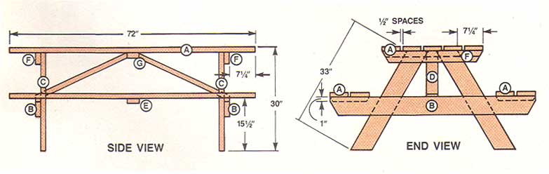

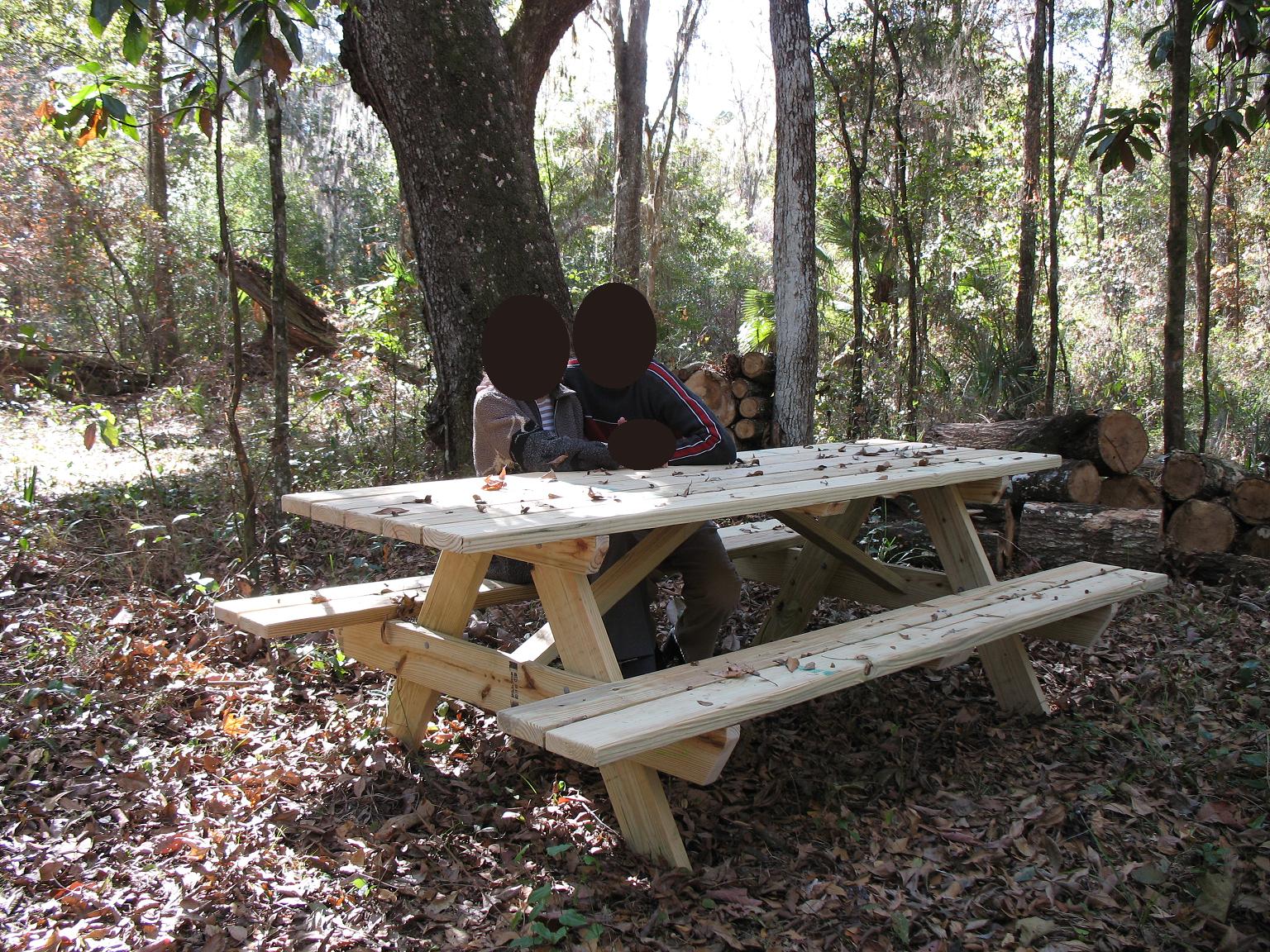

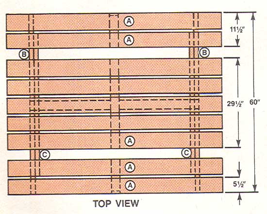

I recently built a wood picnic table from a nice plan I found online that makes efficient use of the boards you buy.
The cost of materials was ~$93 total. However, I found that for about $9 more I could extend it from 6' long to 8' long. (9.7% more money for 33% more picnic table :D)
It was an easy & satisfying project that only took one eve to make. I think if you were to make 4 or 5 (or more) of them, you could make them all in less than a weekend.
Un-stained to date, but that's coming (oh, we prefer to remain anonymous :))

That's a really nice table, and I like how detailed the plans are. I saw some wooden tables similar to yours at Lowes that were already done for under $100, but doubt they are as well put together as yours. My concern with wood is two fold. They tend to wobble after a few years, and I need to be moving it around all the time because it will be sitting on my dam. To mow, I plan to just drive into it, and push it to an area that I've already mowed, then mow where it was. Then the next time I mow, push it back to where it was, and keep doing this every time I mow. Getting off the mower, or tractor to do this goes against my desire to be lazy and not have to get off the seat.
I still might build some wooden ones later on, and appreicate this plan to make it easier. Its such a classic look that if I had a place to put them where they were not needed to be shoved around once a week, I think they would last for a very long time.
